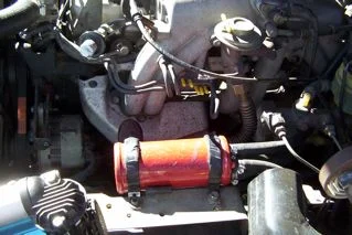

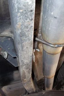

De-smoged FJ62; Here are some pics of my custom exhaust, no cats, and pipes tucked up under frame. Muffler shop cutoff downpipes about two inches from exhuast maniflold and was able to join both into a 2to1 setup, 2.5" pipe, going to a high flow muffler, all nicely tucked in out of harm. Tube from vacuum lines now looped back. Still am making EGR block off plate, and pull EGR crap.
Thanks for the pictures! On the exhuast;when I ask mark w. from Alaska, he said he's running this way with no problems, that was the clincher for me, plus the muffler guy agreed as well. It breathes so good now, sounds amazing after running stock on every other cruiser I have owned. Very glad I did it!

;) Yea I will know next time. The reasoning I was told was the cats also act as a baffle, anotherwards the create a back pressure so the 02s can read.
