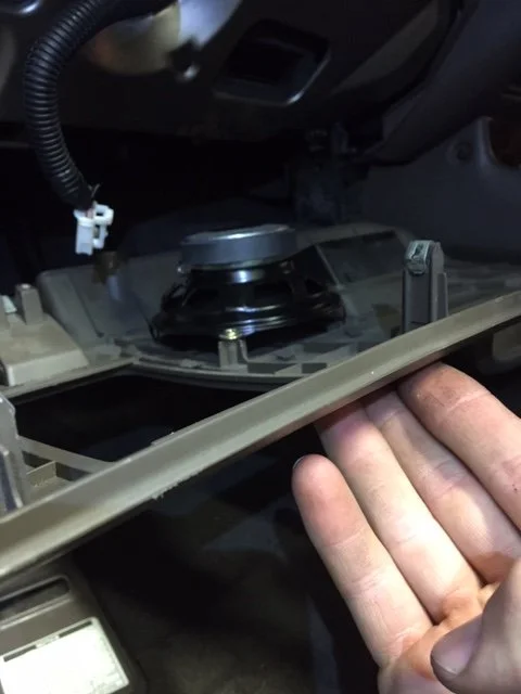

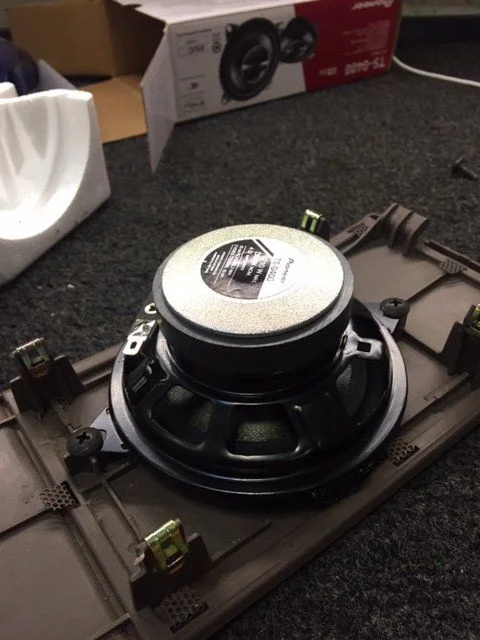

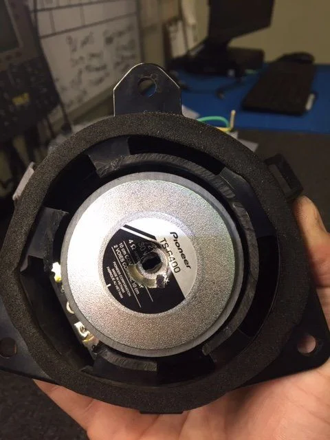

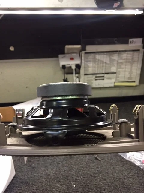

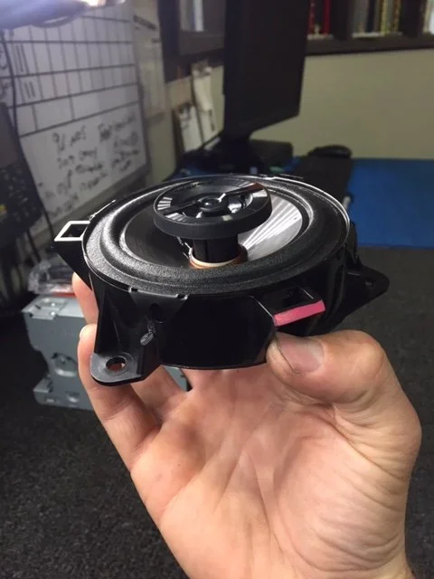

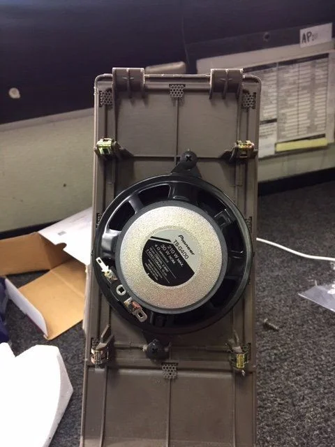

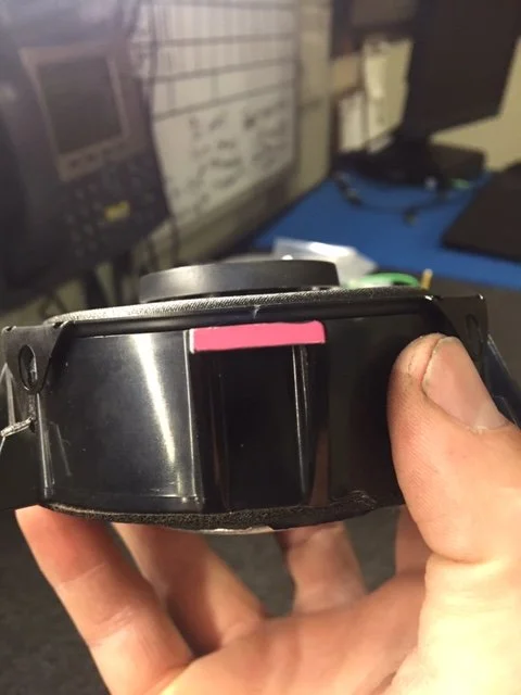

I found a set of 4" Pioneer speakers that bolt directly into the dash, without modification. I am not sure if these are the same speakers which other folks have posted about in prior speaker install threads, but I am posting anyway, because of the ease of installation, as compared to the challenges we had w/ installing a pair of 6.5" Infinity slim mount speakers in the front doors (more on this later).
Pioneer G-Series TS-G400 4" 2-Way Car speakers w/ IMPP Composite Cones
I had the same speakers installed in my rear doors with minimal mods and we were able to reuse the factory speaker covers. More on the rear door install after I have a chance to take some photos, but for now, here are the photos of the new Pioneers going into the dash. A link to the Pioneer speakers at Best Buy is below. I was able to grab them on sale for $39 a pair (normally they are $49). They are currently $34 a pair at Best Buy. Note - they do not come with speaker grills / covers.

Here are a few more photos...

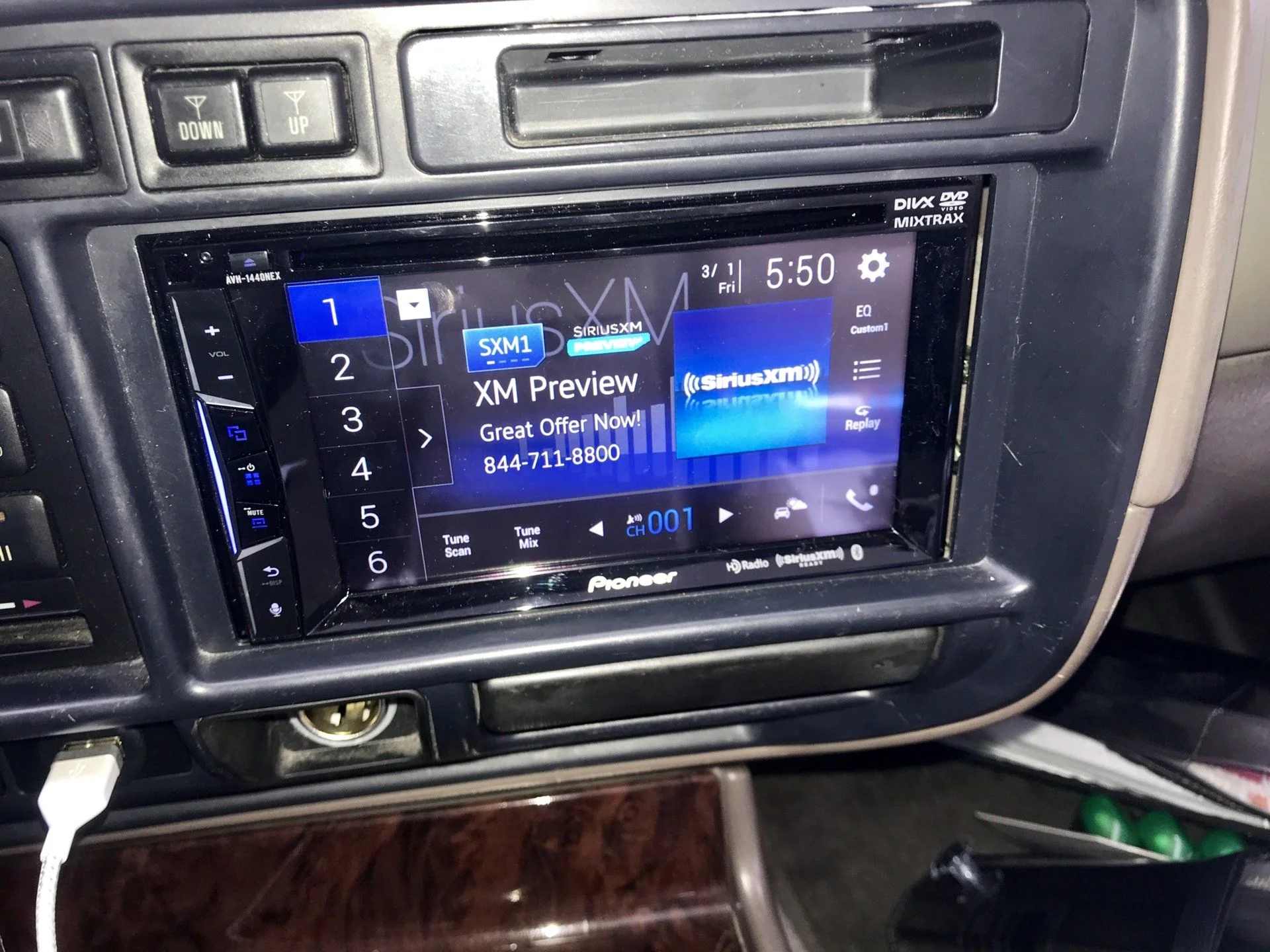

Here is my current set up + a few additional photos:

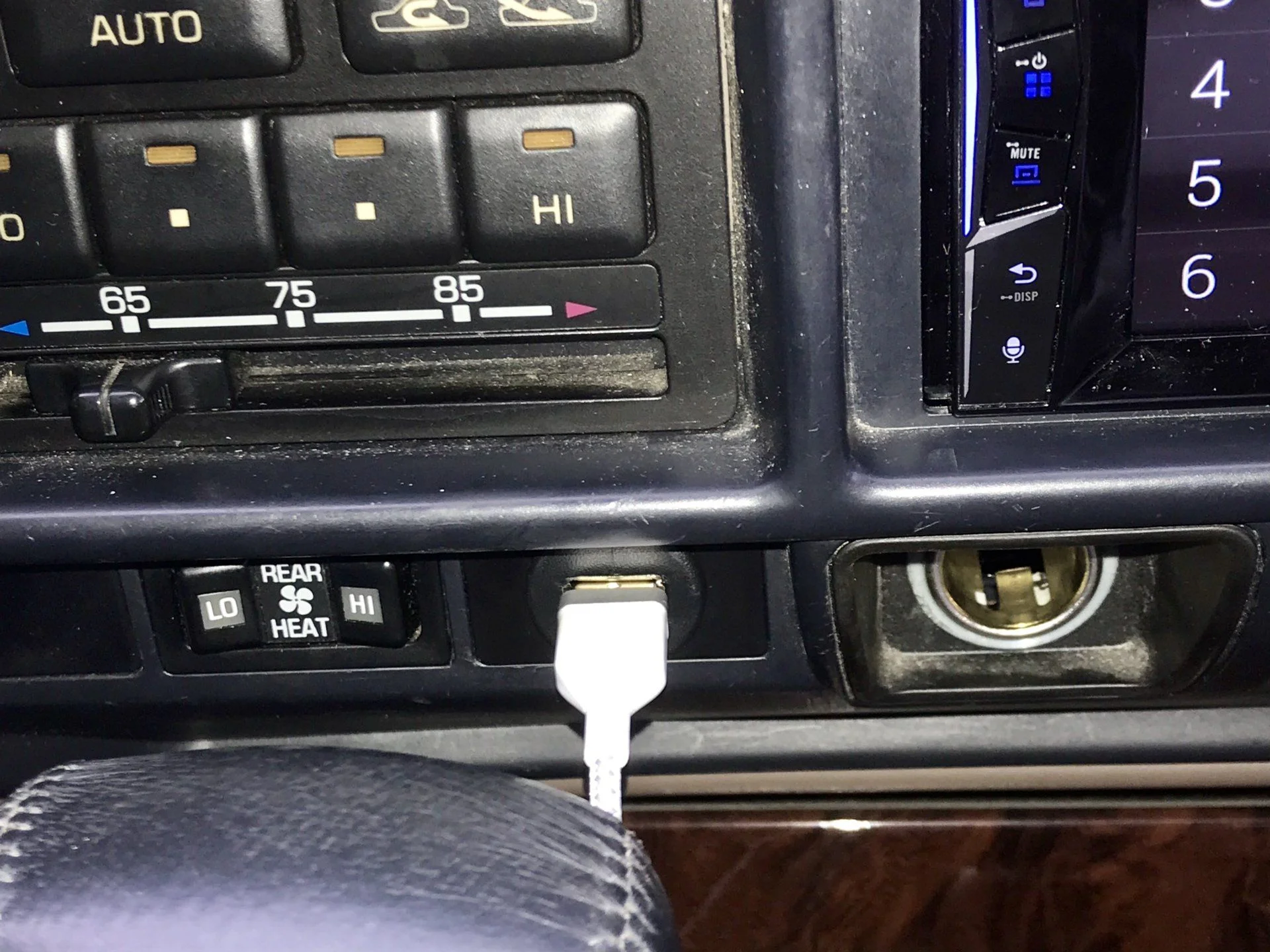

Pioneer AVH-1440NEX double din 6.2" touchscreen w/ Apple Car Play & Bluetooth. This fits ("almost") perfectly in place of the OEM stereo - I had to buy two wiring mounts - one for the stereo and another to control the antenna. Here is a link to the head unit on Amazon:

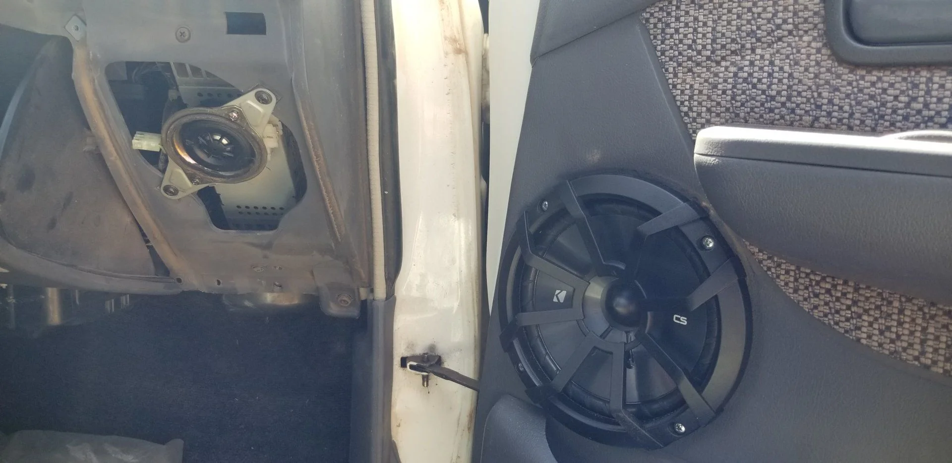

I just redid the stereo on my 91. I used kicker component speakers(css67), they fit the front door perfect and I was able to install the tweeters in the factory dash locations, I had to remove the speakers from the dash and cut them apart and installed the tweeters in the old speaker housings. On the 91 - 93 models the back door holds smaller speakers. I used a set of db drive 4 inch speakers in the rear door. Again I removed the factory speaker from the oem speaker mount and was able to install the new ones into the oem holes and retain the oem grill. Sorry but I don't have a picture of the back door.
