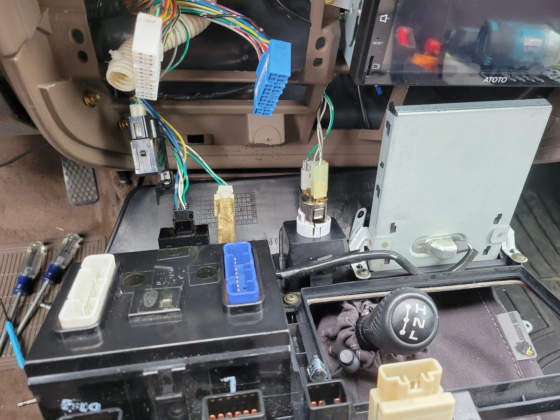

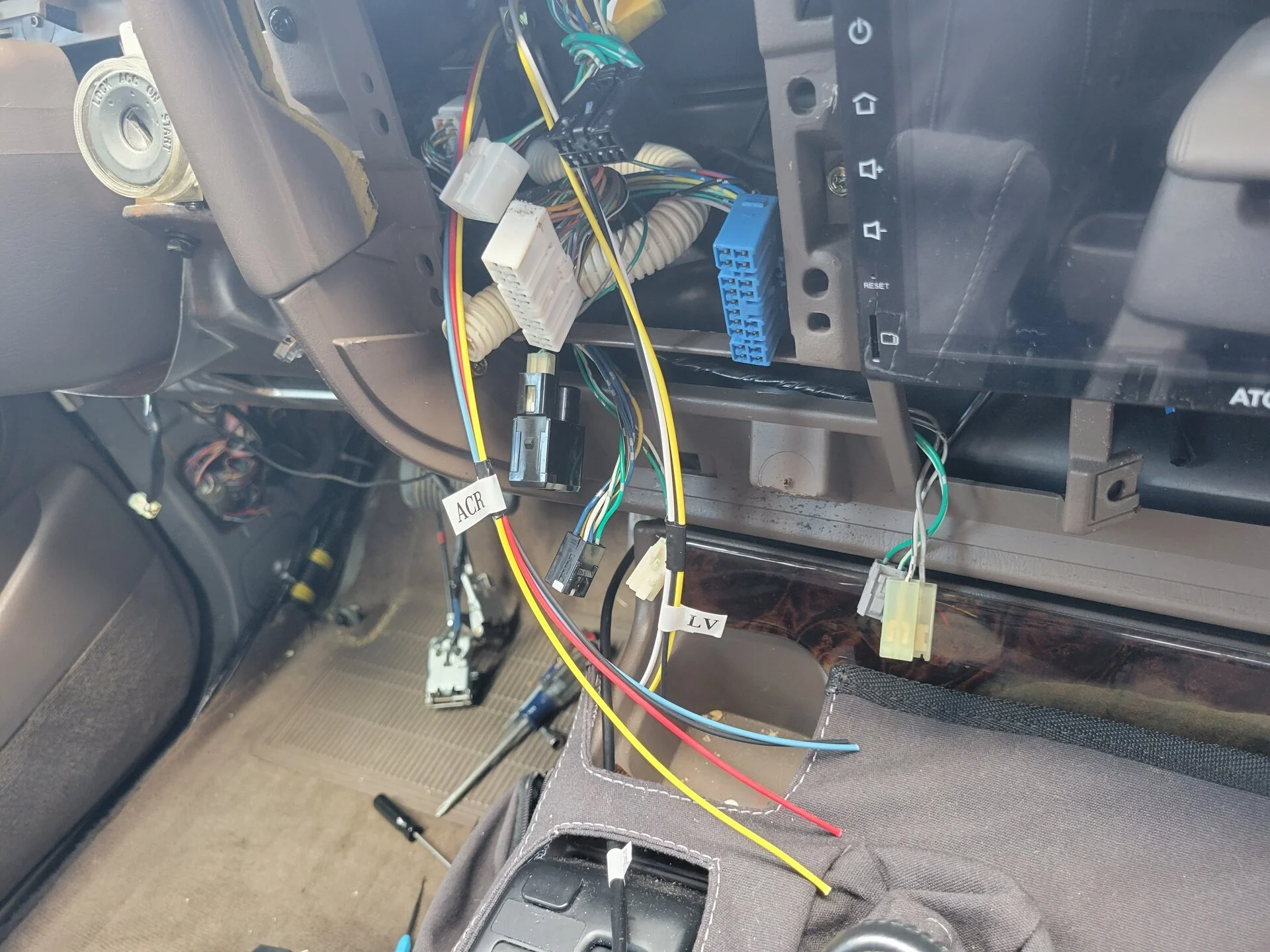

The heater control system screws in from the back to the dash trim pieces so more or less the whole dash has to be taken apart. Once the heater control module is out you can replace the lights.
Its not difficult, couple of screws, couple of clips.
Trying to remember the sequence and location of clips but is pretty easy to access.
