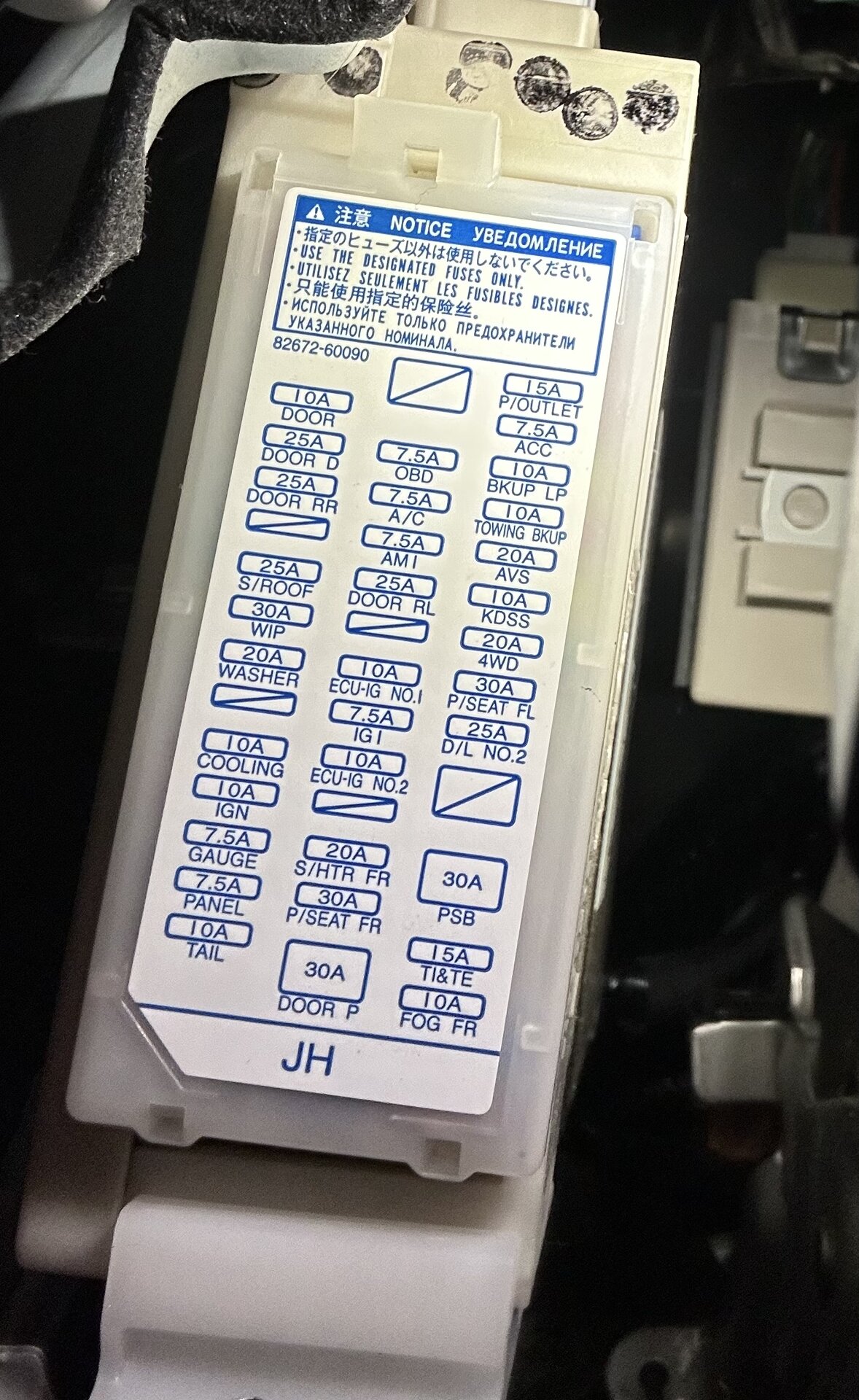

Does anyone know offhand which circuit is good to tap for dash lights? I’m installing an e-locker dash switch and would like to have it illuminated at night like the factory switches.
I’m guessing “gauge” or “panel” but thought I would see if someone has already been down this road.

Run it off the circuit that is tied to the 12V power port in the console (P/OUTLET 15A I believe). I'm probably going to do that when I install footwell lights. Or I might try and find a set of male and female connectors and run the power right off of an existing lighted switch without interfering with that existing switches function.

I tapped the ACC fuse for power (I would have used OUTLET as suggested but the add-a-circuit specified 10 amps or less, and OUTLET is 15 amps), and the PANEL fuse for switch illumination.

Mostly as per that 4Runner post I wired the CH4x4 switch to the generic wiring harness (for my bumper light bar) as follows: green to white, red 1 to blue, red 2 to the PANEL fuse (which provides switch illumination when the dash lights are on), and black to black.
Regarding switch illumination, the CH4x4 switches are non-dimmable, if that matters to people. If you find the switches are too bright at night (we'll see but I think they will be fine), all you can really do is disconnect red 2. The upper part of the switches will still light up when engaged.
The CH4x4 switch was wired to the Eaton e-locker wiring harness as follows: green to ACC fuse, red 1 to relay (red/yellow wire on the Eaton harness), red 2 to PANEL fuse, black to a handy ground point.
