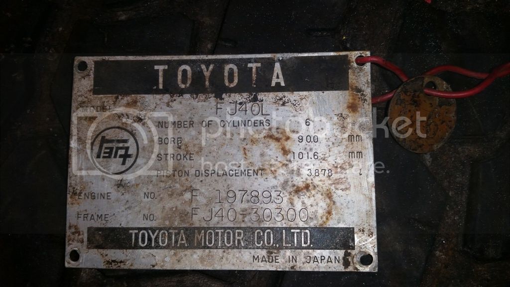

As far as the color, I really have no idea. Here is a picture of the early grill where some of the paint has been stripped. And also the frame stamp. I think the stamp means it was built in september of 63?

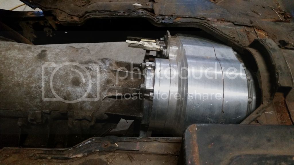

I originally wanted to run a th350 but unfortunately the stak 3 speed transfer case that i have is a 32 spline input. Stak is out of buisness and i cant seem to source a new input anywhere. I also struck out trying to find a 32 spline output for the th350. I would like to keep it auto so i believe that my options are between the th400 and 4l80e. This picture shows where i think the transfer case will land. (ill be doing a little tunnel work)

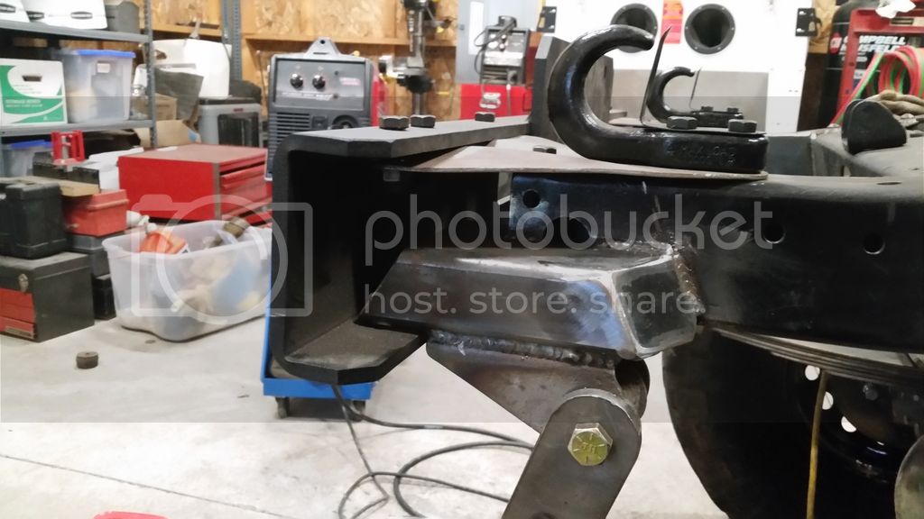

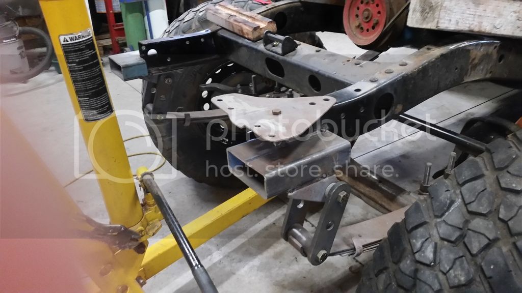

Today i was able to get a little done on the bumper mounts, front frame box and shackle hangers. Here is what i started with.
Cut the fronts at an angle so that i can reach the bottom bolts for the bumper. and im going to reuse the stock upper brackets.
Boxed the front frame section and welded the front cross-member solid. I left a hole in the top so i can still use the factory style tow hooks. i also left the front of the frame open so that i can get to that front bolt.
I cut and angled the back of the 2x6 tube and boxed it for looks/strength.

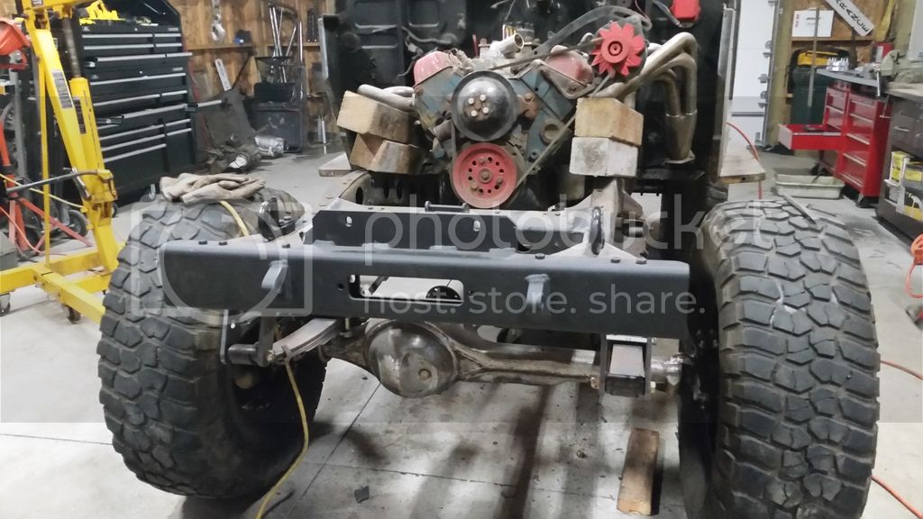

Bumper is the Hell For Stout bumper. Looks pretty good. Now i just need to find a cheap 8274 to fix up.
unfortunately the bottom of my bracket isnt quite wide enough to use both bolt holes in the bumper. One for sure will fit, but the more the better when were talking about the winch mount. Ill figure something out. May have to drill another hole in the bumper.
That's just the frame number. 40 series frame numbers began with the year of manufacture until 1964, then they began with the model designation in 1965. 1-FJ40-1234 = 1961 model; FJ40-44639 = 1965 onwards. It wasn't until the late 70' that the frame numbers had six digits.
Thats good to know. How does one figure out what year the truck is? Growing up i was told 68 but the title says 64. Are there vin plates? It may be hiding in the bottom of a box somewhere.
Not sure. We didn't get VIN's until the seventies - but y'all could be different. It could be a late '64 truck, but to my knowledge it would begin with 4-FJ-xxxxx. Others may chime in.
Plus a 1964 would have a corrugated top.
This thread is helpful for that...
Looks like yours is a 66 according to that page.
Oh, and very cool sentimental build.
Thanks for the support and information. I hadnt stumbled on that registry yet. Your right ooks like the frame is a 66. Now i just have to figure out what year the tub is.
Not that it matters whatever the title wants to call it im ok with. :hillbilly:
If anyone asks you what year... just tell them it's "timeless".
5/66

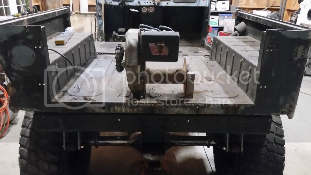

And also in other news after work today i went for a little drive and picked up an old 8274 for a reasonable price. Took it apart for inspection and re assembled. looks to be in decent shape. the gear on the brake was on backwards tho... :doh: I havent decided if im going to rebuild/uprade it or just clean it, paint it, and throw some 3/8 synthetic on it. Upgrades would be really nice but its money on something thats not a fj40 vital organ.
