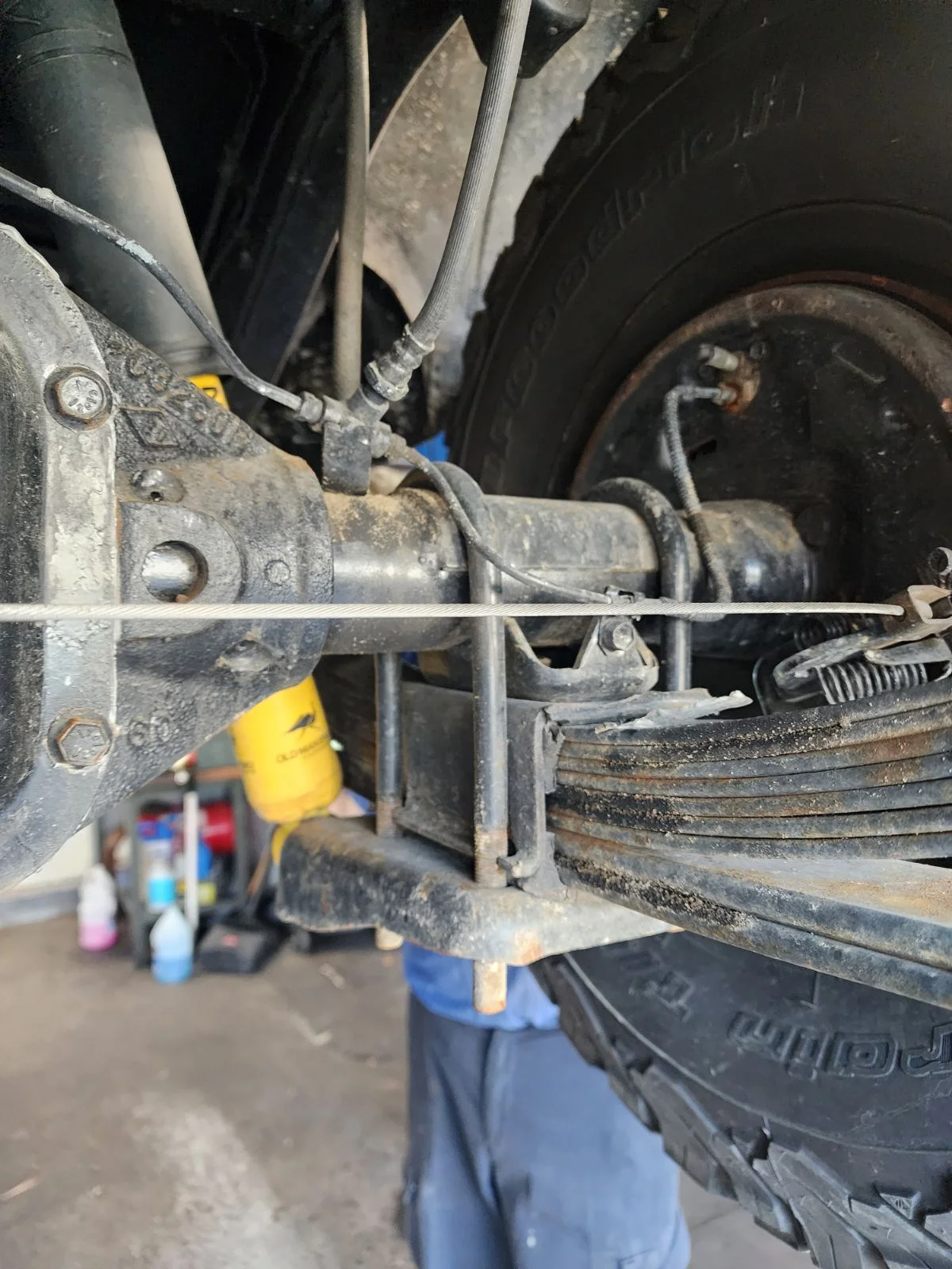

Either way, here's my question... 60 series with a Dana 60 rear end. Has Toyota wheels, so the otters are all toyota. Owner (my sister who lives on the other side of the country), wants to do a rear disc brake swap. Any info on how to make that work with the D60 and yota parts together?

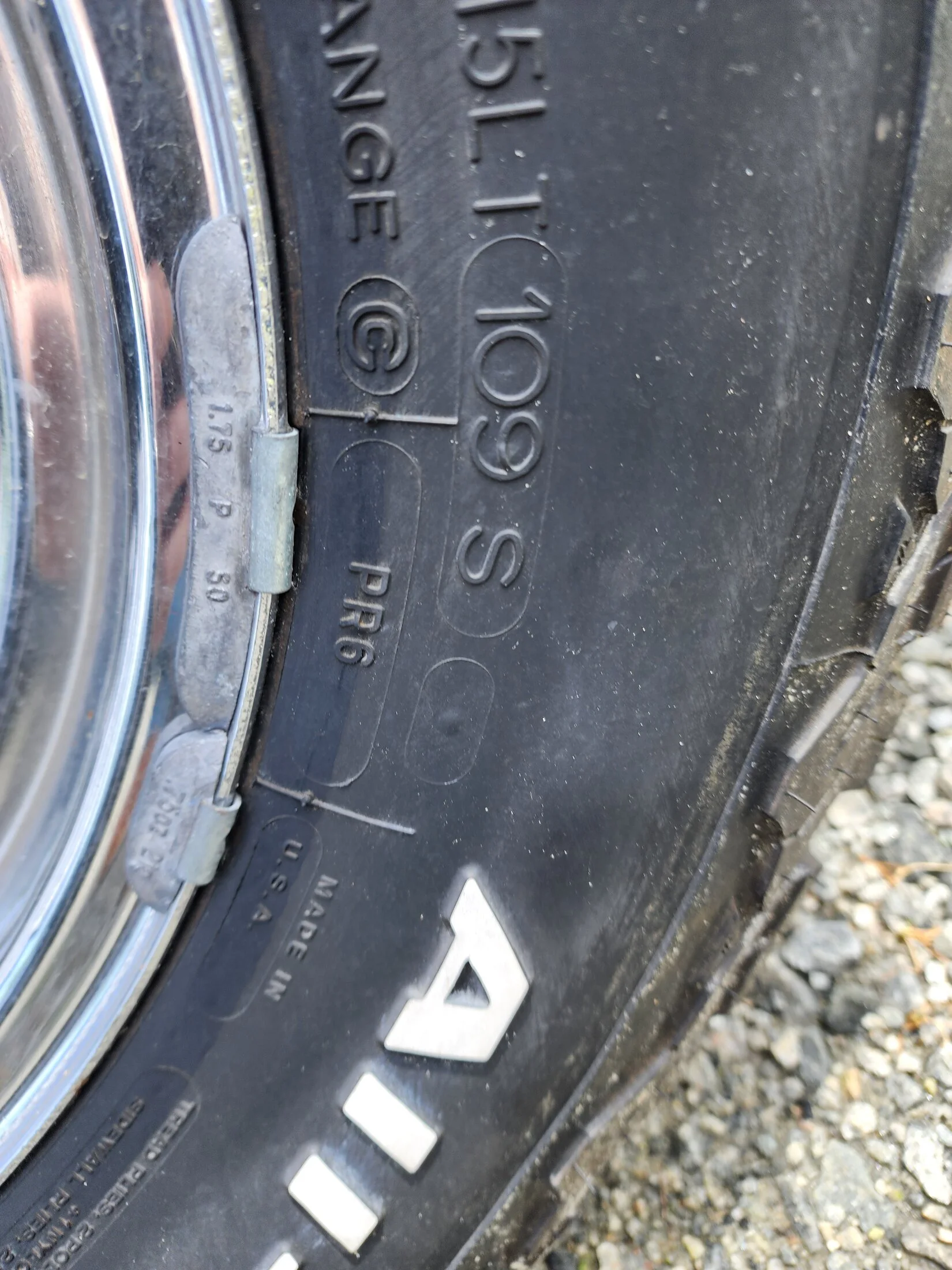

What size are the tires? Have you already made sure the original system is working properly? It has quality rotors, pads, calipers, master cylinder and all new hoses?

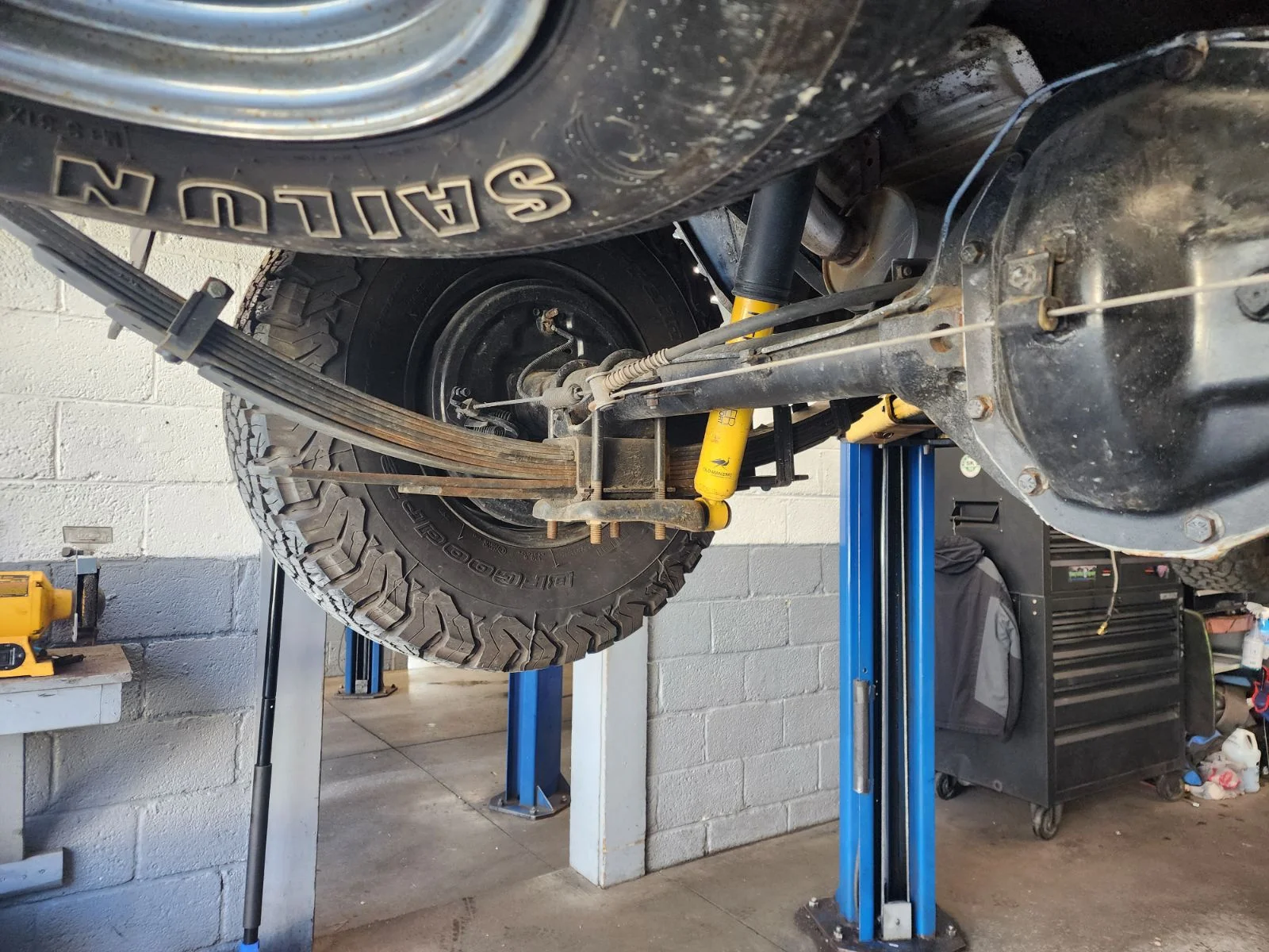

View attachment 3628028View attachment 3628029View attachment 3628024View attachment 3628025View attachment 3628027View attachment 3628029

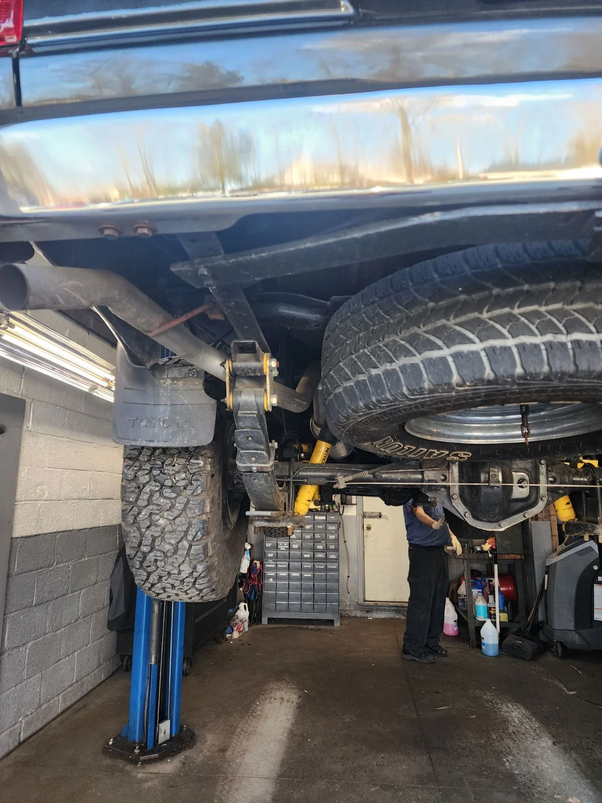

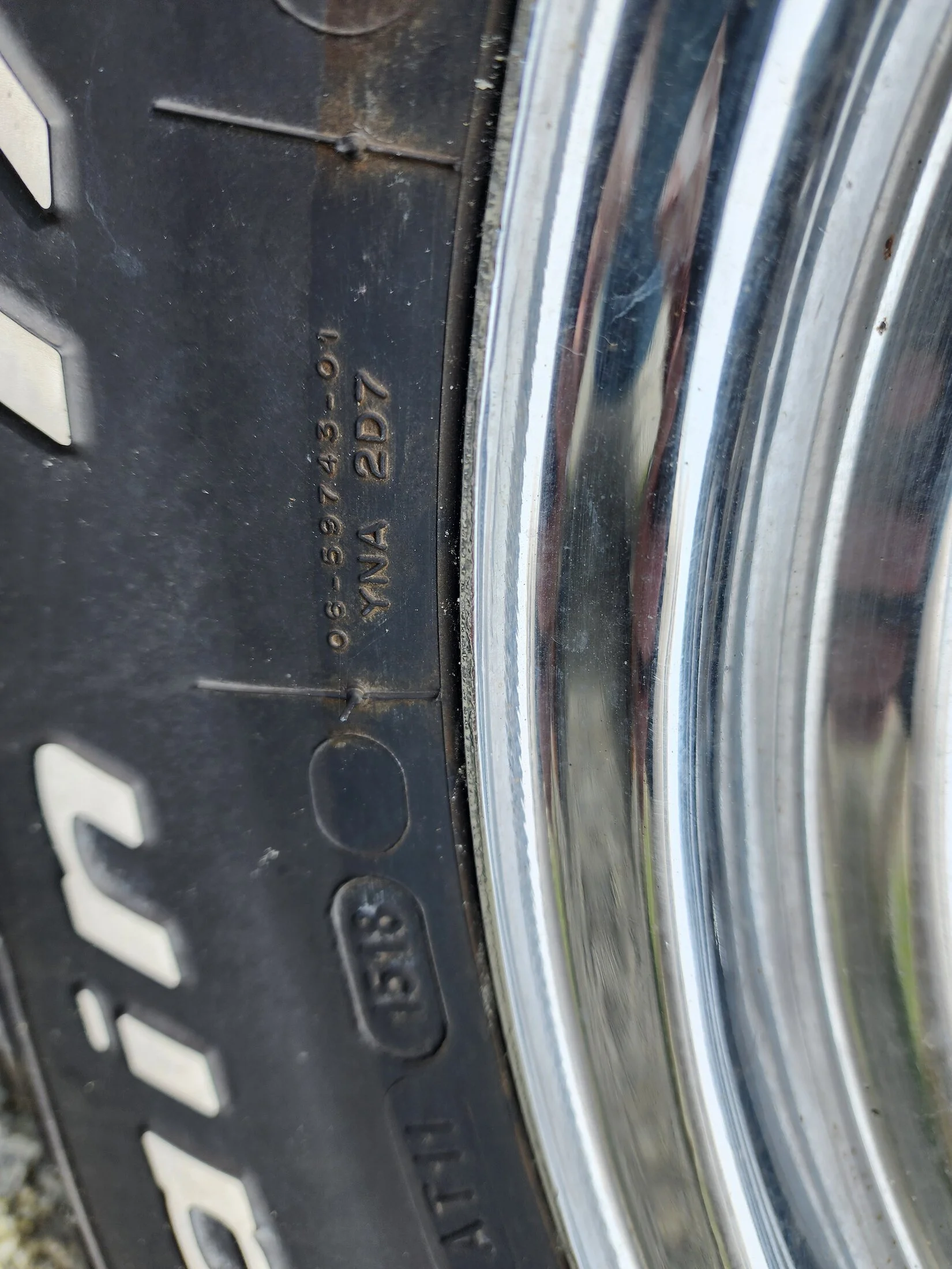

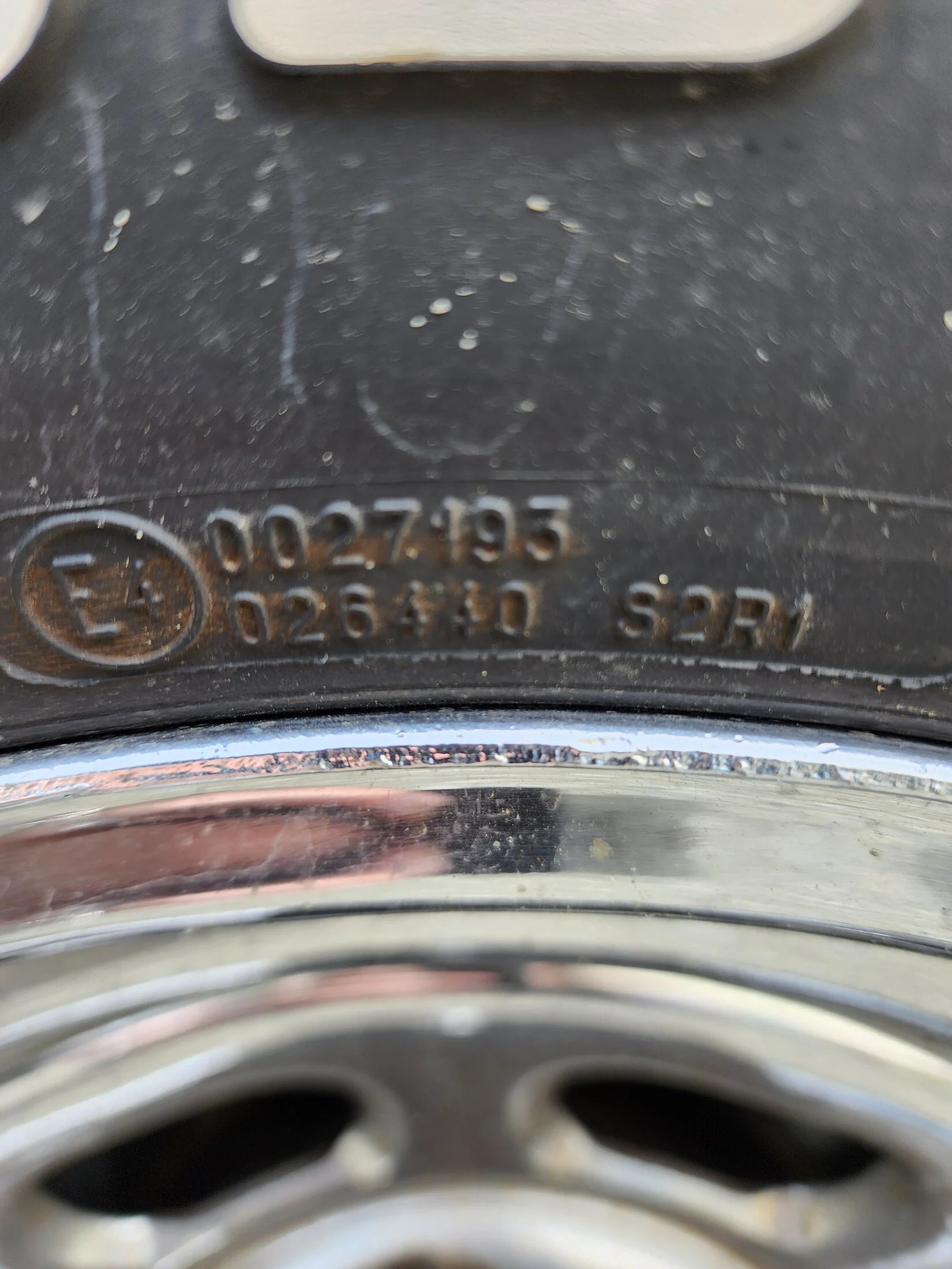

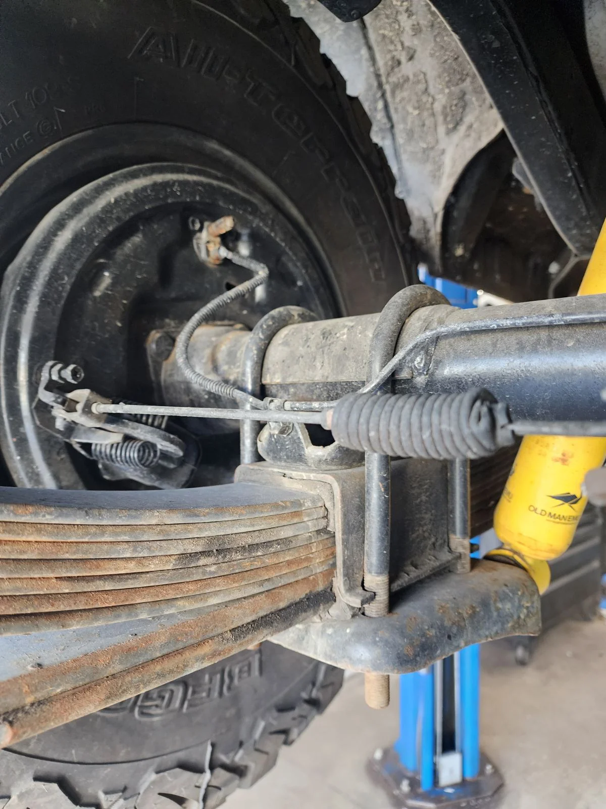

Hi I'm the sister who owns the truck. It has a front conversion done and all that's fine. The rear are still drums and they need to be replaced. So I want to go ahead and do the conversion. It needs new everything. Attached are the tires and bolt figure
you’ll need to go larger rims to to the tundra upgrade. i’d start with the better fronts and well adjusted rears to be honest. most braking comes from the front anyway. do you have a LSVP (level sensing proportioning valve). make sure that is bled and functioning well if you have one or your rears won’t be working properly. like matt said the rear ebrake is a good brake if properly working. you’ll loose that on ebrake upgrades.
now if money is no option then diamond makes a rear ankle housing that uses a modern fj cruiser rear disk with a drum ebrake. i have them for my 40. they will require some fab work and more money for sure but they exist

i wouldn’t say that those are the only options. those are just some i am aware of. honestly if this is not a crawler with heavy armour and all sorts of camping gear just make sure what’s there is well maintained and working well. if that doesn’t satisfy then upgrade the fronts. if that’s still not enough then explore the options that are available for the rear. that’s how i’d approach it. otherwise you’ll spend a lot of money for something that’s probably overkill. don’t get me wrong brakes are super important but i run 33s have bumpers sliders and roof rack and often pull my m101 trailer pretty loaded and my stock brakes are enough.
I believe this 60 came from Venezuela as I haven’t seen a Saliun tire in decades…. And those wheels are locally made there.
I can’t really remember but i used to buy new japanese drum brake assemblies for those d60 rear ends. It makes me believe that the housing end flange bolt pattern is the same as the common Toyota semi floating rear, perhaps check the pattern?
