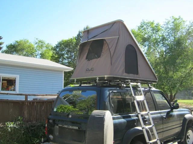

I purchased this tent on June 20th of this year. At the time, the tent sold for $1995. Since I was a member of the local Cruiser Club, I got a $100 discount, but there was also a $50 installation fee. Here it is in my driveway:
[URL="https://forum.ih8mud.com/attachment.php?attachmentid=646301&stc=1&d=1340260284"][/URL]
[URL="https://forum.ih8mud.com/attachment.php?attachmentid=646302&stc=1&d=1340260284"][/URL]
As you can see, mine is black and the tent on the website is white. It comes in either color now. Bobby is saying that when he starts building the tents in Bend, OR, you will be able to request other colors for the fiberglass shells.
This is my first RTT so I don't have any experience or first hand knowledge of other RTTs. I originally was interested in the Hannibal Impi, but after waiting for several months for a response to requests for info and getting nothing, I chose a local vendor. I know some folks in my club that I wheel with that have an 80 series and a Maggiolina RTT. They've had it for a couple of years now with no real problems. So, I'll start with my experiences so far in next post.
I had several personal events this summer that kept me from being able to try the tent out, so I'm actually just getting around to trying it out. I demo'd it (popped it open) to all my relatives that I've been with this summer, mainly because they were curious. One of the questions that kept popping up was: Does it have enough room to stretch out? Well, in the couple of times I've used it so far I've noticed that since it pivots open at the "feet end" there is less room down there and I do notice when I turn over, I sometimes will kick the top of the shell. I'm 5'9" and I think taller folks would have problems stretching out.

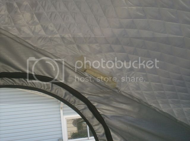

One problem that surfaced was the driver's side air strut top mount just separated from the shell:
[URL="http://i874.photobucket.com/albums/ab305/tbridge1/RTT/HPIM0833a-1.jpg"][URL="http://i874.photobucket.com/albums/ab305/tbridge1/RTT/HPIM0833a-1.jpg"][/URL][/URL]
[URL="http://i874.photobucket.com/albums/ab305/tbridge1/RTT/HPIM0832a-1.jpg"][URL="http://i874.photobucket.com/albums/ab305/tbridge1/RTT/HPIM0832a-1.jpg"][/URL][/URL]
[URL="http://i874.photobucket.com/albums/ab305/tbridge1/RTT/HPIM0834a-1.jpg"][URL="http://i874.photobucket.com/albums/ab305/tbridge1/RTT/HPIM0834a-1.jpg"][/URL][/URL]
Bobby, said it was a manufacturing defect. He replaced the tent for me. Still no new mattress had showed up. He actually drove the new tent out to me here in John Day, which is 3 hours from Bend, and we took the old tent off and installed the new one at no cost to me. He also let me keep the old mattress. So now the combined thickness is 3" since the current tents still have the 1.5" mattress.

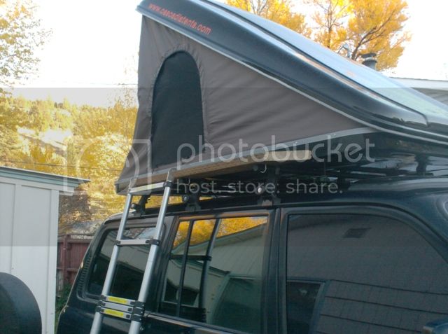

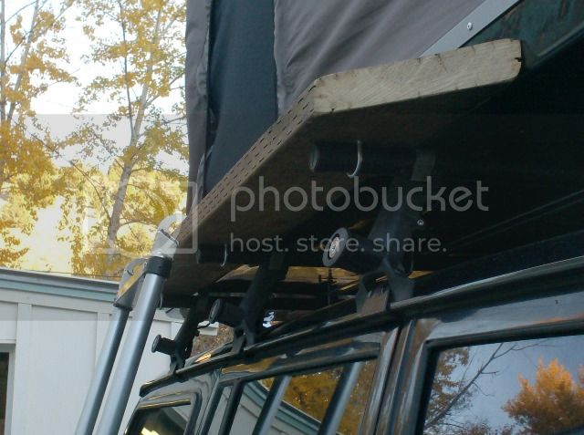

One of the things that bothered me about the Yakima bars hanging out on the edges of my roof was their exposure to catching obstacles off road. I wanted to try and prevent this and strengthen the setup if possible. My solution, shown below is yet untested and unfinished, but I think will work. And in addition it will assist entry and exit from the tent. It has already improved the upper end of the ladder connection:
[URL="http://i874.photobucket.com/albums/ab305/tbridge1/RTT/HPIM0909a-1.jpg"][URL="http://i874.photobucket.com/albums/ab305/tbridge1/RTT/HPIM0909a-1.jpg"][URL="http://i874.photobucket.com/albums/ab305/tbridge1/RTT/HPIM0909a-1.jpg"][/URL][/URL][/URL]
[URL="http://i874.photobucket.com/albums/ab305/tbridge1/RTT/HPIM0913a-1.jpg"][URL="http://i874.photobucket.com/albums/ab305/tbridge1/RTT/HPIM0913a-1.jpg"][URL="http://i874.photobucket.com/albums/ab305/tbridge1/RTT/HPIM0913a-1.jpg"][/URL][/URL][/URL]
[URL="http://i874.photobucket.com/albums/ab305/tbridge1/RTT/HPIM0919a-1.jpg"][URL="http://i874.photobucket.com/albums/ab305/tbridge1/RTT/HPIM0919a-1.jpg"][URL="http://i874.photobucket.com/albums/ab305/tbridge1/RTT/HPIM0919a-1.jpg"][/URL][/URL][/URL]
They are pre-treated 2"x6" boards and u-bolts holding them to the bars. I've recessed the Nylock nuts and washers so I can put some sort of a non-slip surface on the top side. I'm also planning on intalling limb risers from my ARB to a bracket that mounts on theses side supports. I've eyeballed it and it looks to clear the hood. If possible, I'd like the top brackets to allow the limb riser to attach at the level of the top of the front of my RTT. That should help to keep limbs from trying to scrape it off, I hope.:hhmm:
I'm wondering if a generous snow fall might build up on the boards and cause the old ice dam problem for leaking into the tent. Well, let it snow - it's getting to that time of year, at least here.

Is the new tent redesigned so the air struts do not come unglued? That looks like a rather large weak point since they are always exerting force on the attachment point.
Have you had it out in a good rain storm yet? That is my #1 requirement with any tent is its leak proof and keeps you dry in even the biggest rain storm. Unfortunately up here we see rain on every trip.
Been thinking about it and I realized what the mattress reminds me of. A wresting mat - I'm serious. Anybody that's spent much time in that sport knows that while they are adequate for wresting matches, you'd have to be "dog-tired" to get much sleep on one. They do come with a washable cover, which is a plus I guess. :rolleyes:
I have a suggestion. For my bed at home, I have a 1.5" thick memory foam mattress topper with a 1" down feather bed on top of that. Just for fun, I actually put it down in the back of my last SUV for a camping trip to sleep on instead of setting up a tent. Honestly I couldn't tell the difference between the floor of my SUV and my bed at home it was so comfy! I'd say ditch one of the mattresses and get yourself a setup like that!
Is the new tent redesigned so the air struts do not come unglued? That looks like a rather large weak point since they are always exerting force on the attachment point. .......
I agree, a weak point if not fixed. The new tent, I was told by Bobby, has a different, stronger attachment point that is reinforced. I can't tell, though, without tearing it apart to look, so I'll have to trust and give it time.

Bobby admitted to me that after seeing mine, and 1 other that this happened to (out of approx 150+ tents like this he's sold) there was a design flaw. The tents have a 4 yr warranty - twice the Hannibal warranty. So I'm confident if there's any future issues, I'll be taken care of. "The new tents have an improved design" is the word I'm getting. But, truly, I understand your hesitation. It's a lot of $ for a tent. I believe 'themorb', a fellow mudder from up your way, has one of these tents now, if you want to PM him for his opinion.
