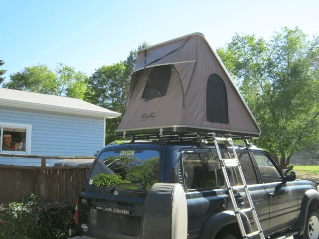

Well, after temporarily moving the tent and awning back to the Land Cruiser for an awesome trip experience to the Maze, in which because of limitations at camp sites, I couldn't tow the trailer in....some issues have surfaced. It's been an awesome RTT, but it's starting to show it's age.

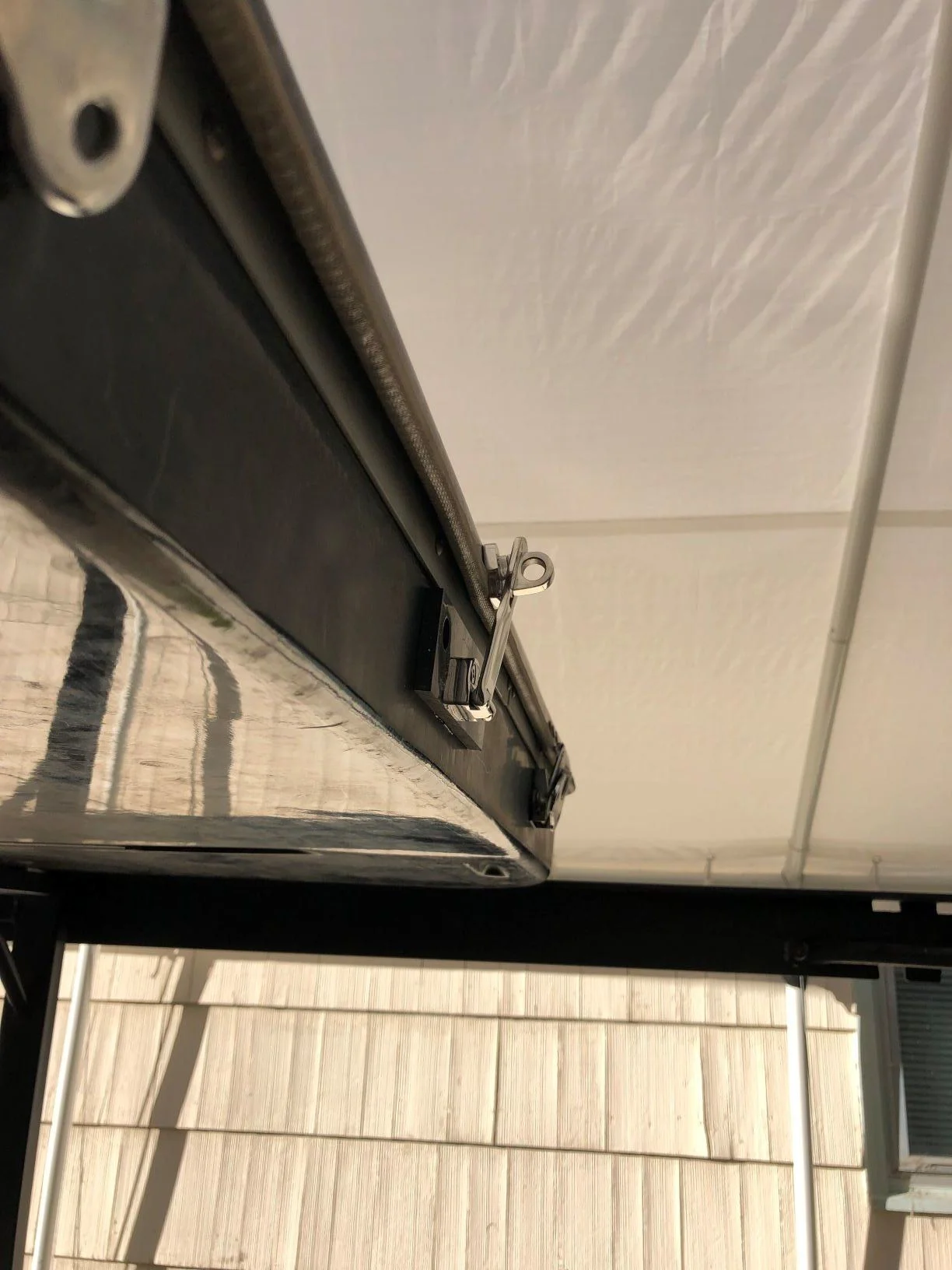

These latches that hold the tent closed, which I've had no problems until this trip, all of a sudden are allowing the tent to pop open:
I'm thinking it was the serious pounding it was taking from the road between Teapot Rock and the Dollhouse. Noticed that it was loose when setting up camp that evening. Thankfully, it only opened an inch or so and not much dust got in. Used a ratchet strap to keep it closed for the rest of the trip. Anyway, I've got a fix in mind and ordered from Amazon. It's due in soon.

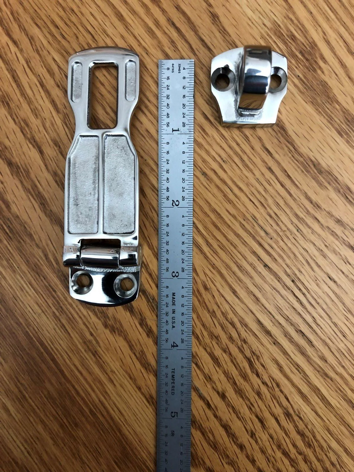

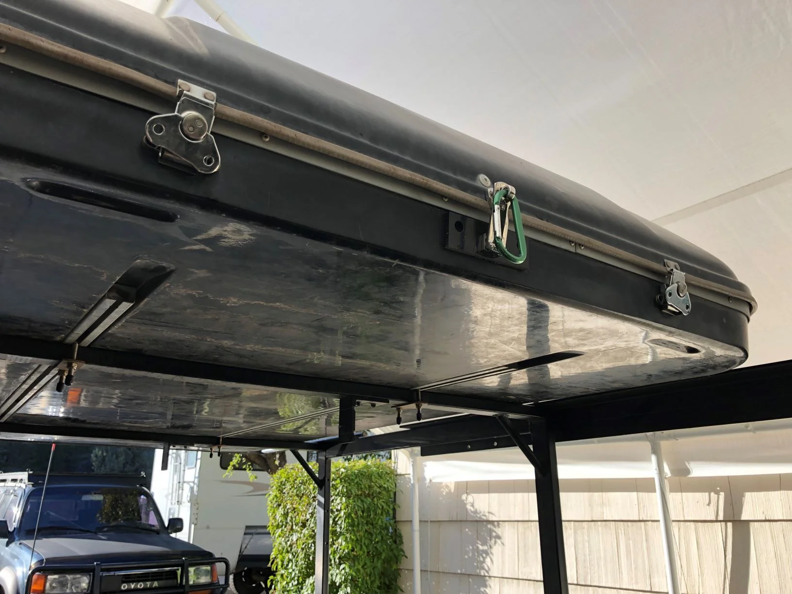

This should do the trick for securing the lid. It's stainless steel and it'll be mounted in the center, in the rear. The eye rotates so I can just turn it 90*, put a beaner, or a padlock. Before I used a rolled up sleeping bag inside tent to give resistance to allow OEM latches to do their job. Problem is - there's no consistant resistance, so if allowed to close completely, the latches don't function correctly because they require resistance to work. With this hasp, it wont matter:
