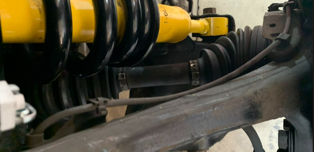

I'd look for two things:
1) Are the cams on the LCAs way off from each other? I.E. Forward cam is all the way in, Rear cam is all the way out
2) do the CV angles look significantly awkward? These pics from the linked thread look like the CVs are at a pretty extreme angle front to back.
What is the orientation of this pic? Not sure what angle I am seeing this from!
Pic is looking down from above. It looks like the axle is shifted a good bit forwards.
Well the half-shaft definitely let go, angles don't look bad so I am willing to say that it doesn't look like the alignment pushed things too far forward. I am willing to bet that it simply wasn't reseated correctly during the lift install. The new CV should be going in tonight, hopefully I'll have it back home tomorrow evening.
