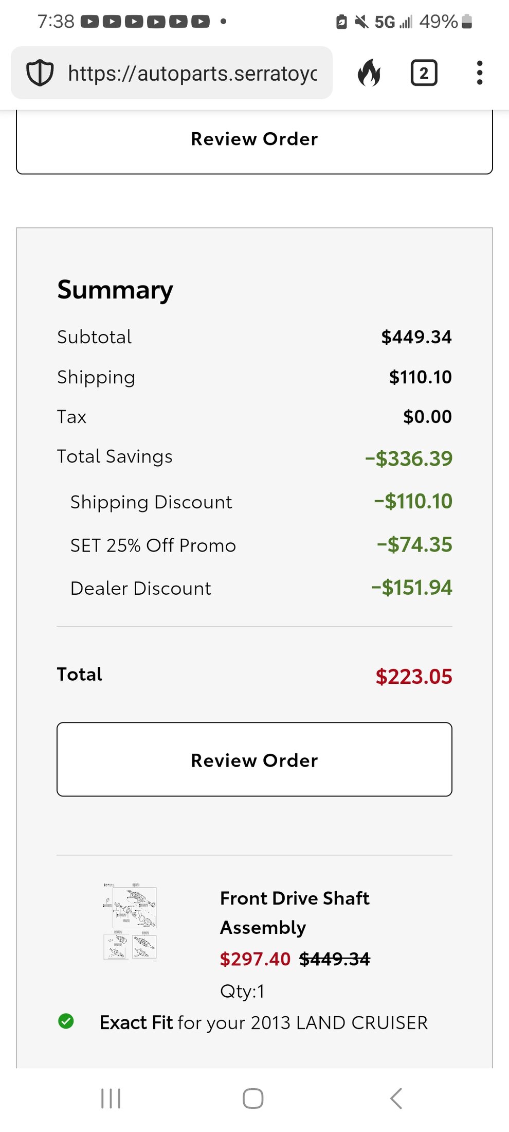

With the current sale its $223 for an OEM CV. I imagine what the shop will install will cost more then this and it will be an inferior aftermarket CV.

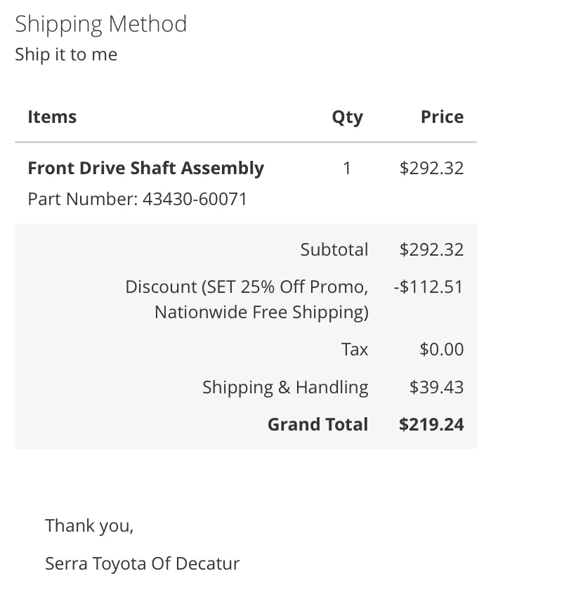

Damn. It’s tempting to buy a couple to store for eventual replacement at that price.
Literally just ordered a CV 60 seconds ago. Cost was $219 shipped.
I've been chasing a popping sound at low speed primarily on hard acceleration/braking. Dealership replaced the axle nut and retorqued and it got quieter but was still there. They suspect the CV has some internal damage or wear and are replacing the driver's side ($449 list price for the CV, plus the labor). I'm ordering a spare to eventually do the passenger's side (or serve as a trail spare for now) because at 160k miles the $219 is cheap insurance to have on hand.
Where did you get that price ($219)? I see $297.40 at the Serra Toyota link above.
It adds the 25% off and free shipping when you go to checkout

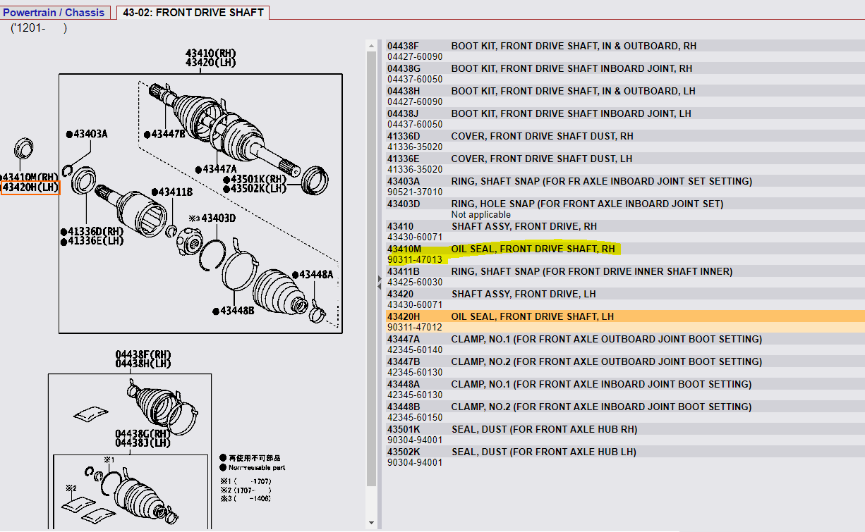

If I order a CV as a spare, what else do I need? Do I need these seals:
I assume, If I carry a full spare CV, I do not need to carry a boot kit.
Edit: There seems to be something wrong with these seal part numbers. Hey Sensei @bloc, I can find the 90311-47013 seal on the Serra web site and it says its correct for my 2015 LC but the 90311-47012 number pulls up a seal that says its for the T-case.
I would research whether our CVs tend to completely nuke one of the cups when they fail. If so having the seals may be important. If not, it is probably not worth messing with on the trail.. especially the larger diameter one in the back of the knuckle.
Seals do sometimes get used in more than one place on a vehicle. And, Toyota’s online parts sales index has been inaccurate before (or at least more so than the site you are using). I know I’ve had a number of parts come up as not suitable for my 2013 cruiser and they bolted right up.
Does it make sense for left and right to be different?
Partly, because one mounts into the side of the diff case and the other is on the extension housing.
