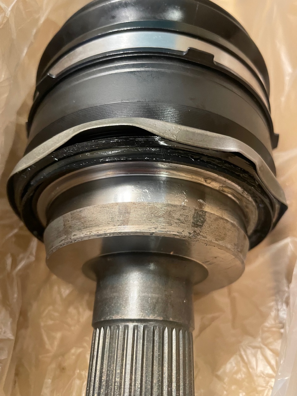

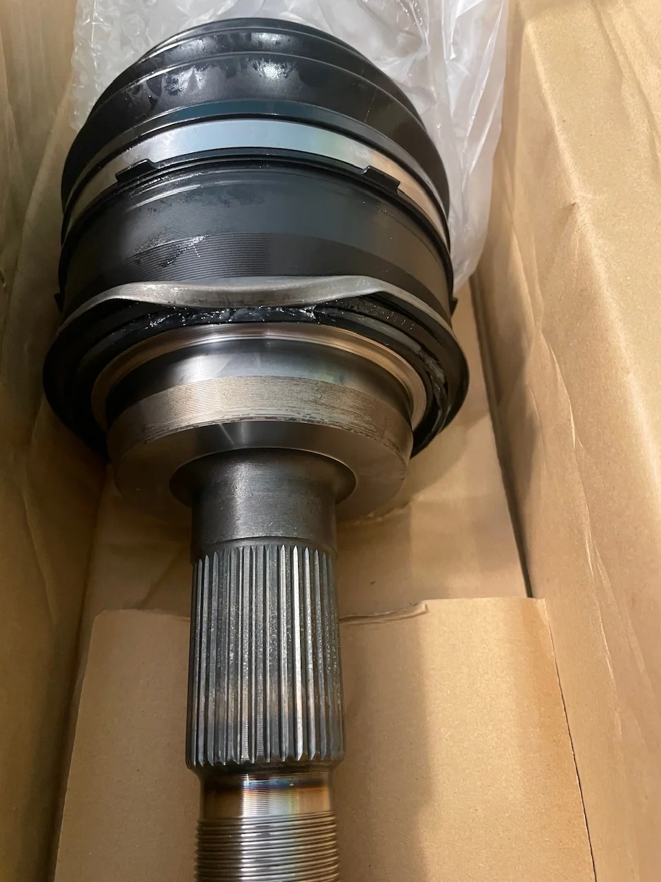

Got my axles from Serra. Both dust seals messed up during shipping.
I’ll call Serra tomorrow and see what they will do. Note I also posted this in another CV thread thinking it was this thread. Sorry for double posts.
