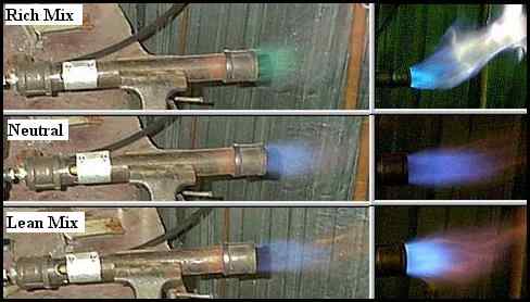

Maybe this will help, you want a neutral flame:

The flame should not change shape much at all when you apply the straight oxygen.
