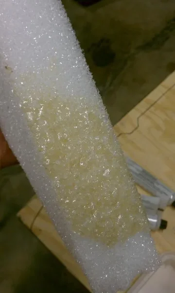

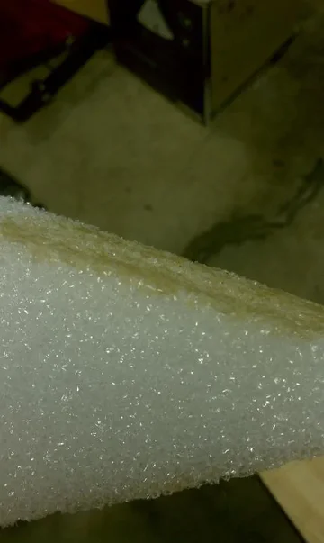

So I put some of this resin with hardener mix on it to see if it will eat at the styrofoam..
It didn't.......
I let the sit and dry for about 2 hrs... with no ill effects...

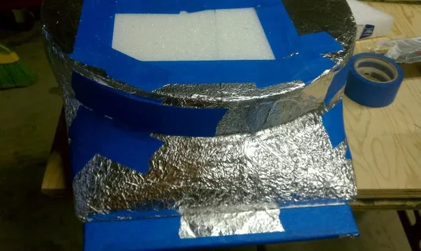

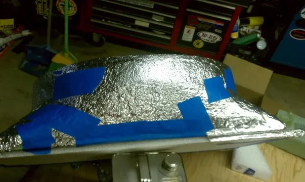

With that said..... I did wrap the whole mold with foil paper.... to make the peel off a bit easier and the inside smooth....
Here is the mold all wrapped up on foil paper and blue painters tape..
It didn't.......
Hmmm.... I'm actually a bit surprised. I've seen some pretty dramatic failures in such situations - including one girl back in architecture lab who decided to fiberglass the main model for her thesis the night before she was set to defend... :crybaby:
PAToyota, I spilled some resin on another piece of Styrofoam and IT DID melt it right through..
