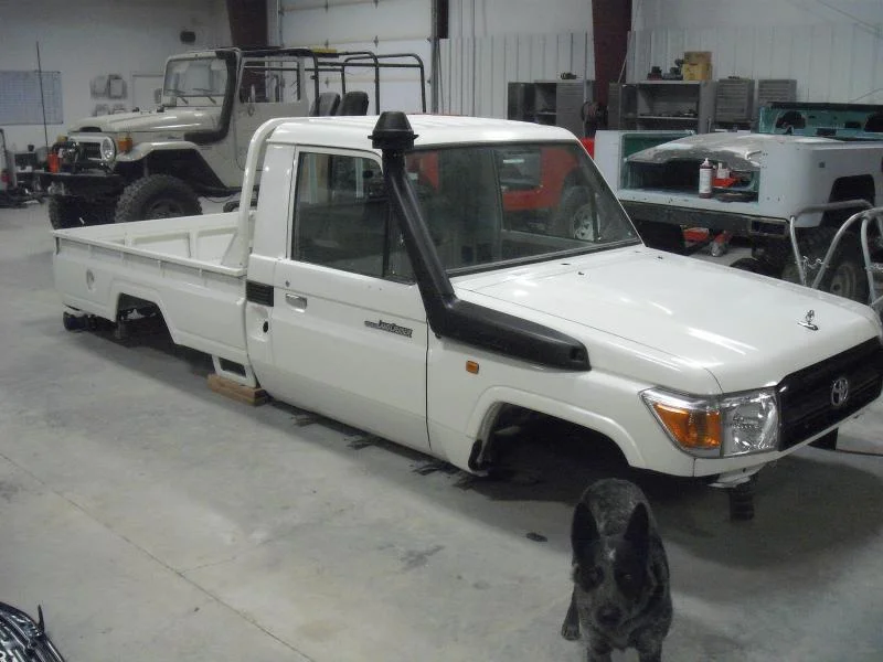

I am having Proffitt's Cruisers build me an HZJ79 and this is the build thread.
The plan is to use one of the new 2010 FZJ79 bodies they acquired from Saudi Arabia:
https://forum.ih8mud.com/vehicles-trailers-sale-wanted/360764-land-cruiser-pickup-project.html
attachment.php
attachment.php
and acquire a frame, suspension, drivetrain, interior, etc. from mine trucks from Canada. We will use new parts where necessary.
It will be mostly Toyota OEM with some improvements.
Planned drivetrain is a 1HZ with turbo and a 5 speed, probably an H55F. Rear ARB locker.
There will be a bunch of custom armor.
Haven't decided what to do with the bed yet re: rack or cover. A soft top would be fun but maybe not practical for my climate (long winter).
The mine truck parts just recently arrived at the shop so the build is just starting.
This is pretty much my ultimate LandCruiser. I haven't had a pickup truck for 9 years and I really miss it. A diesel LandCruiser pickup is going to be sweet.
I'm having the body bedlined completely underneath, as well as the inside of the bed and the floor of the cab, for corrosion protection. Ultimate corrosion protection is the mantra of this build, the winters are long here and they use a lot of salt and sand all winter.
I'll post some photos of that when I get them, hopefully Monday, as the bedliner guy was working on it Friday.
So far this is my truck: a mine truck frame. It will get rock sliders and rear quarter panel protection welded on and some kind of rear bumper with a hitch receiver, then be blasted, hot dip galvanized, and powder coated.
My body armor will be an ARB combination bullbar and custom sliders and rear quarter panel protection similar to those on Grease Cruiser's (shop manager at Proffitt's) truck.

Was hard to decide what to do about a rear bumper. The factory ones are useless. The rear lights are in the way. I want a hitch receiver. Probably something similar to Grease Cruiser's again:

Was hard to decide what to do about a rear bumper yet. The factory ones are useless. I want a hitch receiver. Probably something similar to Grease Cruiser's again:
Sean, if only for protection from the slight little bumps and dings that you get from backing or having someone bump you from behind, I would have something that extends back below and at least four to six inches behind the last bit of sheet metal on the bed and tailgate. Protect the tail lights and such with some distance, if you will. It also provides a bit of a step up when needed.
Yeah, definitely get a built-in 2" receiver that will handle Class III tongue load duty.
This thing is gonna be beautiful.
Oh, and I know how tempting it can be to busy-up a truck bed with other things (racks and tops, etc.); however, I would urge you to keep it simple and use it as-is for a bit. You've got your 100 and you're going to love the wide open usefulness of a pick-em-up truck. Re-learn what every Texan knows: Pickup trucks RULE!
That was my original plan but it doesn't work very well with this body because the tail lights hang down really low. In order to have a bumper like that with enough clearance of the body to allow for some flex the bumper would have to be really low, making the rear departure angle even worse than it already is.
Another option is to do some complex body work and cut off the tail lights and move them elsewhere but I don't like that idea.
It's a difficult problem to solve. I am not happy with Toyota's design of this part of the truck.
Yeah everything is a tradeoff. This will not be my first pickup truck and I've gone both open bed and hard cover before and I liked the hard cover much better. :hhmm:
That was my original plan but it doesn't work very well with this body because the tail lights hang down really low. In order to have a bumper like that with enough clearance of the body to allow for some suspension flex the bumper would have to be really low, making the rear departure angle even worse than it already is.
that was my worst fear with my old HJ45--rear end damage. If your lift is sufficient, there would be room for a pretty solid tube setup back there. And a tube wouldn't hurt you too much on departure.
:hhmm: Can you have them fab up a bumper that fits into the receiver for the in-traffic concerns? That is, idiots in parking lots, the unintended backing up into the mailbox, and such? Something strong enough to take a 5 mph bump? This something could be taken out when wheeling, or when the hitch is needed.
Of course, that just means all the body damage back there is going to come on the trail, in which case you only have yourself to blame. :D There's got to be some way to get some sort of steel beyond the sheet metal without sacrificing too much departure. :hhmm: Maybe extend something from the rear quarter panel protection? But that would interfere with the lights, hitch, or tailgate. :hhmm: Tough.
