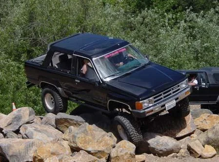

Have you seen the top on the black twiddy 4 runner?
for those who dont know what your talking about a link or more info would be appreciated THX.
LIKE ME! :lol:
twiddy?
Is that the black top in the link above? No, I haven't seen it if not. I can also keep a roof rack with this set up. With no top at all, I loose a platform for my roof rack, although, that could be fabricated as well. Any body, try a traditional truck pick up bed rack system?
