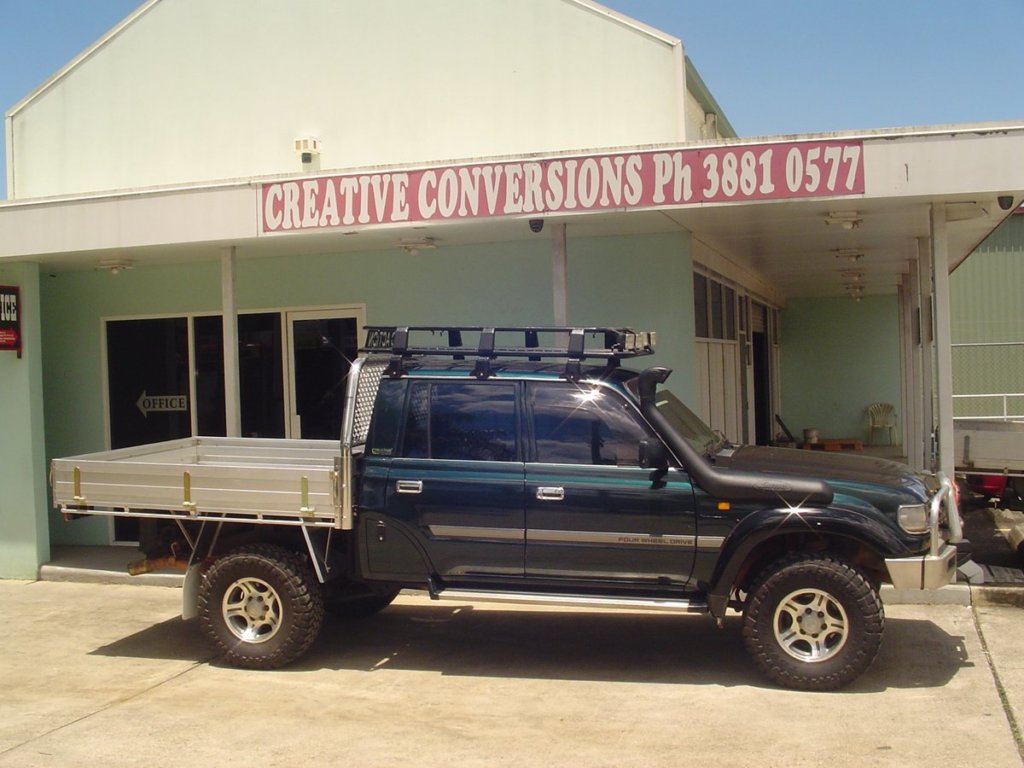

Dang man you got me all excited about a pop top. I'm interested to see what you have up your sleeve and the final design will look like. Two I recently saved. I would guess you plan to maintain the existing wheel base.
View attachment 1668281 View attachment 1668282
No, the wheelbase/frame will be extended 22-24" and the frame will be off an 80. The old wheel well will become a storage box.
