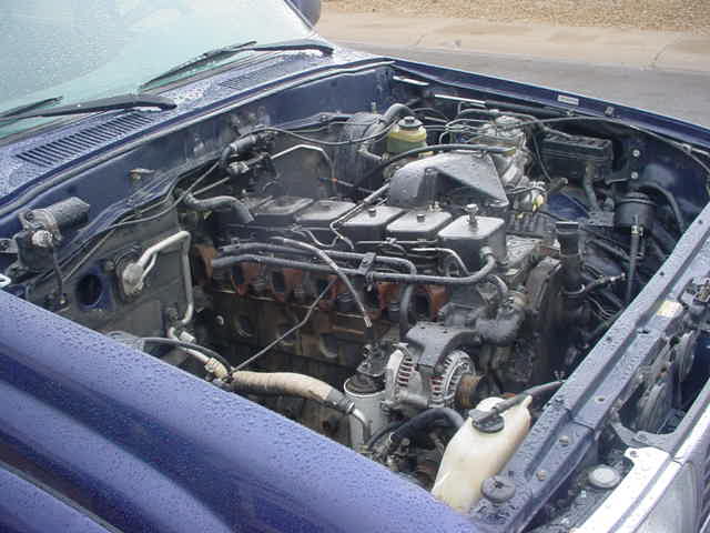

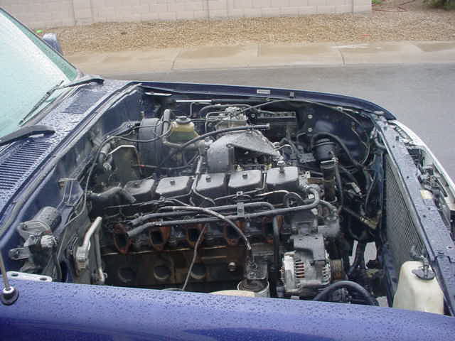

Heres my 80 with the I-6. just waiting for drive train parts and alignment to button her up . (should be done end of July)
-Ron

Ok, first things first. About the cost of the swap. The $12K-14K includes the lift, the tires, and all the drivetrain parts, which most of which are rebuilt or new. Total labor bill, including the installation of the lift, is less than $4K. The rest is parts.
Not sure where someone got the idea that top speed is 65mph. The Cummins 80 will hold 85mph all day long and cruise mountain passes at 65+ mph.
Motivation behind this swap is not to gain power. If you want power, go with a Vortec. Nothing wrong with that. This particular customer wanted the ability to run sustainable fuels. Can't do that with a gasser. And......the COOL factor. Imangine all the jealousy of the soccer moms (btw, this conversion was done for a woman) when you pull up in a newer diesel Cruiser.
Rainy Day FZJ: You asked about a NV4500. No, it would not be cheaper. Actually about $600 more expensive. When you factor in the cost of the clutch components, $400 flywheel, and the fact that a rebuilt NV4500 is $1,500, the automatic is a cheaper choice.
gnx7: Yes, the Cummins are known to be loud and rattly. However, FJ62's and 80's had superior insulation to earlier models. We add a layer of insulation to reduce the noise even more. I would not say that you can't hear the engine running, but it is actually very quiet inside the cabin. You can easily carry on a conversation with all passengers.
Just so it's clear, we are not trying to pimp this conversion. We have 8 4BT conversions scheduled as of right now. I just wanted to post some pics as there was some interest in putting a 4BT into an 80. If you do want to talk about a conversion, feel free to call the shop at 1-877-PROFFITT or email us at info@proffittscruisers.com

having a cummins powered truck, how bad does it shake at idle?? Most of the 4bt's I have seen shake bad. and are rough little motors... but they do put out good reliable hp...
project 80???..what did you use for a transfer case...(offset output 205?)... ???
I know why you used a 700r4 to a split case... easy adaption and if you dont put injectors or a turbine housing on the 4bt the 700r4 should last...would like to see it in about 40k miles... just currious...
25 mpg from a 4bt is not hard to believe as I can get 20mpg from my 92 dodge 4x4 if I drive it nice...and parts are cheep for the motor..
as for the 85 mph comment the reason for that I think is the stock governer on the 105hp models will only take the motor about 2800 rpm.. with an overdrive and 31's it would be about 85mph.. now take the governer spring and change it and adjust the high idle and the motor will go 3500rpm no problem the newer dodge truck motors rev this high factory. You can do 100 without a problem with factory gearing.. as long as the transmission has an overdrive... and you run 33" tires..

Thanks for sharing the pics! It's very cleanly done, and definately is getting the interest level up for several of us. Post back after a full tank has been run, and you have some actual mpg you can share.

Grease- what stock accessories are retained in your conversion? Also, is it possible to retain the fulltime TC? How about retaining the stock A442F / A343F tranny? And where are you located?
This is a GREAT thread. Ive been thinking about an engine to swap into my 62 wagon and this info has been very useful hearing the pros and cons to the diesels.
I have the I6, and though they last for ever...its really no fun driving when youre chugging up hill with a line of cars behind you with a top speed of 45-50 MPH!
Chicago

Yep! Great motor until you try to get parts for them. The 4BT is sort of cool because you can get parts almost anywhere for them in the US. Even uncivilized places like Wyoming. Try to find parts for a gasser Toyota in the middle of Toyota and it takes a few days. Get rid of your internet connection and try getting parts for a Toyota diesel in these uncivilized portions of the US, you'll be waiting. I couldn't even get parts for BJ60 locally in Idaho. How would I ever get them for a motor not imported for highway use in NA.
