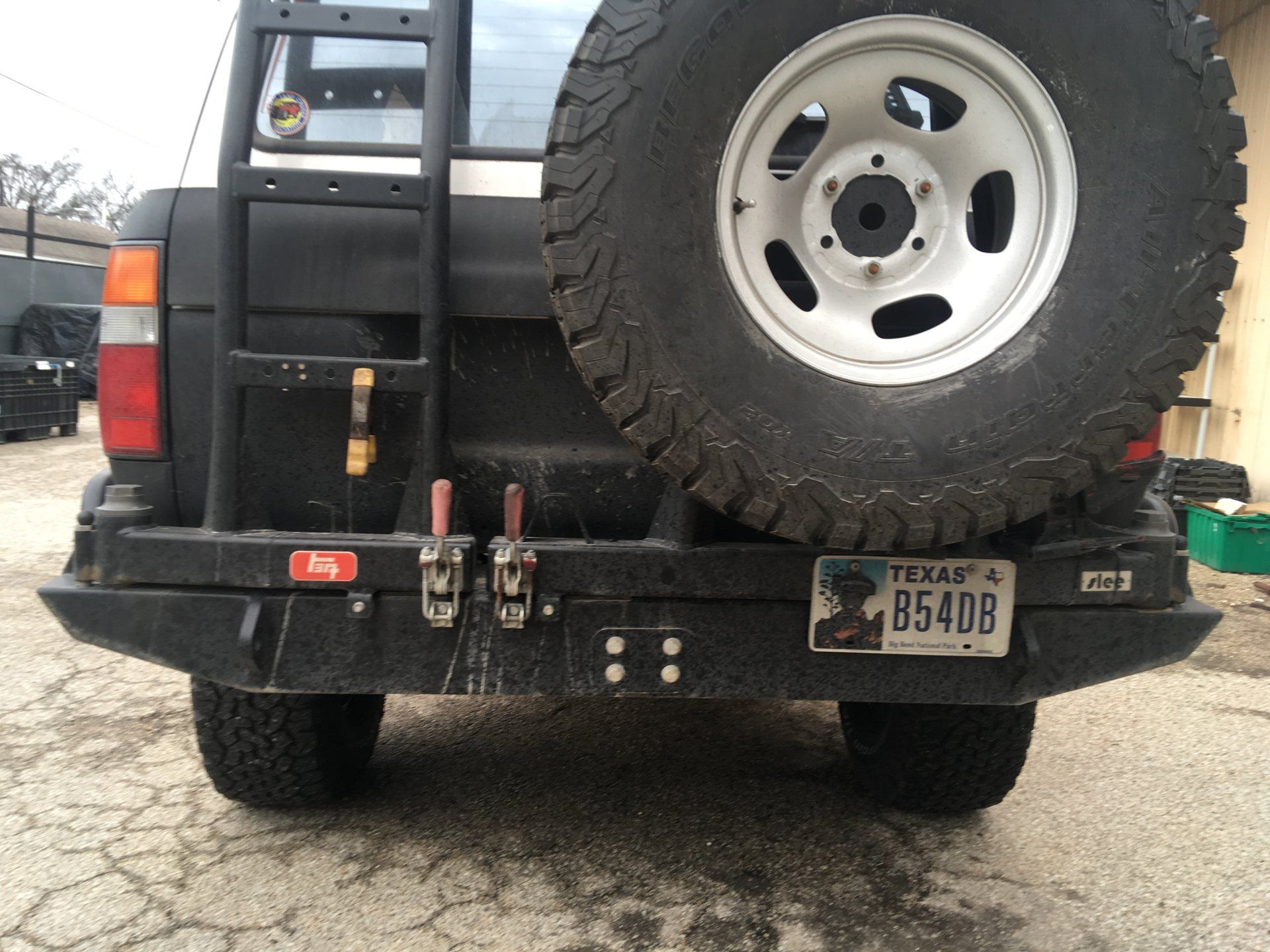

Well I pulled into work this morning and saw a whole lotta oil on the ground. After I checked oil and fired it up again it turned out to be the unused oil sensor on the drivers side of the block that was spewing oil. I have my sensor on the oil filter housing. When I grabbed the sensor it broke in half in my hand. Lucky enough I had an 1 1/8 sock here at work to remove and now am going to get a NPT plug to put back in. It must of blew close to work because I only had to add a quart of oil.
I thought the worst which was tappet cover gasket. That is a fix in which the injection pump has to come out.
Underbody would be nicely coated for midwest winter now. You can see the oil spots all over the rear bumper.
