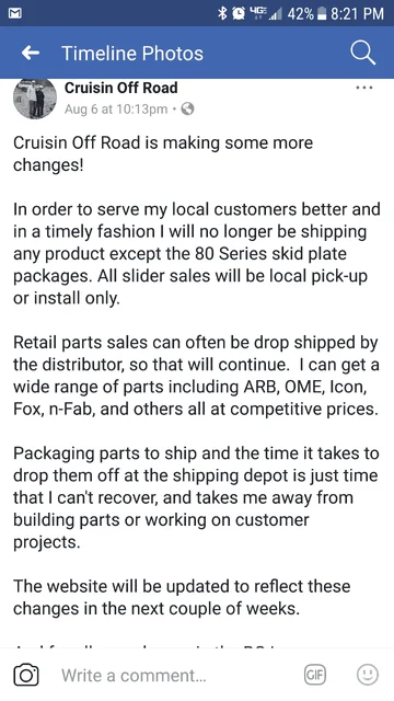

Screenshot_20170910-202146.webp click to view.

I guess it's kinda a moot point now, unless you live in Western Canada or the Pacific NW and up for a drive. He's not shipping the sliders anymore, which is odd since I showed him the Fastenal option.
