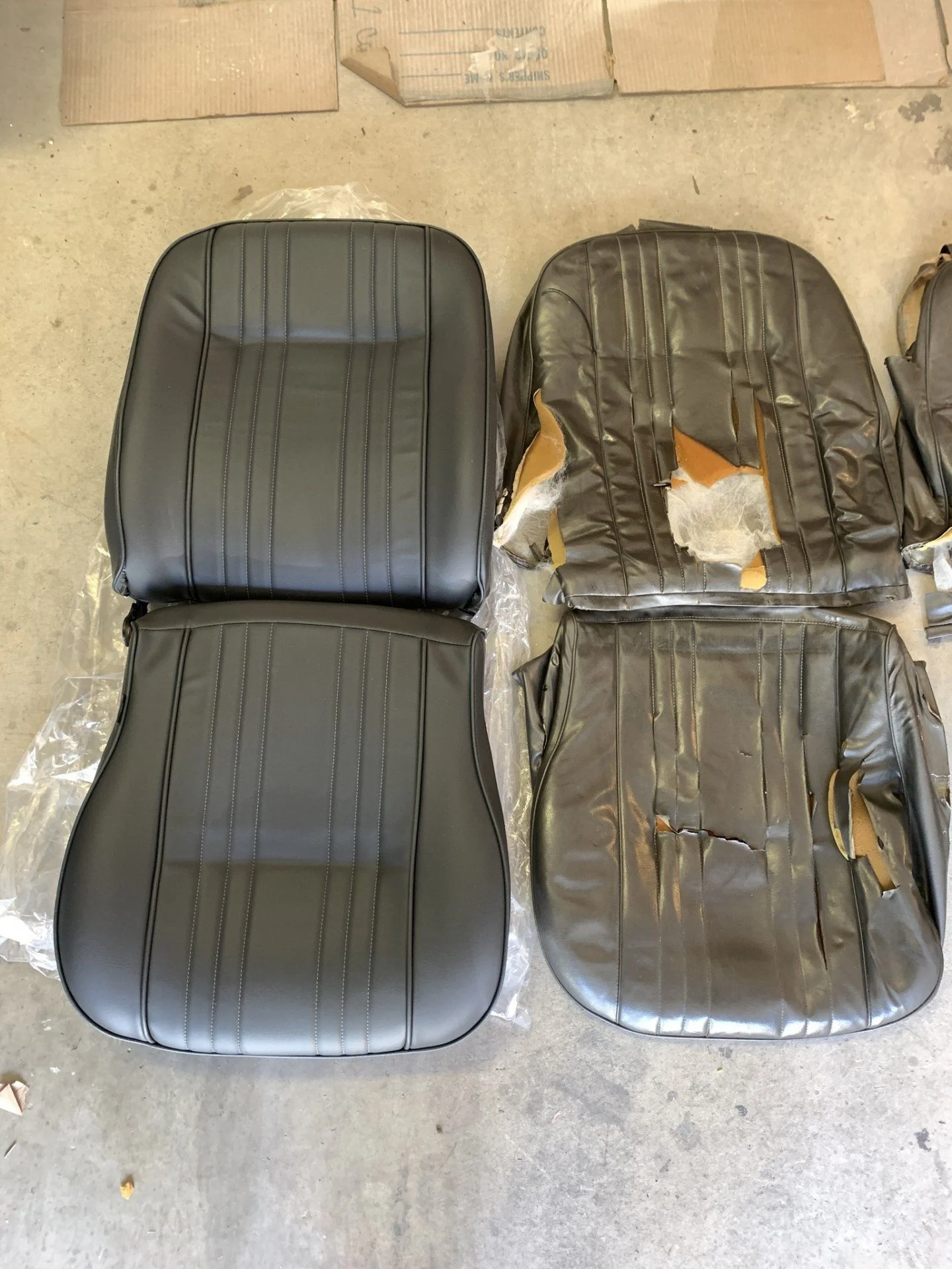

The old seats had this really stiff vinyl on them (fore front). And was shiny. Never liked it.

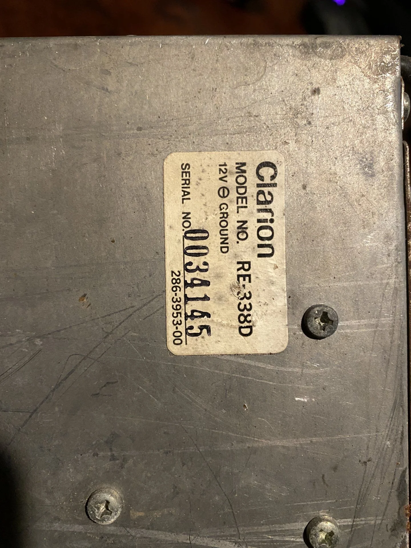

Thanks, I am gonna go with Cruiser Corps. I have a Clarion radio that came with the 77, FJ40 that I am in the process of rebuilding. I haven't tested the radio just removed it when I disassembled the truck. Can you test it to see if it is still alive?
