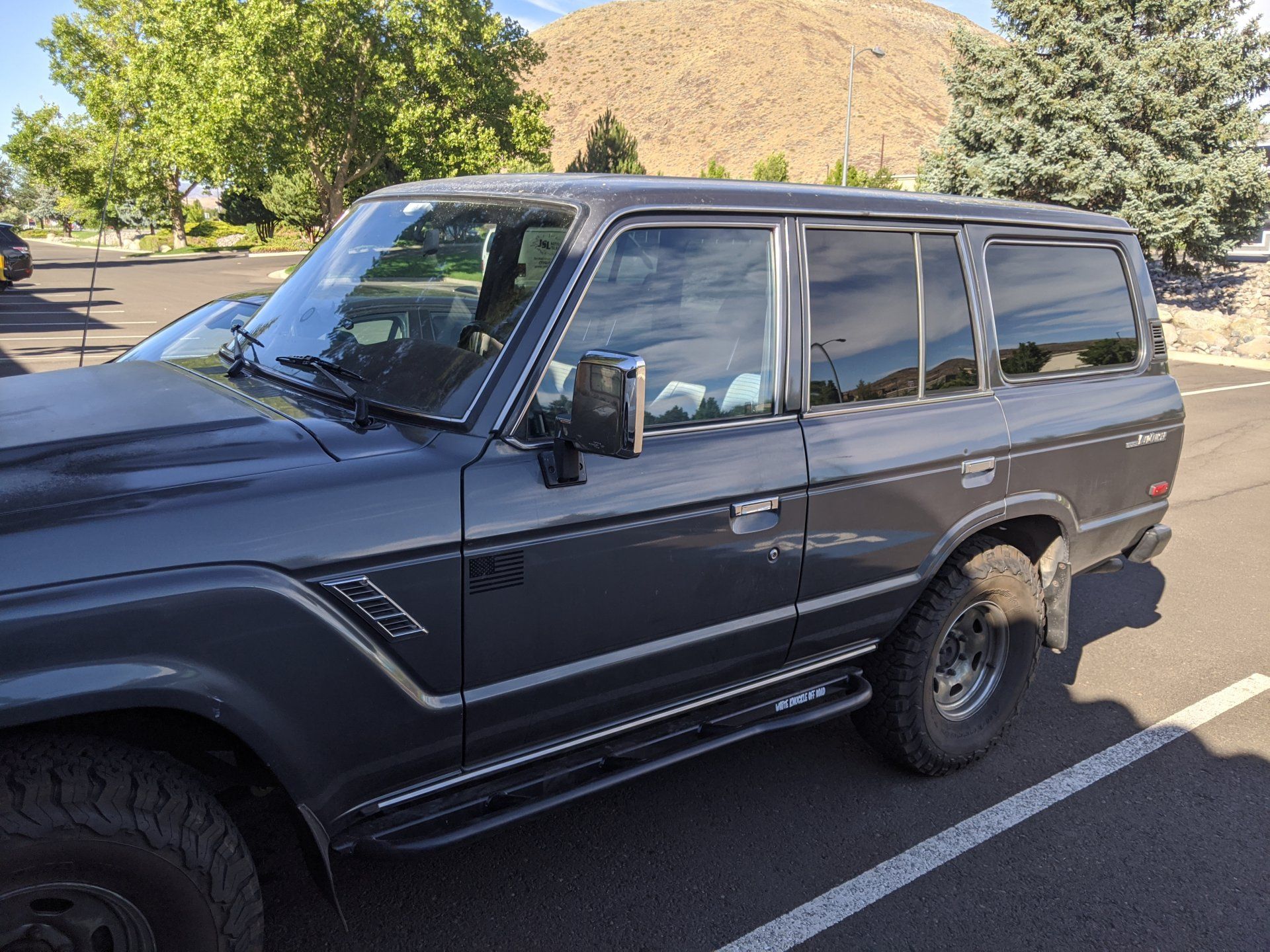

Hey all! Been a while but a lot has happened since my last post.
Next was the window tinting. I ended up going with full limo tint for all behind the driver and pass doors. Very happy with how it turned out. The driver and passenger are 70% and all block 99% UV. The car stays very cool and paired with AC is very comfortable.
Driving up to Tahoe is rough in this thing. If anyone has gone through Auburn up to Truckee in a 3FE with 33's you know all about it. Put this guy on so maybe people are less dick...y?
