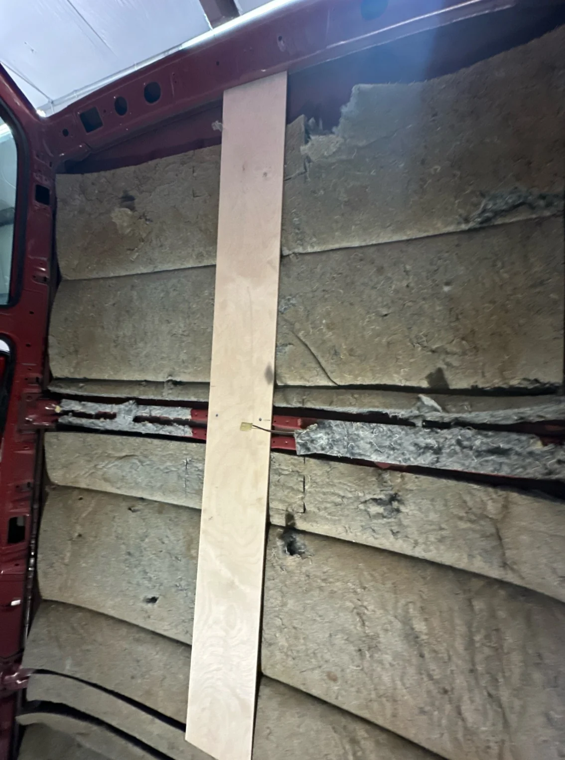

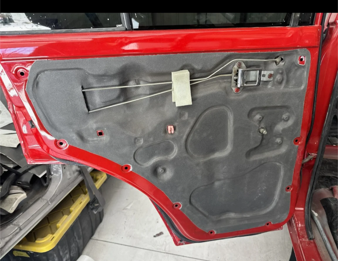

nah, would just have to disassemble at Js. i mean...new carpet, new door panels and sets are all rdy to go in....but, its getting framed off at Js

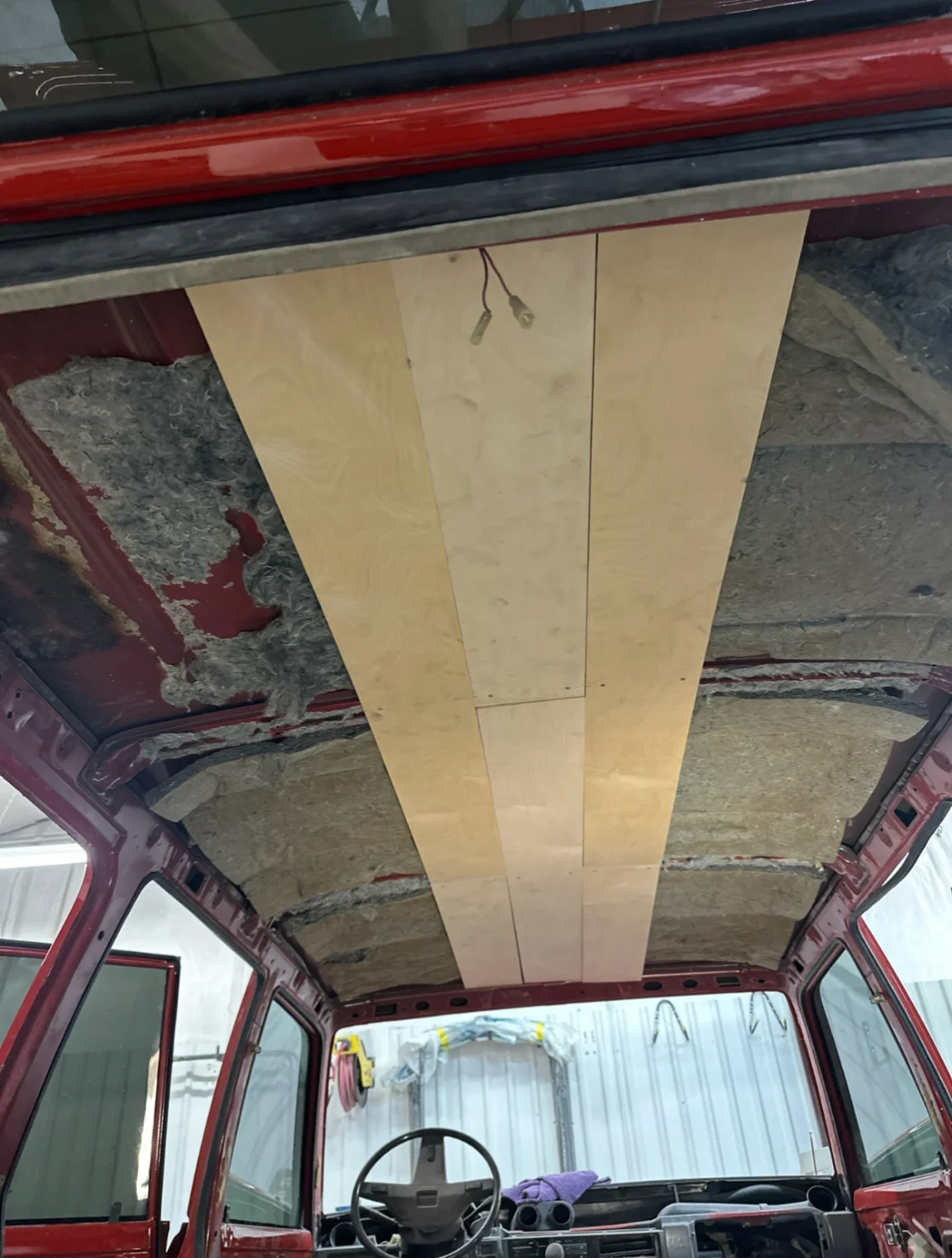

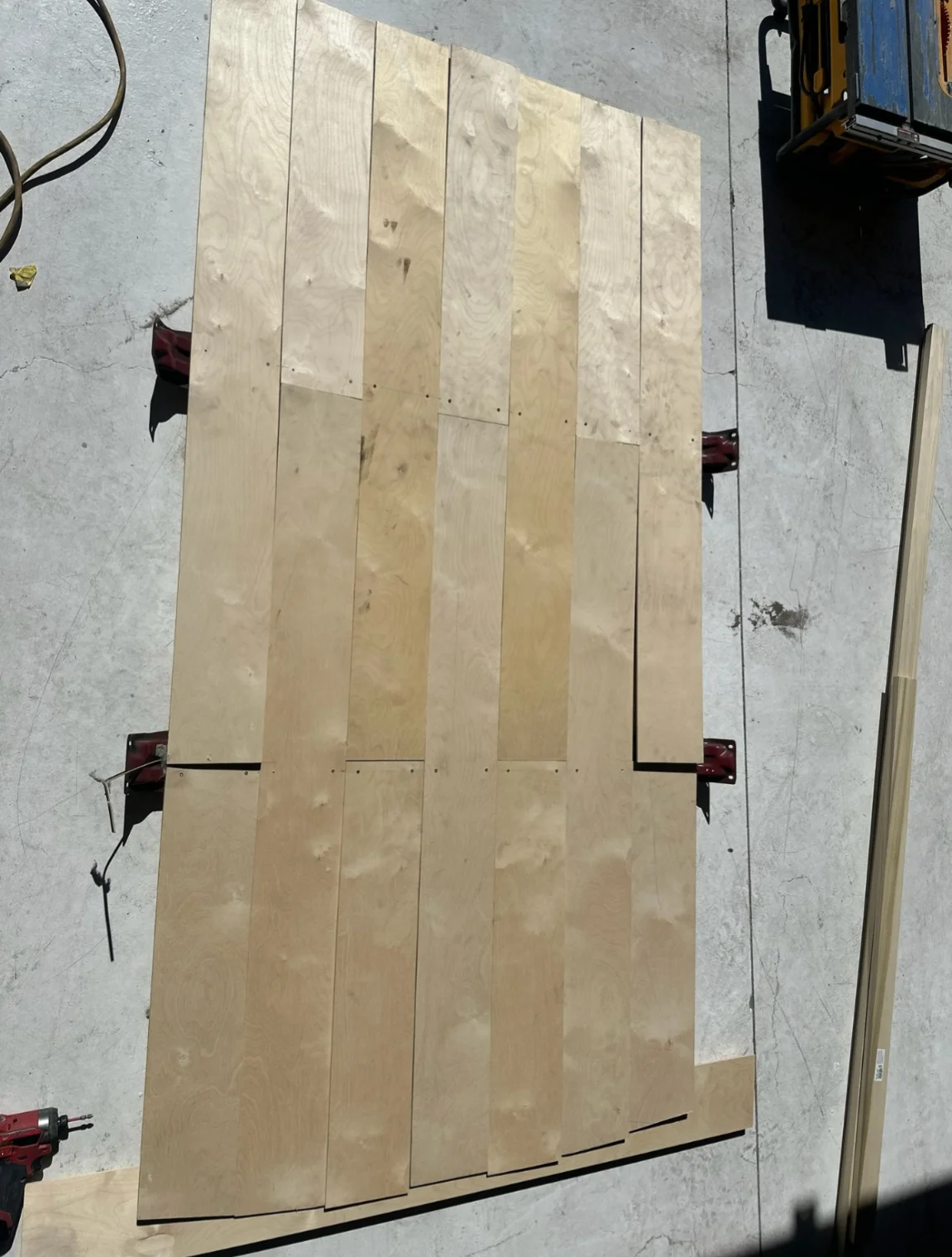

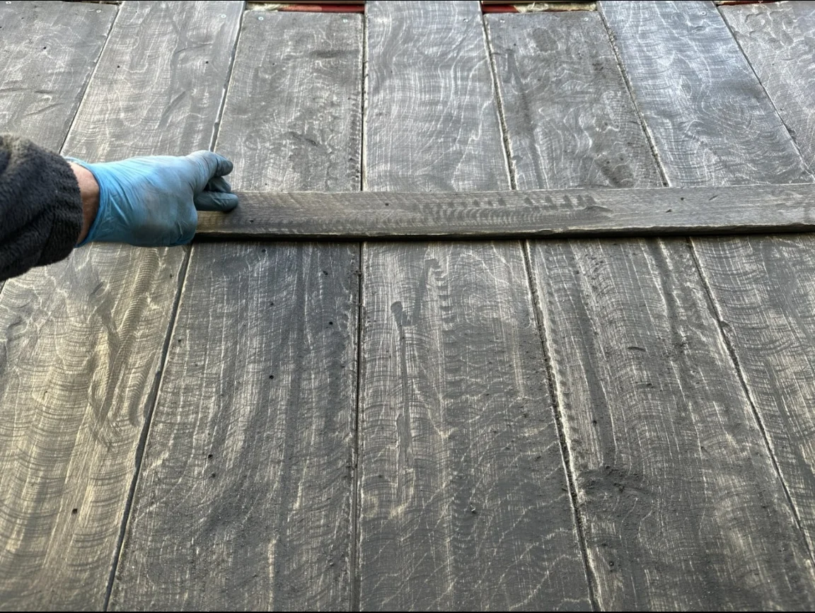

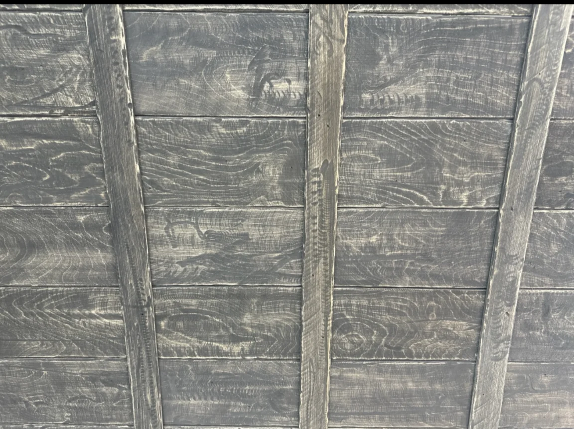

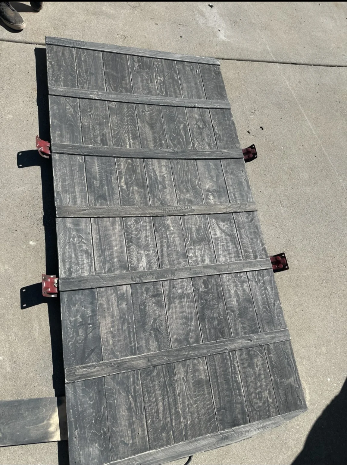

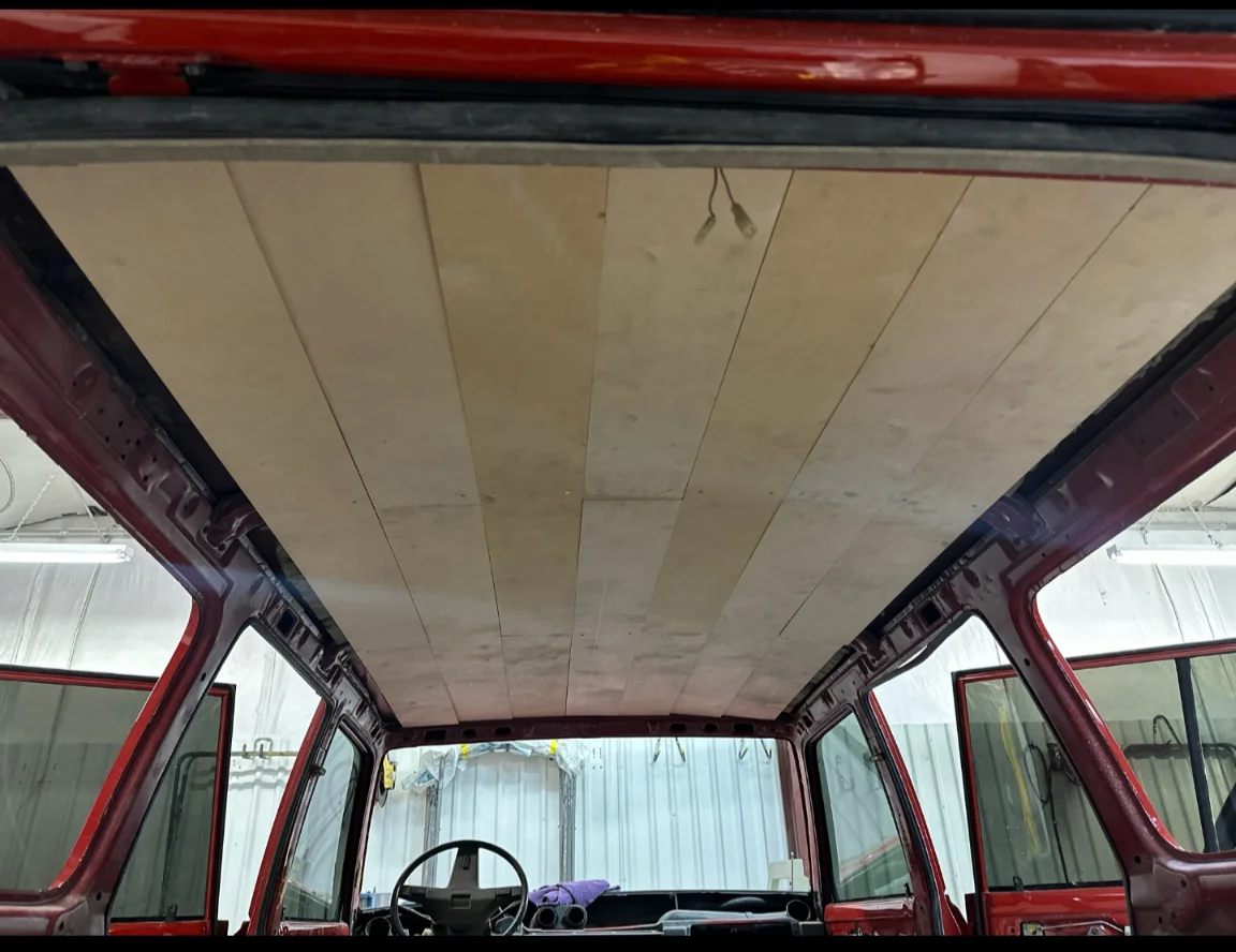

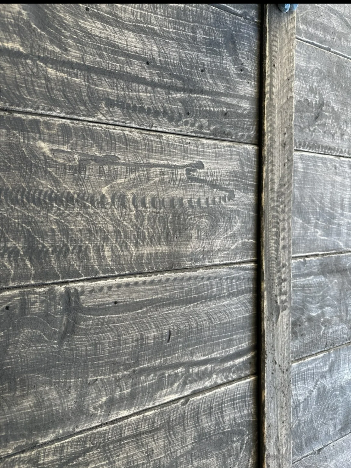

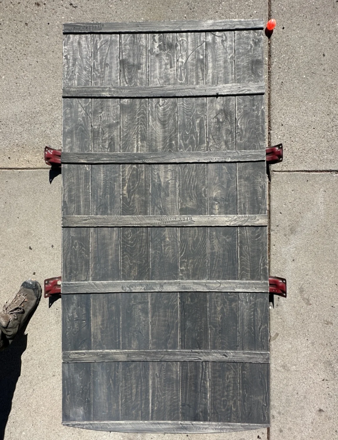

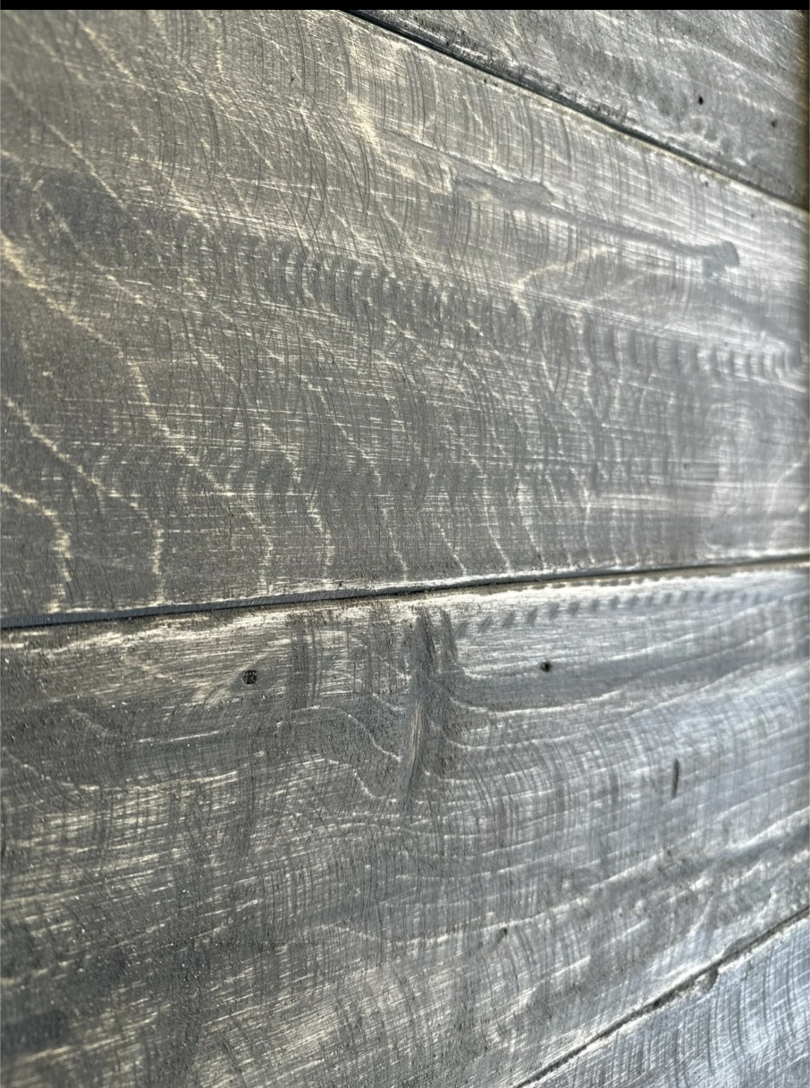

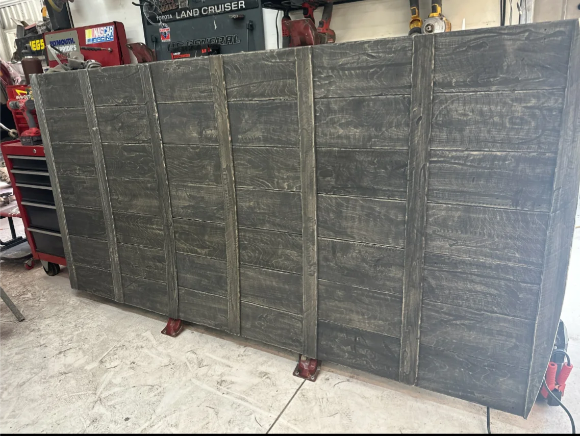

and its happppening .... Weathered grey to match the interior. #YESSSSSS!!!! #Stoked

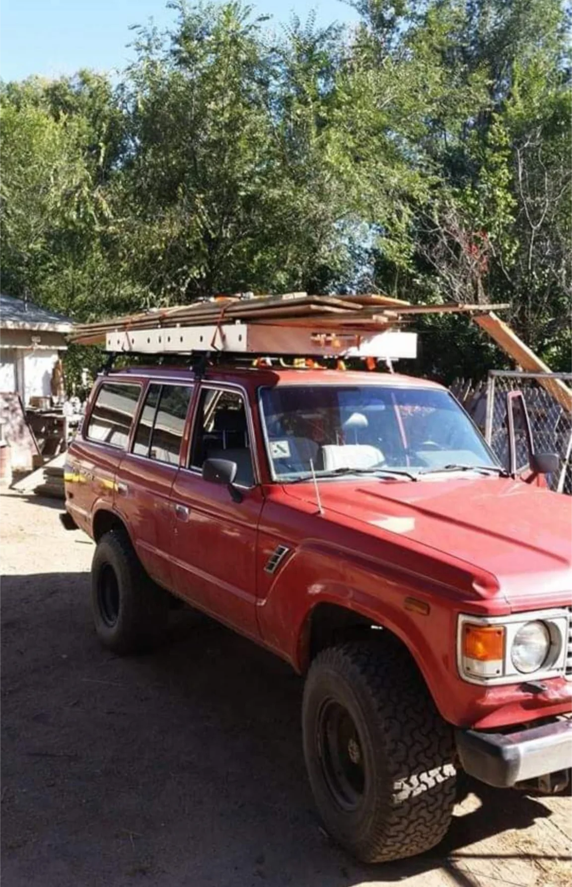

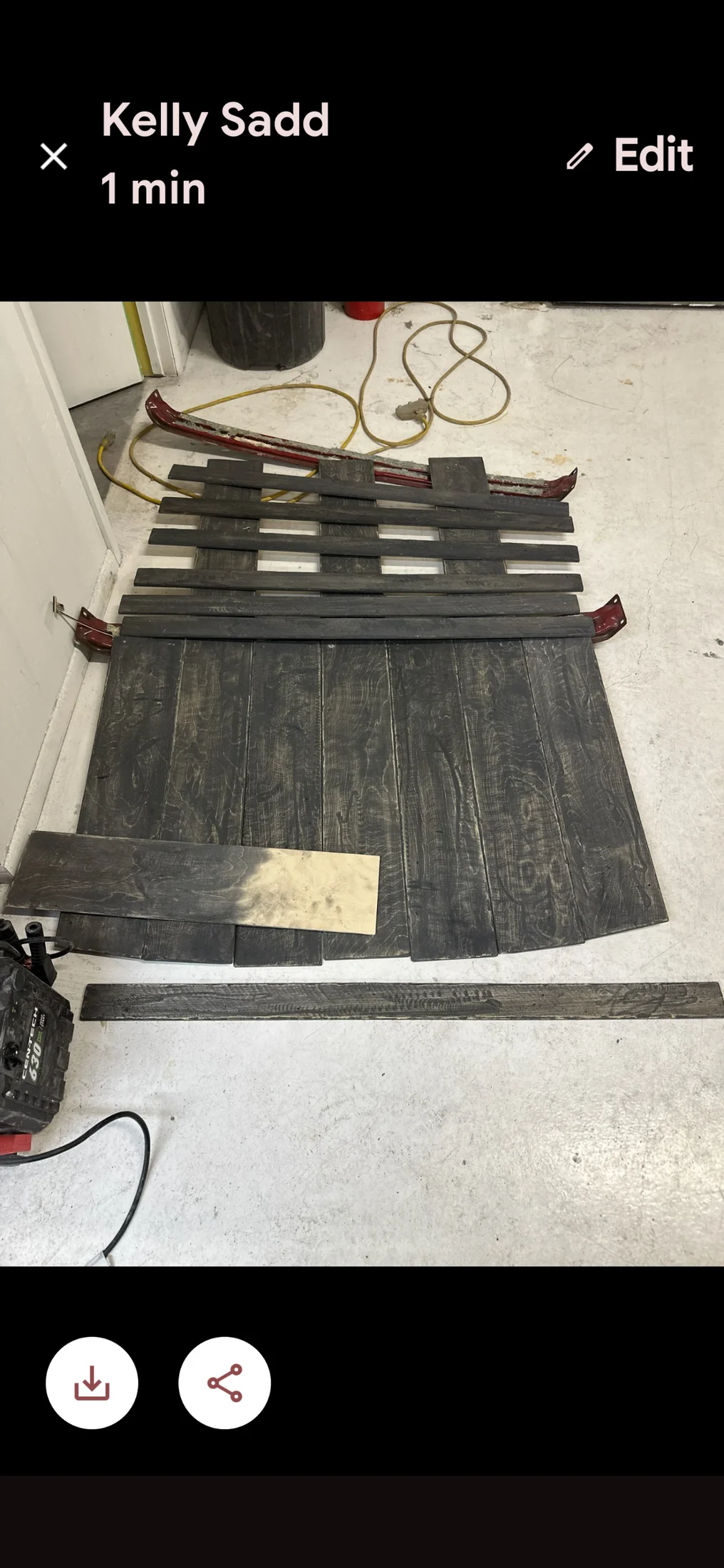

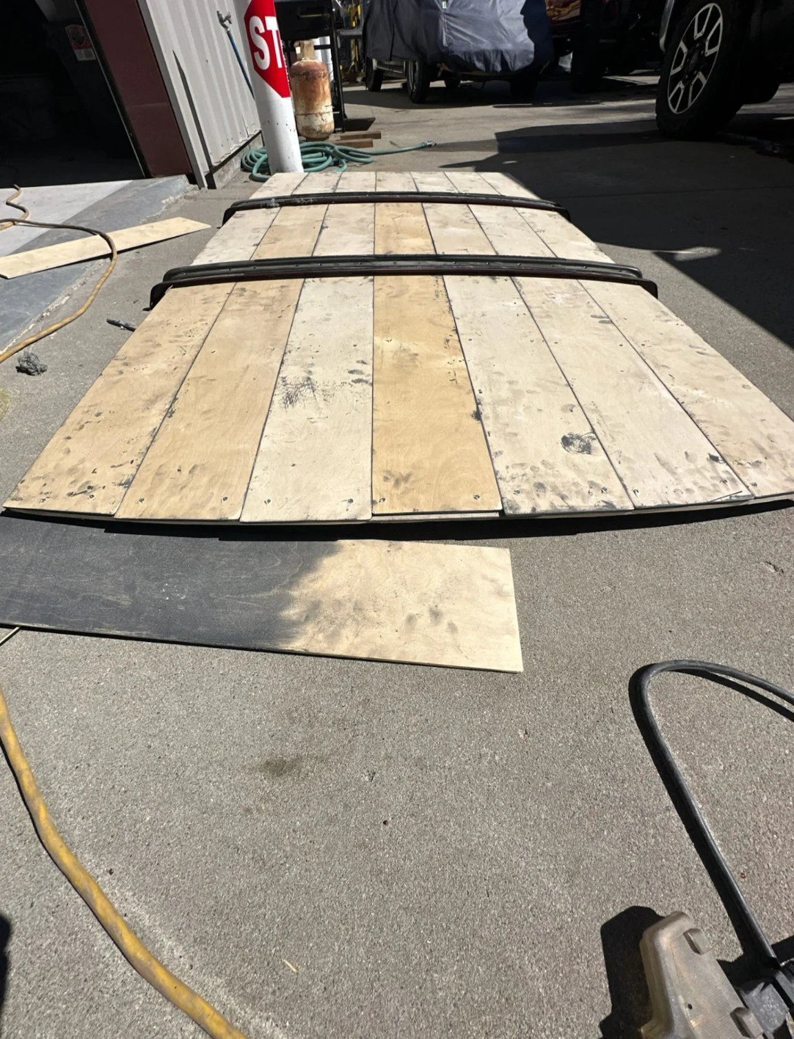

once @kelly saad told me he was a master carpenter in a previus life ..game on. My rig hauled Soooo much Lumber during the cabin rehab, i decided
it needed some Wood interior :)
once @kelly saad told me he was a master carpenter in a previus life ..game on. My rig hauled Soooo much Lumber during the cabin rehab, i decidedView attachment 3841245View attachment 3841246View attachment 3841247View attachment 3841248View attachment 3841249View attachment 3841250View attachment 3841251View attachment 3841252View attachment 3841254 it needed some Wood interior :)
Yup. You dreamt it. Barn board is a pleasant surprise.
Now THIS is interesting! I've long thought about an alternative to the headliner.
I'm hoping this turns out really nice. I'd love to ditch my ratty headliner. I used a bamboo mat in an old beetle I had and it turned out pretty cool.
Reminds me of the interior wood end caps some airstream restos have done.
Something similar to the 70 series roof would be awesome, I started a thread about it a few years ago. Can’t stand that the 60/62 headliner is integral to the window seals. The perimeter of the 60 roof line is tricky, that metal is very uneven unfinished.
Wood, bamboo, Mexican blanket…lots of creative options.
Insulation/sound deadener would be important.

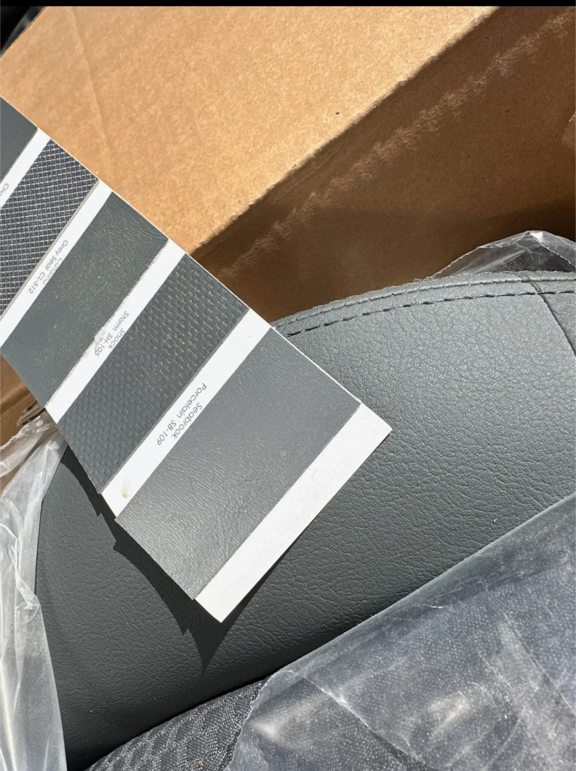

Should just buy the matching material from ScheelMann.. They sell it by the yard.
Was going to ..but @$100/yd + rush shipping it was going to be Alot more....and this Rig has bankrupted me as it is 🤣😂😭😂😭😂😭😂😭🥴
