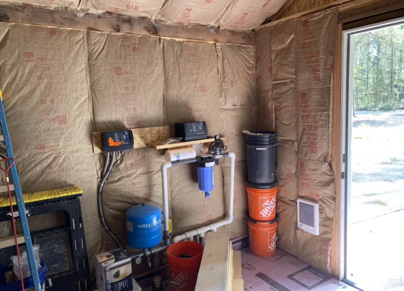

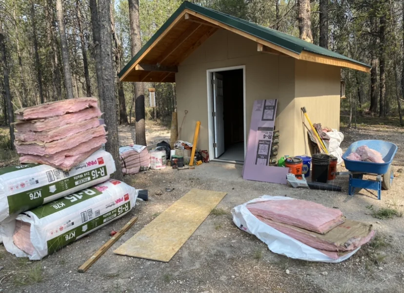

I woke up Monday morning thinking I’d finish the pine boards in the Bathhouse but then decided to start the insulation in the Pumphouse. The materials in there were starting to pile up and it was time to start.

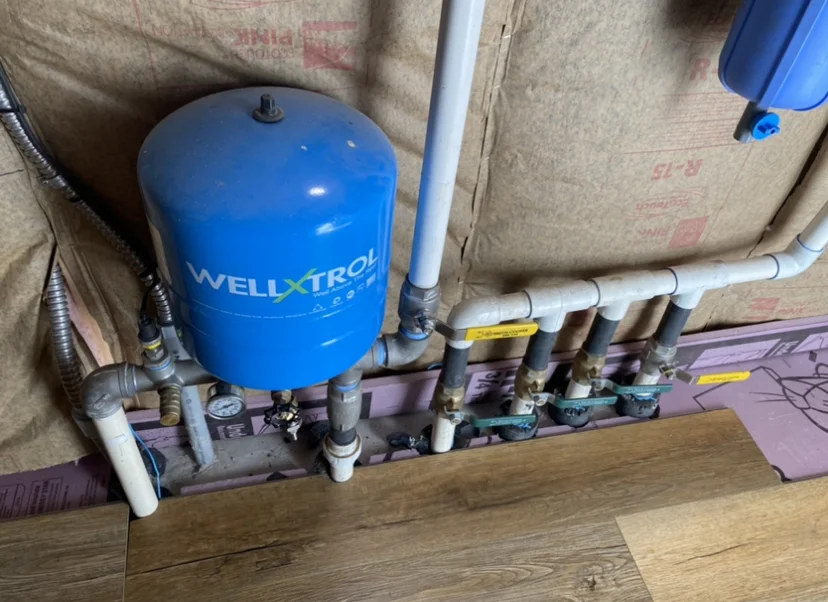

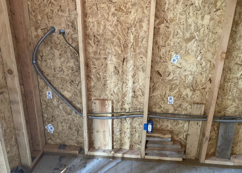

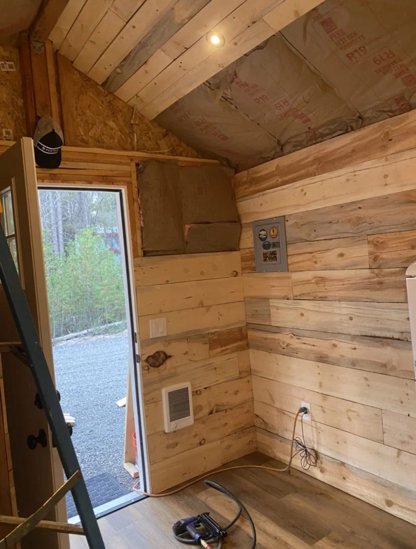

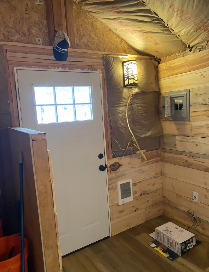

I did some more wiring and got the wall heater installed.

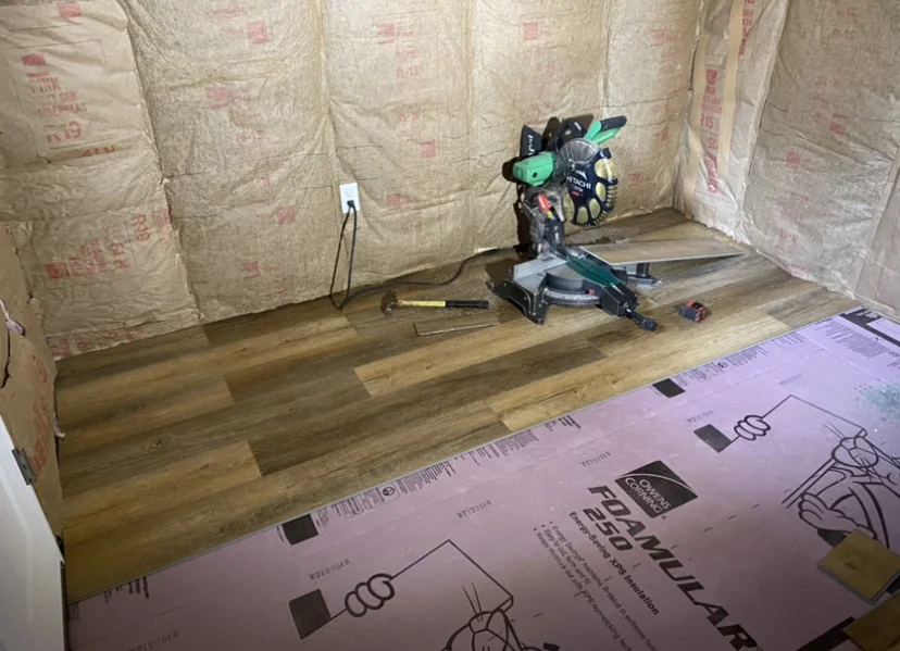

Got the 3/4” foamular foam board Liquid Nailed to the concrete and called it a day. Was going to start on laying the flooring but decided to run to K-Falls to get a 16’ utility gate, posts and concrete for the driveway entrance at Cloudcap.

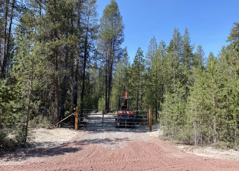

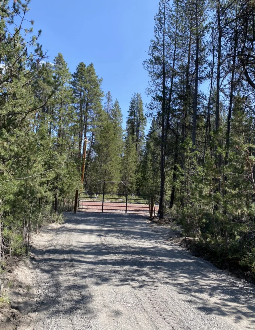

Went to Coastal Farm and Ranch and picked up the gate and posts and ran to Home Depot. While going through parking lot I saw they had the same gate but for $136 not $199. I decided to also get 6x6 PT posts from Home Depot as the round pine posts were not 6”. Home Depot was out of Quick Set concrete except for 5 bags, 4 were damaged. The guy gave me 1/2 off. Got the gate and posts and went back to Coastal and returned their gate and posts. Fueled up and headed back.

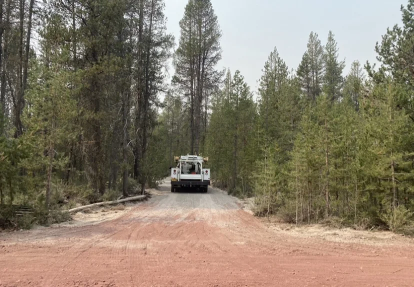

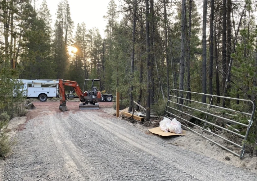

The new road at Cloudcap.

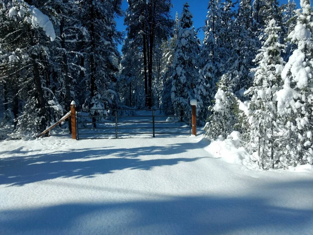

It wasn’t on my list to put up a gate but didn’t like the idea having a road on my property without one. Got up early and busted it out to try to get home later that day.

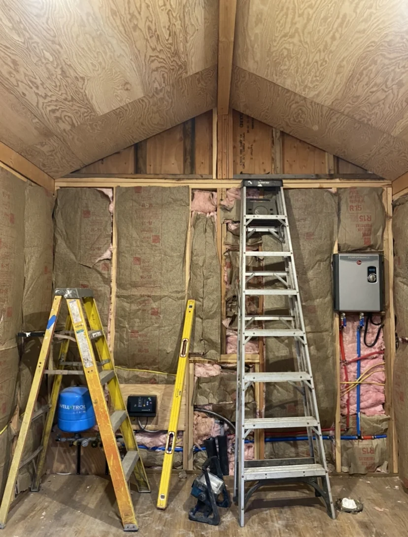

Inside Travis’s Pumphouse/ Bathhouse. Helped him get his rough sawn plywood on the ceiling.

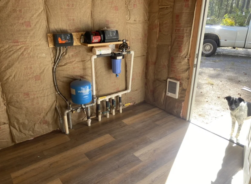

Inside my Bathhouse.

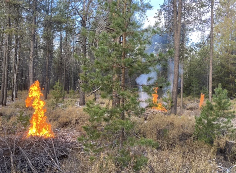

Got up and burned a few small slash piles.

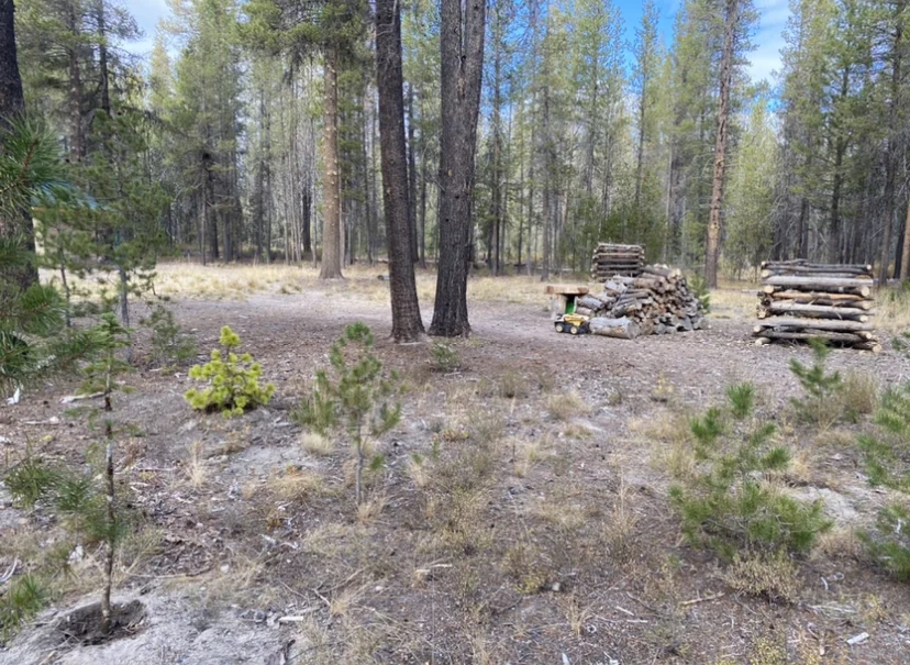

Planted the trees I brought. The bright colored trees are Chief Joseph Pines. They are a specialty tree where the needles change color in fall and winter.

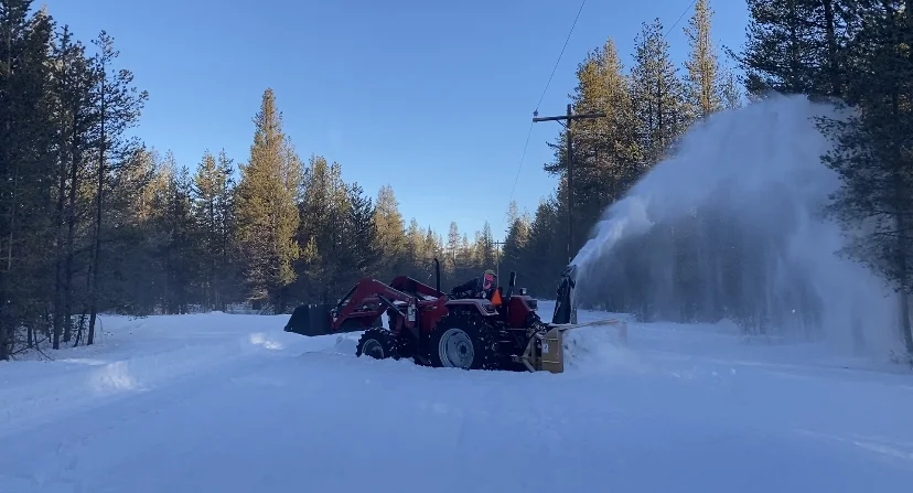

Walter plows the road from highway to his place. He’s retired and loves winter. He doesn’t hesitate to plow for us if we need him to.

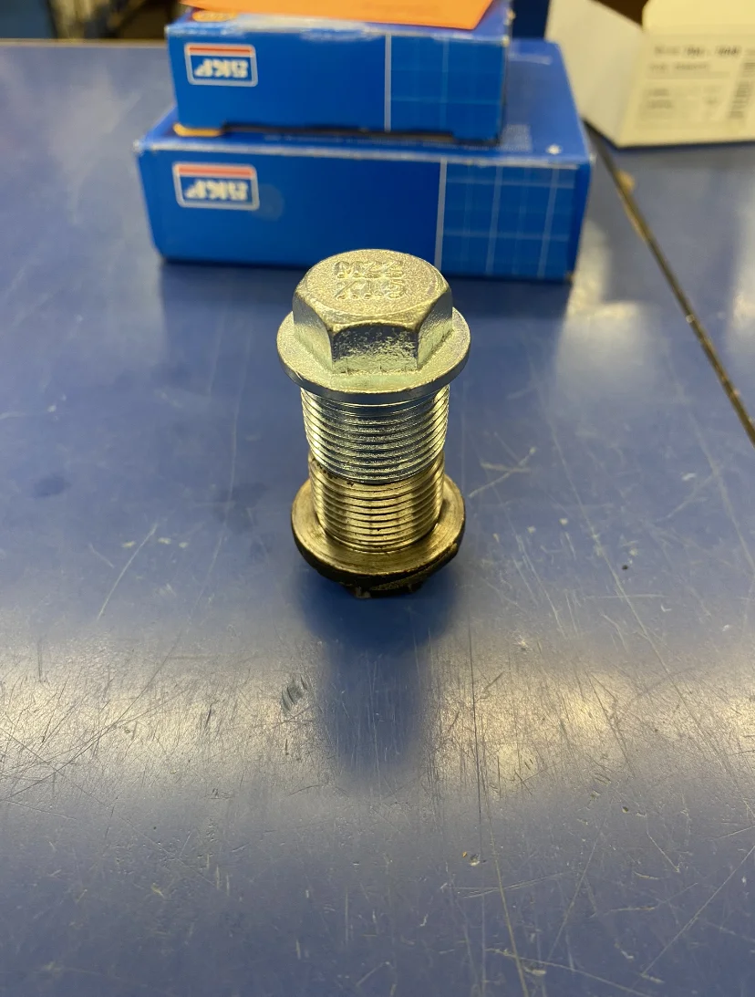

Changed the oil last weekend in my 60. Just shy of 19,000 miles on the Speedhut gauges. While changing the oil I decided to remove the side oil pan plug and see what thread size it is.
Went to Napa and confirmed it’s a M22x1.5 which is awesome because that’s the size threaded oil pan heater I found.

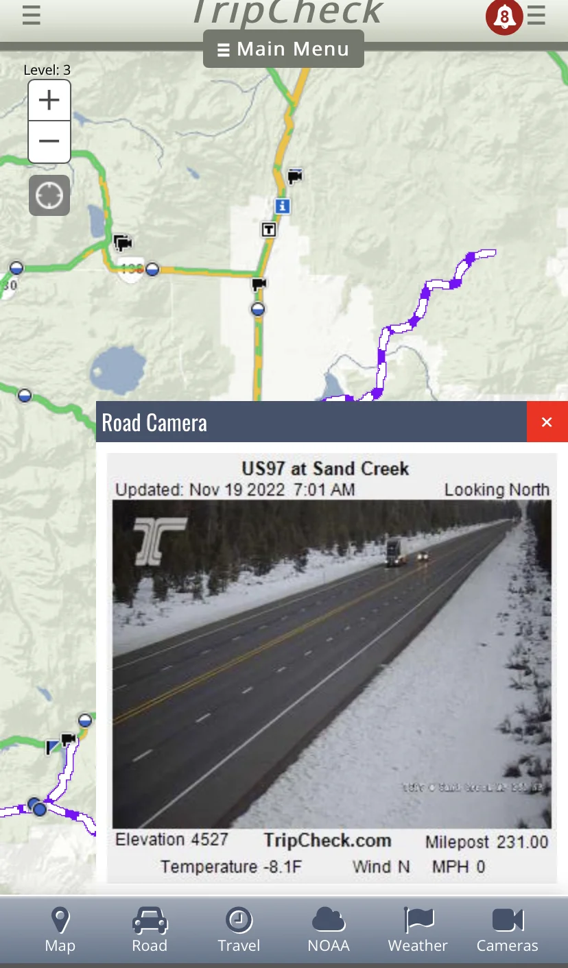

-8.1F this morning at the Crater Lake Property. This is why I want to be equipped for cold weather taking Project Snowball❄️ to the property. Now that I’ve got power I can keep the block warm with the new block heater and oil warm with the oil pan heater.

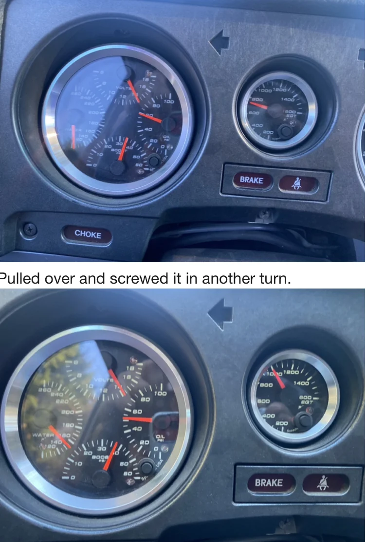

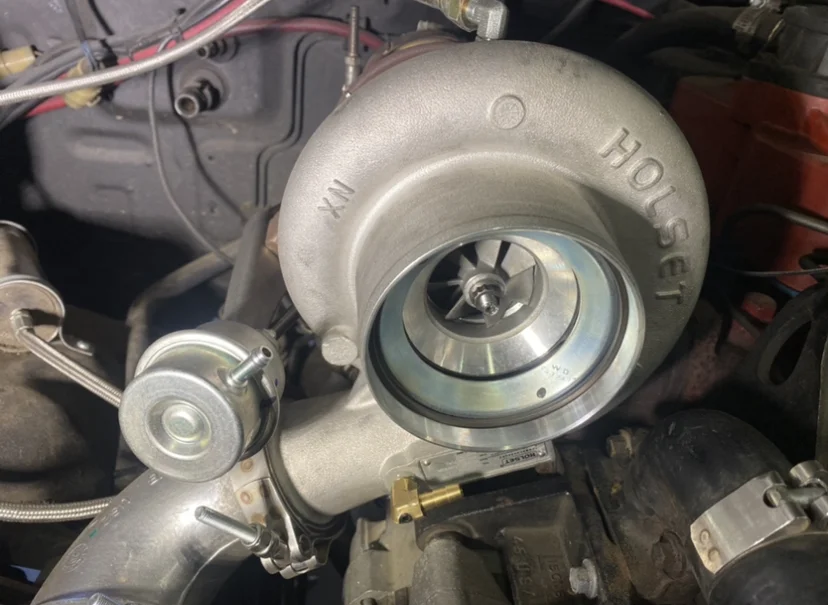

After changing the oil I decided to install the boost fooler on the HX-30 super and see just how much boost this puts out. I’ve been maxed out at 22psi. It spools super quick but at 22 psi the wastegate opens. Have been very happy with it but it’s time to turn it up.
Put a drop of blue locktite on the Allen screw as I didn’t want it to come out. I then took it for a drive home. Started with the screw about 1/2 way screwed in. Noticed an immediate difference. Up to 35psi.
38psi of boost. Not only does this turbo spool much quicker than the stock HX-30 but it produces some impressive boost! It climbs the grade home very nicely.
