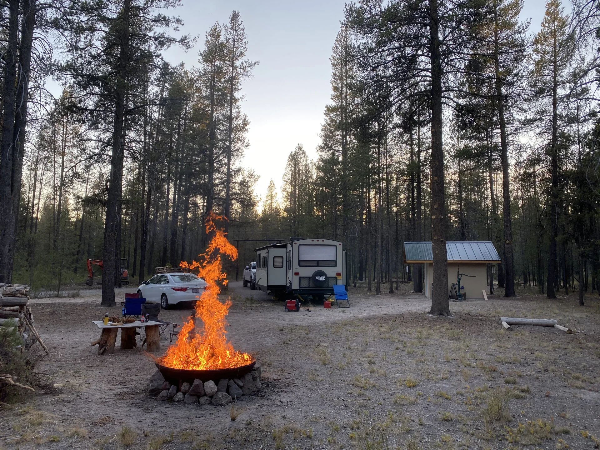

Moved camp to my lot Friday night.
My dad had to head home Saturday morning. We had breakfast then he headed out.
I moved my low point drain away from the wellhead and installed another frostproof hydrant.
What is so great about having timber on the property is always having a load to bring home.

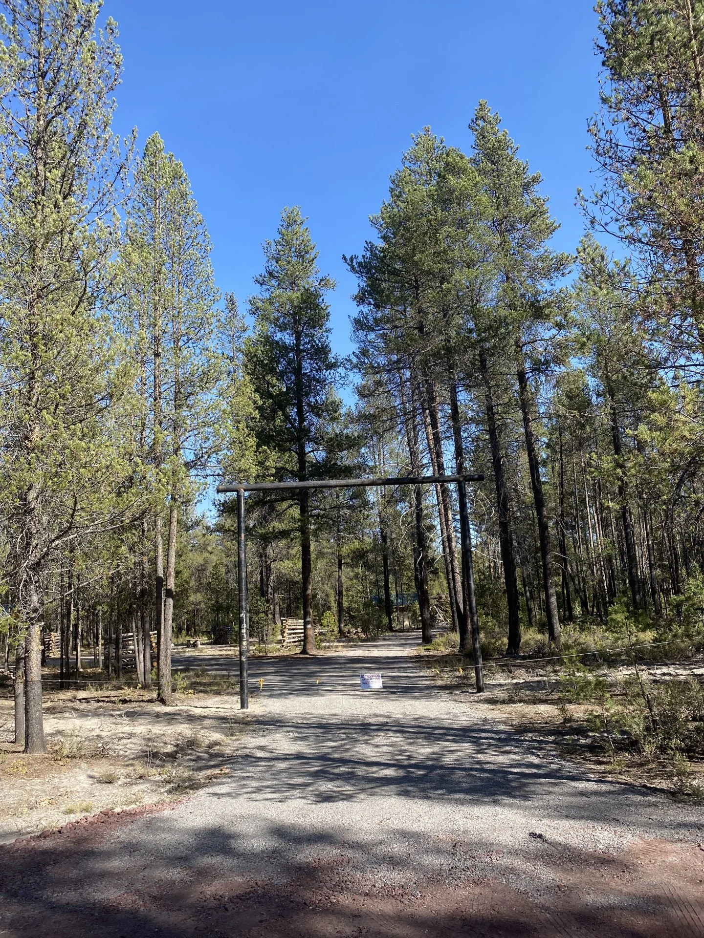

Everything on my list was accomplished. Not only that but we went and had some much needed fun. This was definitely the best trip yet. I wasn’t really sure if I’d get my ranch entrance project done. That project was not an easy one but at least it was done pretty quickly.
You’ve done an amazing amount of work on your property, and it’s looking great!
Congrats…great pics too.
When‘s the first ‘Mud event 😂
That was said with pure jealousy...
We got our property before you got yours, and you’ve already progressed further.
Edit: I love watching your progress though.

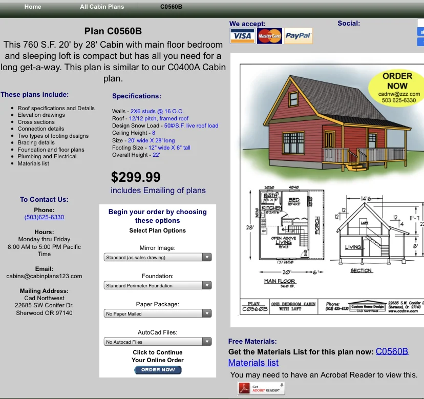

Definitely some excitement in the cabin planning phase. This Cabins123 website is pretty nice and best part is the plans are affordable and located just a 1/2 hr from my house. I get the Woodmizer sawmill in just over a week. These plans have the complete lumber & material list needed. Only info they need is the snow load. Called the county and hope to have that and choose a cabin design. Below are several my wife and I like. None have a wrap around porch like this one below but they can change any of their plans.

Check your code for allowable stair rise. It does vary sometimes by state. In idaho, I could only do 7” risers, in Virginia they have an exception to the IRC and you can do 9” - you will be amazed at the room that the stairs take up.
Add another 2’ to the base footprint, it will help ya.
Think about how you are going to add on in the future
Will the county require you to get the lumber graded off the sawmill? You gonna kiln dry it?
Yes I can use my own milled lumber. Lumber just needs to be grade stamped by a licensed grader who I’ve already been in contact with. $450 to grade stamp for a half day which is easily enough to do most houses in that time frame.
No there is no need to kiln dry the lumber.

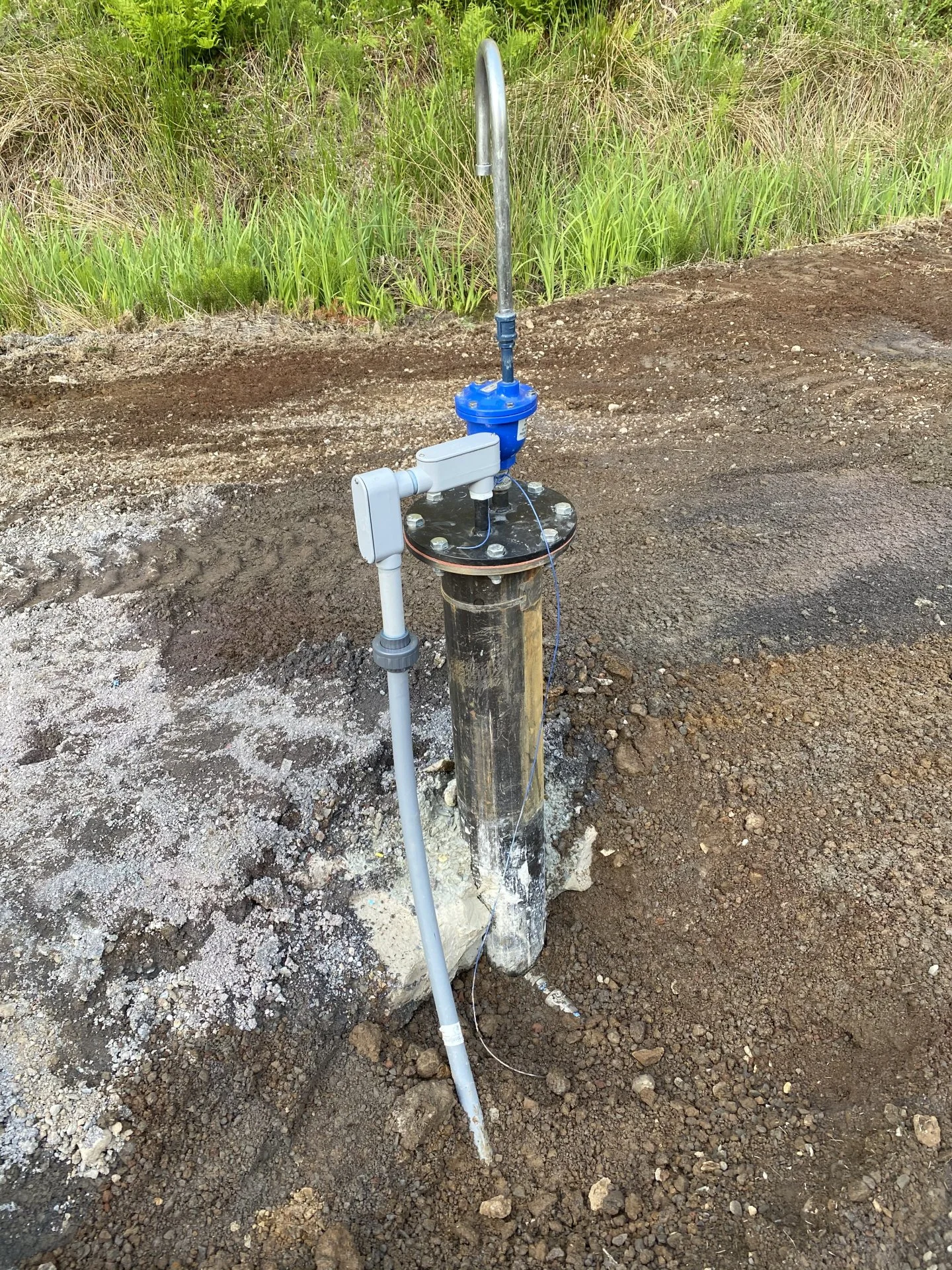

Earlier this year I installed the well system for the Oregon Department of Transportation maintenance yard because the water system was shutdown from the wildfire. Was a great drive and fun job.
