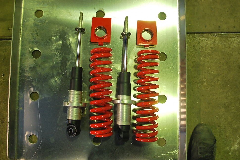

Hoser's pic explains it quite well. seems that the coilover concept is a great idea. Now I don't understand why that solution was dismissed. How could a flexy bar compete with a spring? A torsion bar doesn't inhibit the ability for the axle to droop?...seems it would. school me please.
It looks like the tube that goes down over the shock body to make the lower spring seat has a ring fixed in the top end that sits on the top of the shock body and that's what retains the bottom of the spring? The poster mentioned them being progressive rate springs and bad roads, maybe that's the problem they're disigned to fix. I'm happy with my TB's but I think that's a very clever idea.

Let me introduce you V2 on photos below.
I would like to response some of you as well:
Also if that is a stock 100 shock or not.
I don't see the issue with torsion bars and I don't see the benefit of this, other than that is a novel idea and the poster might not have access to new torsin bars so this is easier for them.
Yes, this is stock shocks. Guys, our goal is to have a vehicle that fits a deep mud and 500 miles asphalt driving at the same time. Russian roads are dam long and different quality. For example, user did pull off ARB torsion and replaced with our springs and now enjoying his 100. So we are going to tweak original Toyota design to make that lovely 100 even better under any condition.

No worries, that has been used for 3 years. All our 100's are heavy loaded, diesel engines, dual batteries. Even stock, they weigh more that gasoline vehicles.

What about 200oUZJ's idea of using your coil over set up with the smaller LX T Bars? Would this be too much, or a nice combo for bearing the load. What is th price of your set up by the way? Is the travel the same as stock with your setup. Would it benefit from after market control arms?

So what's the point of these, other than being different? Just wondering.

LX T bars are odd there, in our opinion. Everything runs just fine.
I am not about to discuss price yet (as well as any sale), I am there for the true engineering talks.
Yes vertical travel is good point. Answer is yes, we make stock. However, we can make custom coil lenght for lifted configs.
Point is to tweak our lovely 100's so they can drive long asphalt distances with maximum comfort, and fight heavy Russian mud as well at the same time. Torsion bars are good, but about 50 our happy users aren't in rush to put TB back.
