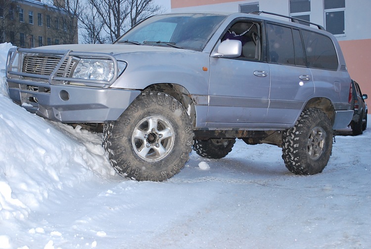

Front suspension tarvel increased by 2"-2,5", though we don't think this is significant. That was not our goal to increase vertical travel. Below is a photo of 100VX, with our engineered 150 liters extra fuel tank, own design bumpers, sliders, and 2,5" original body lift. Stock 16x8" disk, 36x13,5" SuperSwamper tyres, 4,2l TD. We did install 35 mm washers under the wheel disk, and done minor body changes.

So we decided to make next version of 4" lift, using rotary shaft enlargement. Also we done dual spring to make suspension working fine on small bumps, as well as on heavy shocks. We used TLC-200 absorbers this time, to make sure no failures at that part anymore. As always, a few pics and video describing our TLC-100 game. Once tests complete, we make a kit and send to Pfran42 as agreed before.
Welcome to comment the new beta-version tweak of TLC-100VX - a 4" 37 wheel lift:
More detail you can see on this video, engine details at 11:00, true speed tests at 5:10 and 6:40:
Sure thing, a drop box has been added. Here you go:
That is truly outstanding. You have done the impossible! I never thought I would see anything like that under a 100. The bracket looks like it drops the front differential, steering rack, and CV's. How far is the drop bracket?
PS- I see a HID retrofit, any details on that?
so now the diff is lower and so are the arms...that will add more travel? how is that? looks like if it actually can do what is supposed to, it would be pretty much plug and play if they were selling that drop box contraption...
Drop Box. Nice ring to it.
This looks like a 4" drop to add 2" of tire size, (35" to 37") am I missing something?
I would think with the drop box, you could increase up travel? With different shock of course
