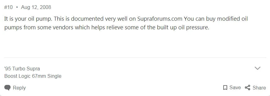

Got a call from the dealer and they tell me its the oil pump. $2800 to repair!

I see postings about blown crank seals on a Lexus forum. Too much crankcase pressure.
I've seen this on other Japanese engines from blocked crankcase ventilation vacuum allowing pressure to build up and blow main seals. Just looking for a way to solve more economically.
I have never heard of an oil pump failure on the 2UZ.
Too much crank case pressure? PCV is clogged.
Yep.. I would try that first. Inexpensive part.
Now the dealer has it all torn down and maybe looking for a way to recover costs..
Dealer says they are replacing all the seals not the oil pump. But apparently there are two oil pans and the pump sits between them which is why its labor intensive and the cost is high.
No, the pump is on the bottom front of the engine. It is what your front crank (main) seal sits in. It is somewhat of a $hitty job to do because the oil pans have to be removed, which often requires pulling the engine out...
