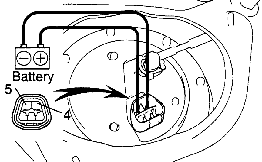

I have no fuel at the fuel filter, no power to the fuel pump on the top two connectors at the pump when cranking. When the pump is direct-wired from battery the truck starts for 1-5 seconds then stalls . I have 1.5 volts on the top right (ground) w/ ignition on, nothing while cranking. Which is slightly weird. No continuity to ground on top right when cranking. No continutity on either of the top two wires to any contact on the ECD plug (actually I get 445 to 1500 ohms resistance on one contact at pump, no continuity on the other).
Fuel pump connection image attached from the public library Auto Repair online system.

New fuel pump. Both old and new pump test ok at 1.5 ohms and both work when given 12 V direct power. Old one is out of truck, new one tested in truck (runs for 1-5 seconds, sputters and dies when hot wired).

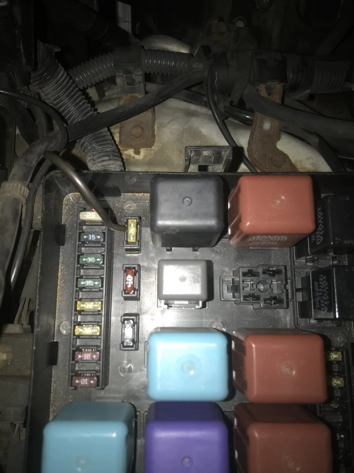

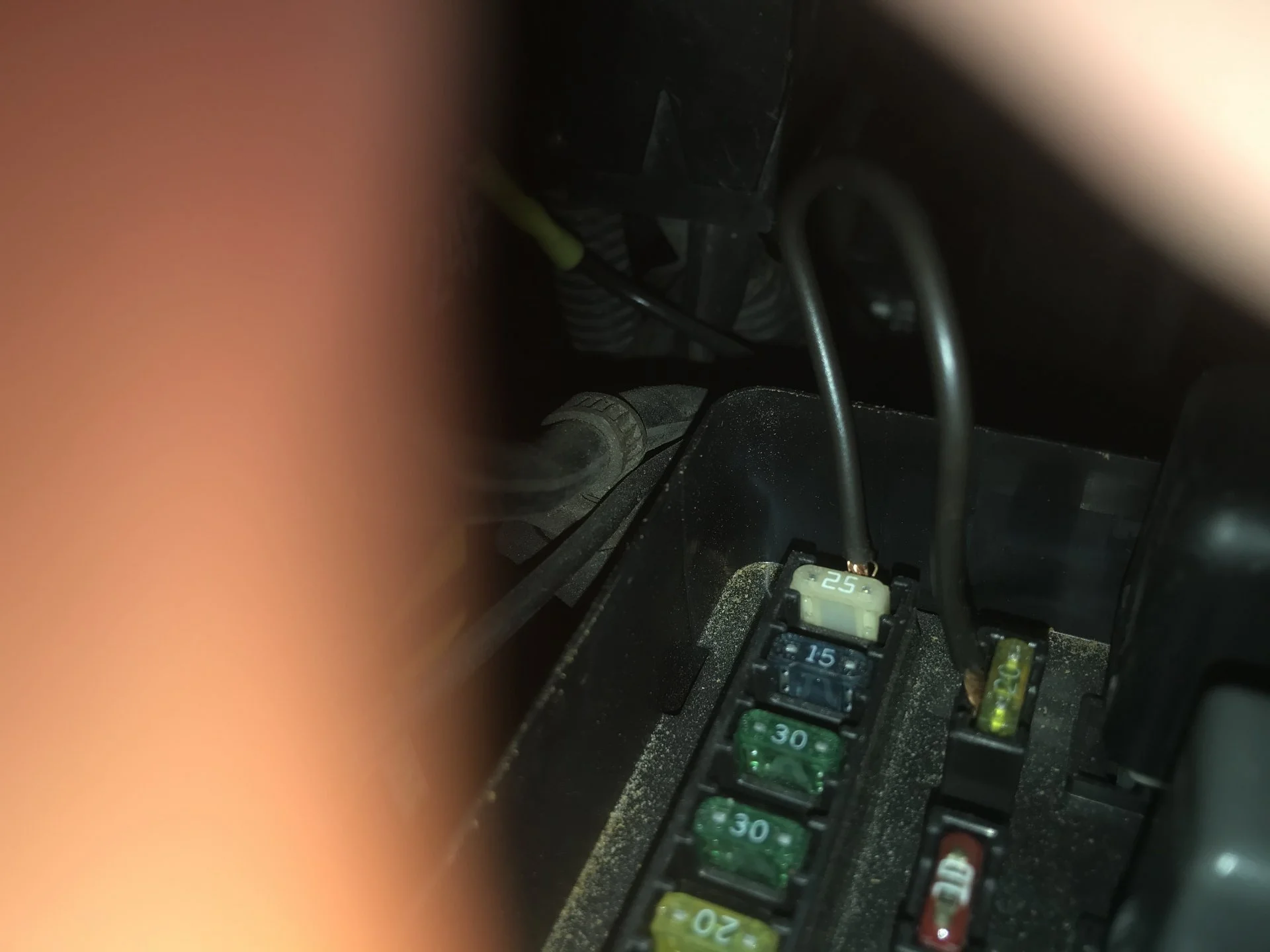

The fuse boxes after time become quite finicky. Mine came with this wire. It does not start without it.

So the old fuel pump works and has the correct 1.5 ohms resistance, so it was not fried. I had trouble getting a ground on the fuel pump harness, though.
Anyone know if there should be a constant ground to the fuel pump, or is it switched or controlled by the ECU?
