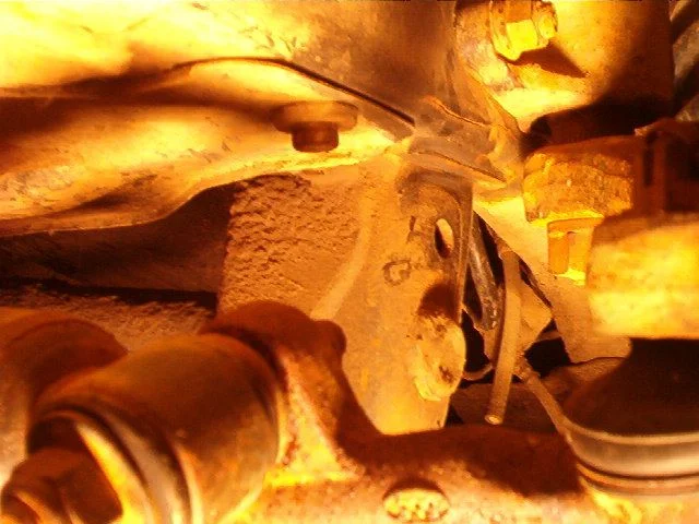

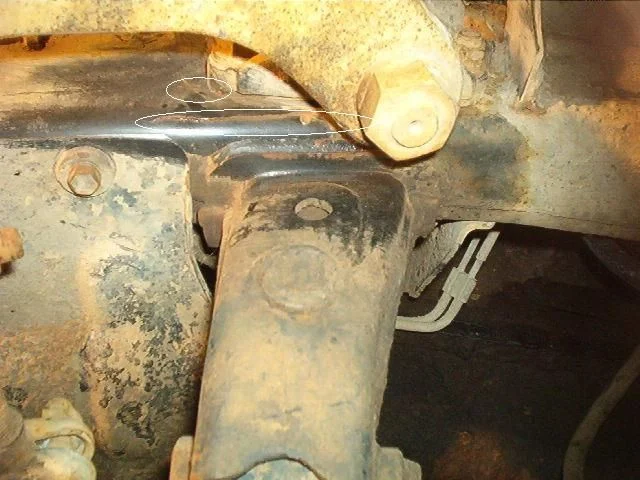

I found a crack on the frame rail between the steering box and the drag link mount, about 2.5 inches long. I haven't driven the truck in 3 years and don't know when I did this. Now I'm rebuilding my 80 and found this... I hope my parts truck has a straight frame!

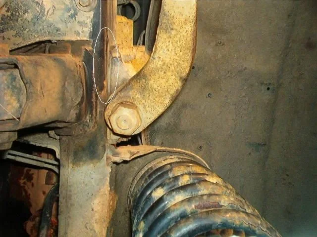

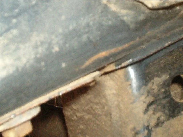

Jon, there is a small crack coming from the lower left steeringbox bolt hole, but the big crack is on the under side of the frame kinda like the stress is from the drag link mount:cheers:
Can you get a few more pics from a bit further away, just to make it easier to identify the exact location relative to the steering box etc?
