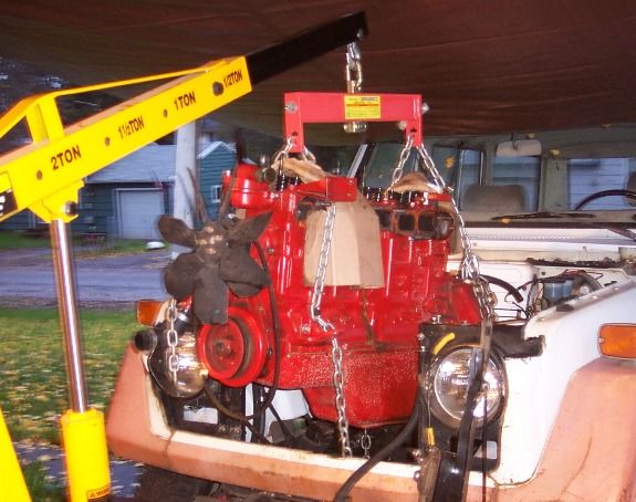

Clearance for performing stitch op.
As the picture shows, it is a tough go for drilling and tapping in the engine bay. Removal of the steering box and inside fender a consideration. Using an air powered 90 deg head drill and stub drills maybe but, risky, hard to drill and tap straight without a straight shot. So out she comes.
I think you're wise to pull it. Get that water jacket clean and dry first, too.
You've got that boom waythefxxx out there!!! Be careful.:eek::eek:

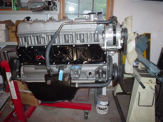

Paint it real pretty.......like this!
What brand band saw you got there Ed?
Dunno......shindawoo, Pingtong, MooShoo? The best Cummins has to offer! Actually, with a little setup, it has done a fine job for my hack-rication;)
Now that's real nice Ed, Like the contrast. Sharp eye there grant but that theres a drop saw migaw. Anyways, Ed, next time you take pictures of your engine paint job, hide the latex house paint can. And nice shot into the cylinder heads, good ABUNDANT overspray into the combustion chamber. I myself use old spark plugs there feller been. Too each, their own.
