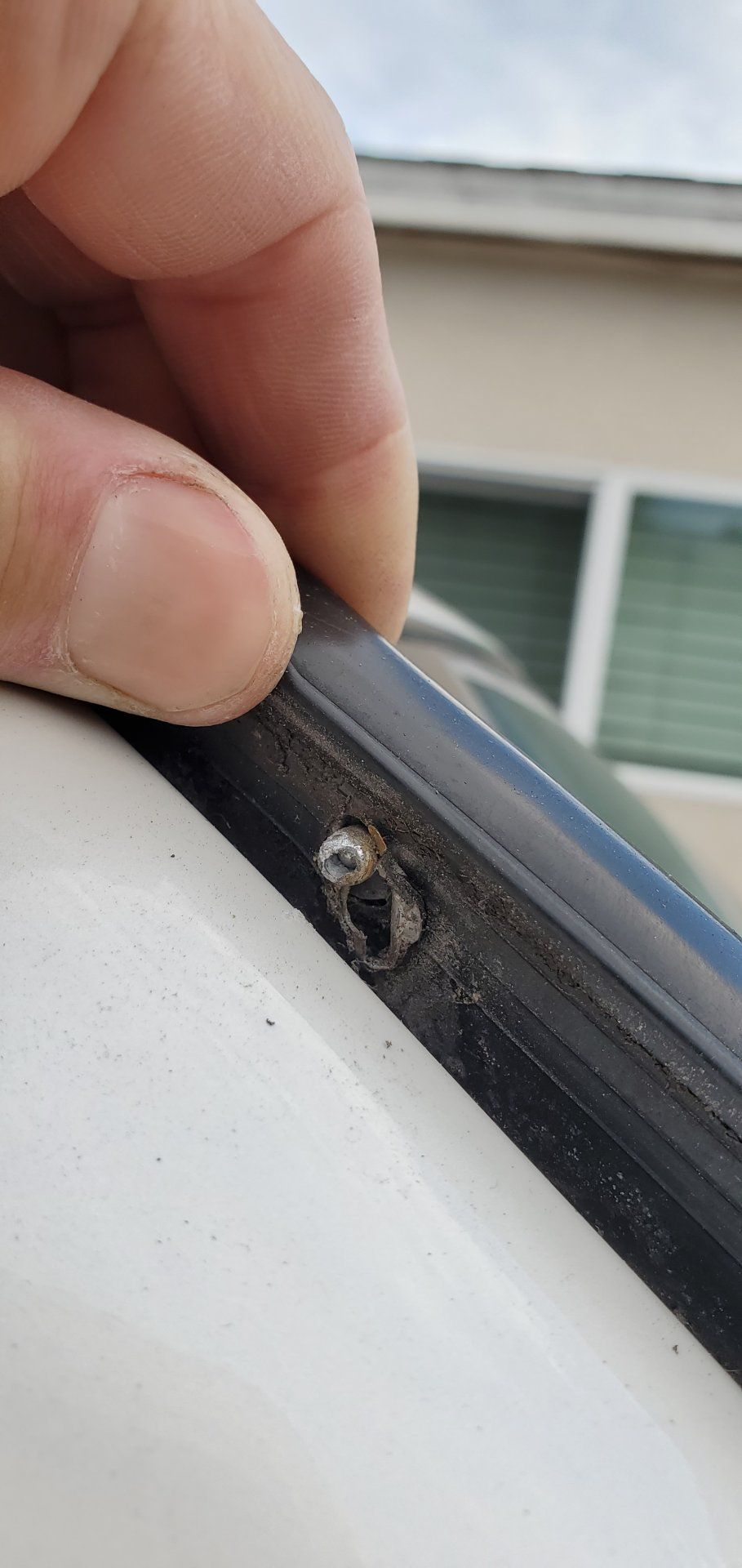

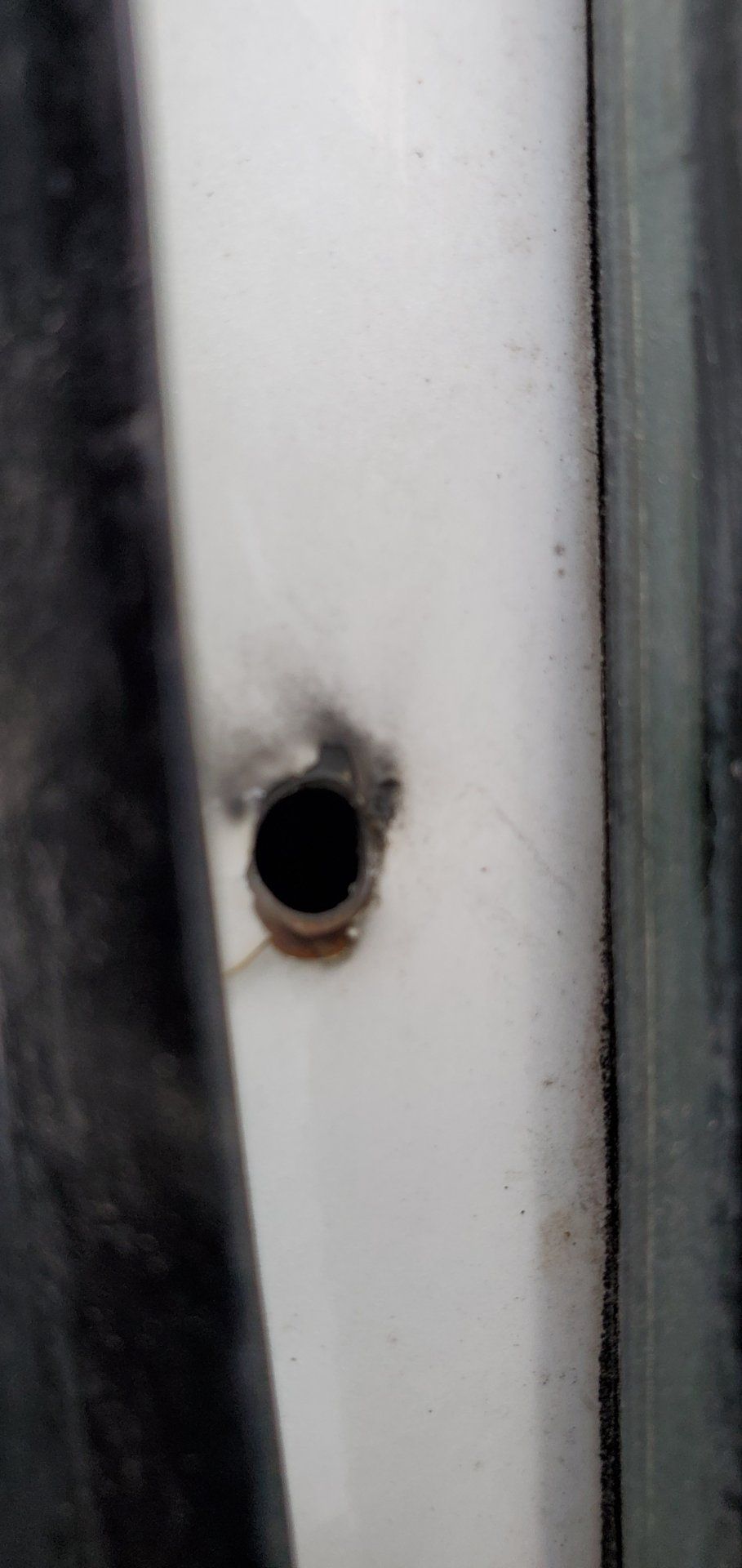

I had the front windshield tinted and I long story short I have significantly more wind noise on passenger side. I pulled the molding and none of the rivets are connected but the molding was no secured with screws either. I plan on Re-riveting myself - does it look like these are the normal size holes and haven't been altered? The driver side seems to have 3 of 4 rivets in place - only judging that based on the molding which is firmly in place from top down (near engine bay is loose). The passenger side molding was super loose and moves easily with light pressure applied.
That rivet hole does not look factory. Appears it's been worn out and the paint removed. The trim in the second picture is in rough shape and the rivet head looks completely trashed. Granted, that 2nd pic is a weird angle. I can't really tell what we're looking at.
The OEM holes should be perfectly round with no cracked paint or surface corrosion showing. The trim should have neat circular holes. The rivet should have a center pin and then a flattened, circular head which pinches down onto the trim.
Ok snagged some new pics. With the exception of one of the holes on the a pillar they all look to be in good shape. Ordered a rivet gun and waiting on rivets
^ Looks like you have some prep work to do to keep the cancer from settling in and spreading.

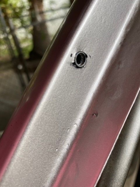

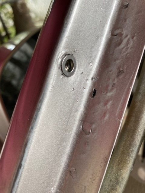

I struggled with additional water leaks even after replacing the windshield and ensuring the side moldings were properly secured with rivets. Ended up having the windshield pulled and took the opportunity to do a mod that another forum member had mentioned but never ended up doing to my knowledge. I installed rivet nuts in the oversized holes. To ensure a water tight seal I used some 3M marine sealant around the rivet nuts when installing, then used thread sealant on the bolts and made a butyl "o-ring" between the trim and body. No more leaks and no wind noise! The best part is it will make removing and installing future windshields much easier, which unfortunately I have to do again since I just got a large crack.
