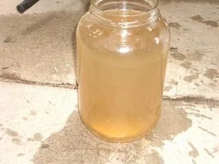

Alrighty then. I didn't get to changing my wife's PHH today. I decided to flish until clean before changing out the hoses.
In the AM I'm picking up some more hose clamps. I counted and I'm short of the big ones to do the main hoses.
I didn't think to snap a picture of the stuff I drained out first. Suffice it to say it was blackish brown and could stop the sun from shining through my jar. Think twice as many shades darker than my first flush as my first flush is from my second. Now I'm kicking myself for not getting a pic of it because it would have ben an exclamation point on how bad this was. My wife and I have had this truck 4 months now. When we got it I checked to make sure there was fluid in the radiator but didn't pour any out to check it out. It was spring and I knew I would be doing the PHH on it before winter.

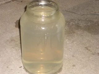

If the pics load right, left to right is flushes 1-3 of the 5 flushes I did with tap water.
Next message will have the old and new thermostats and flushes 1 and 3 with distilled water. I also have a few questions.
1. Any guesses what the PO put in this thing to get this :censor: brown color?

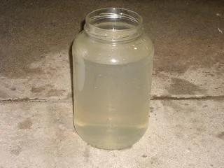

2. Did I flush it enough times (8 total) and is it clean enough now? I've gone through 10 gallons of distilled.

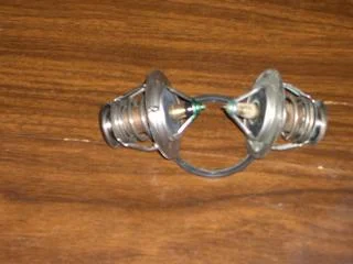

Thermostat & first and third distiled flushes
So, my local stealership sold me the thermostat on the left. I pulled out the one on the right. The only difference I could see was that the new one had a rubber bit on the pointy side. I'm assuming that this was a change Mr. Toyota did for a reason. What that reason is eludes me. The old gasket had square shoulders. The new one had rounded shoulders.
Was the one I pulled likely the factory one from 1996?
Also, distilled 1 and 3. Did I flush enough or should I keep going to try to see it crystal clear?
