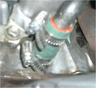

Old - New

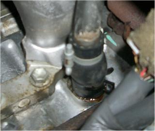

Right arm is raw from the fender well sheet metal. Started 7:00 PM. Ended 10:00 PM. My first one took me 6 hours. This one took me 3 hours. I'm getting better at it. I fought with the lower bolt trying to loosen it for nearly an hour and a half. I ended up putting a 1/4" drive craftsman driver on it with a shorty el-cheapo socket. Then I used my Craftsman ratcheting end wrench braced against the wheel well as a lever against the ratchet. It turned instantly.
You'll notice in the picture that the old hose was weeping at the block. I got to changing this none too soon. When I was removing the hose it tore in my fingers. The threads inside the hose were rotted. It was a ticking time bomb.
I'm tired. My wife is driving my grey truck tomorrow and I'll continue the collant change on her truck after work. Flush is done. PHH is DONE! Time for a very stiff drink and a shower.
