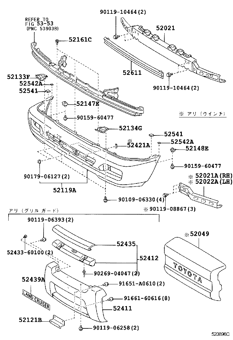

I know it's purely cosmetic, but does anyone know if I can add the winch cover to the stock US bumper? I think I found it here
You can, mine had the winch bumper and the winch cover before someone crashed into me and it was replaced by a non winch bumper but still had the cover. I recently figured this out after I took the cover off.
Thanks! How does it attach?
With two screws that attach the straps on the cover to the bottom of the bumper, you just undo the straps and lift it up to clear the plastic tabs that go into 2 slots on top of the bumper (the top of the bumper needs to be cut to fit the tabs). the two screws do not need to be undone to remove or attach the cover.
