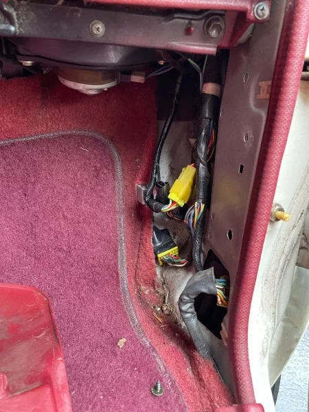

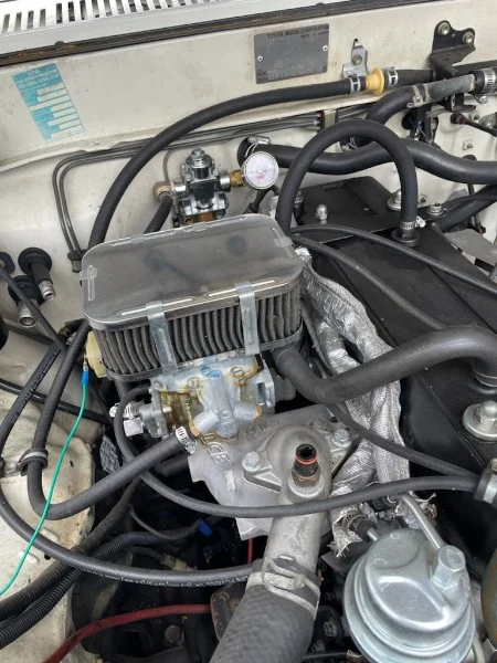

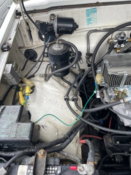

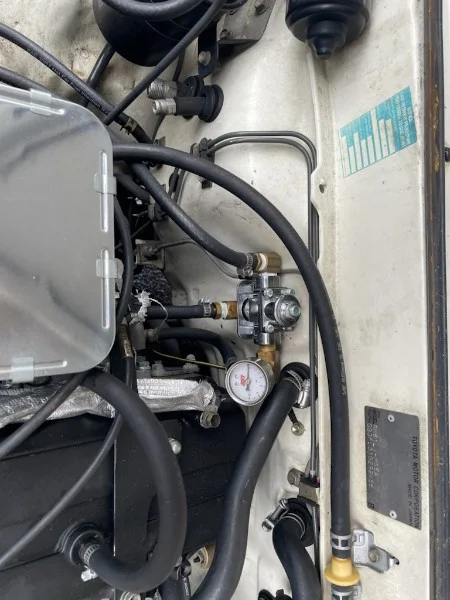

Yes, you read that right. I am considering purchasing a 1987 4Runner that two owners previous to me converted to a Weber carb. I am assuming he used the LCE kit since it also has an LCE carb intake manifold.
The plugs for the ECU are still underneath the kick plate but aside from that I am not sure what is present and what is not.

I know some people would prefer the carb but I would prefer for it to be original EFI. Aside from this, the truck is solid. Any input on the cost/complexity to convert back to all OEM EFI would be appreciated.

Looks like you would need the engine bay harness and ECM. Best I can tell they likely trimmed the engine bay harness.
Then probably an EFI upper/lower intake + throttle body + air flow meter. Fuel injectors.
On the 22re computer there are 3 separate plugs that plug into it. If I recall correctly, 1 is off the body harness.(the harness that runs inside the cab) and 2 off the engine harness that comes in through the firewall port.
Thats about where I would start with thinking of the swap.
What it will come down to is how hacked the dash/cowl harness is. If they cut off plugs to make this work then you would need to source those to hook up the engine harness, and the ecu.
