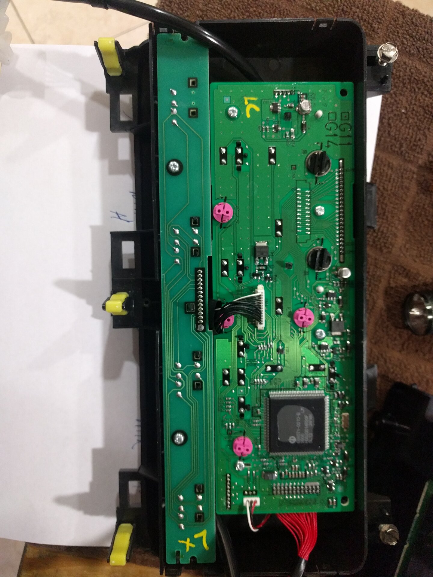

Just got an 07 HDFTE GCC spec a/t gated VX trim with that actual panel look.
however my climate control panel specifically the temperature control can't be adjusted. also lights are too dim.
any leads where I can source parts?
Thanks!
you probably need a new heater integration circuit board for knob control, and new bulbs. LED on later units, not on early units.
Check the white connector with red black and white wires to the knob, bottom of pic. The red and black round things are bulbs. There's 2 or 3 different parts involved. Main circuit board is
probably 84014-60190, like this ebay link ebay.com/itm/185674430455
could also be the plastic housing, that's where the shaft of the knob sits with it's 3 wire assembly.
That part number is55902-60110 partsouq.com/en/search/all?q=55902-60110

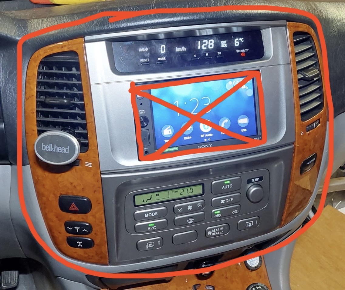

Hi everyone
I have a complete manual air condition control unit for sell for the Land Cruiser 100 Series Facelift (2002-2007), because i sold my rig and switched back to the touch screen unit due the new owner didnt want to pay me some extra for the rare conversion. If there is someone who would like to buy and install it in his rig, here you have the opportunitiy... includes air vents, LCD for the board computer, lower air condition control unit, and original upper radio (not the one on the pucture)
Wasnt hard to install. Jerryb helped me out (thanks again!)
im from switzerland europe and would ship it worldwide. Its also listed on ebay but i would give a discount on the ih8mud users. 850$ plus shipping
View attachment 3591549Hi everyone
i maybe interested. Do you still have it up for sale?
