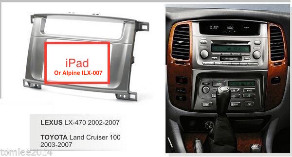

i'm about to jump into this topic as well to create a void above for a new touchscreen head unit install (either iPad mini or alpine ILX-007). this can be done, and the bezel exists on eBay to make it look 'OEM'. now, i'm just trying to find the clock assembly and the lower climate module and related parts/harnesses from salvages vehicles to keep costs down. anyone know where to look, other than www dot car dash part dot com??
Please let me know if you get those HVAC controls to work properly
absolutely. i plan to completely document the entire process with photos, parts required/part numbers, and costs.

Bezel w/ 2DIN Opening:
Double Din Car Raido Facia for LEXUS LX-470 TOYOTA Land Cruiser 100 2003-2007 | eBay
Car Radio Fascia Surround For TOYOTA Land Cruiser Lexus LX-470 1998-2007 | eBay
(35.00)
Alpine
(600.00)
with labor, i'm guessing bout $3000.00 for total project
