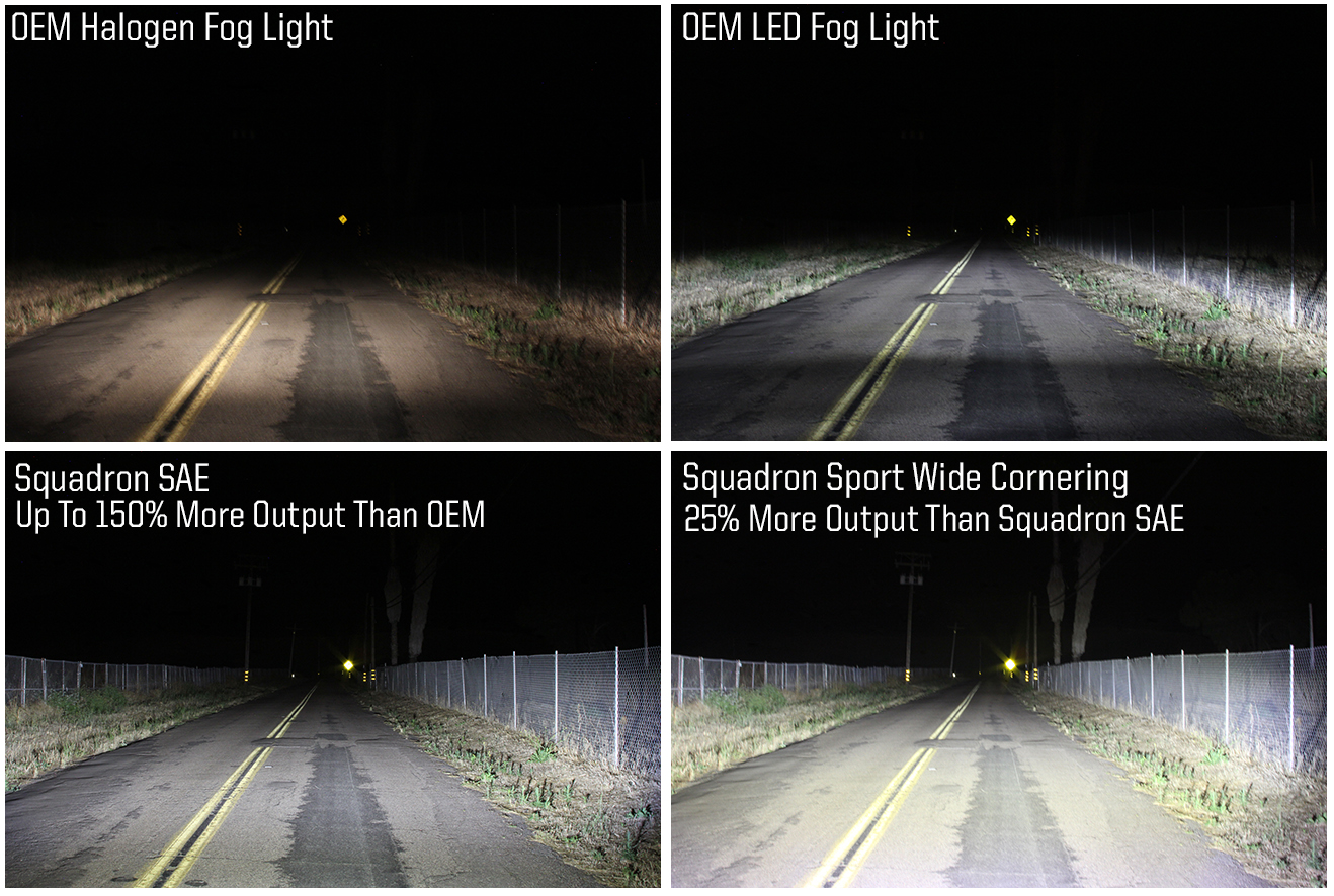

I installed some amber squadron sports with the combo lens last week on my 10’ 570 and they are still too bright for street use. Thinking about swapping them out for the SAE squadrons.
Damn. Funny that a product is far too good for street use. I found that the passenger side plastic cover came off much easier when I used a small screwdriver to push the top two tabs straight down.
Yup, regular squadron sports are too powerful for street use. I only turn mine on when there's no other traffic around.
I also have a pair of squadrons on my Tacoma. They are extremely bright. I ended up wiring in a Skene motorcycle dimmer. It has a programmable module that you can connect to a 3 way toggle switch (I added to the dash). I programmed the switch to 10% , 50% and 100%. The 10% position is perfect as DRL. 50% is great for fog and full blast offroad.

I got the SAE versions.
Niiice! I wonder if the SAE option is just a different cover/diffuser... Hmm
