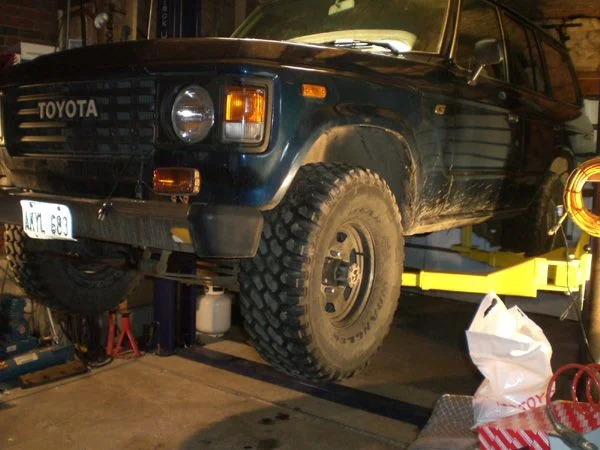

WOW that concrete glue is the shiznit!! I think I'm going to pull the studs that don't have it and glue them all in!! amazing strength. All the ones I put the glue on I easily got to 80 ft/lb I will definately use that glue again when I re-do the floor and re-mount the hoist!! Thanks again for the help guys!
Thanks guys!! it's working!

good work on getting that in, What did you end up doing on the top to stabilize?
