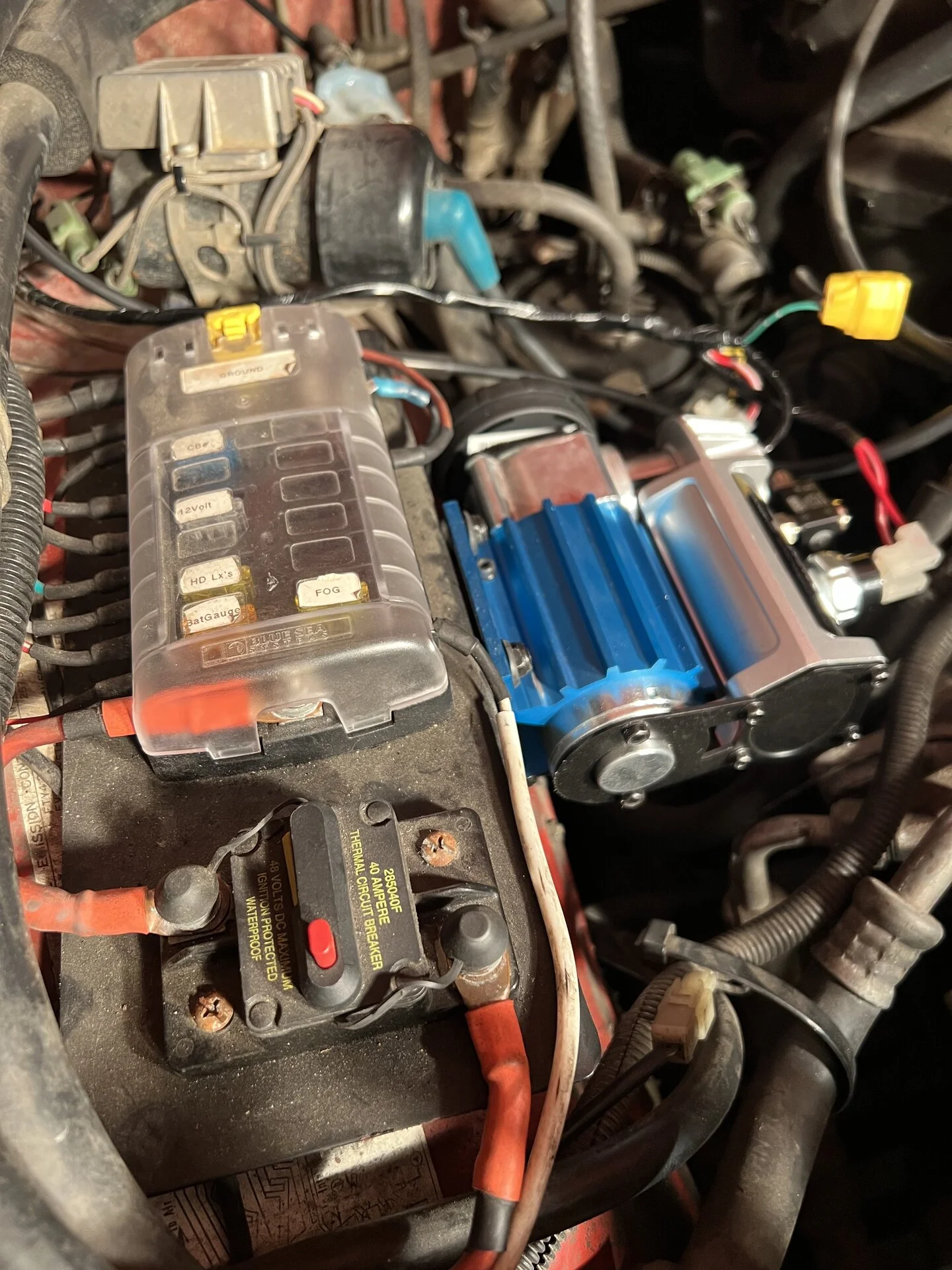

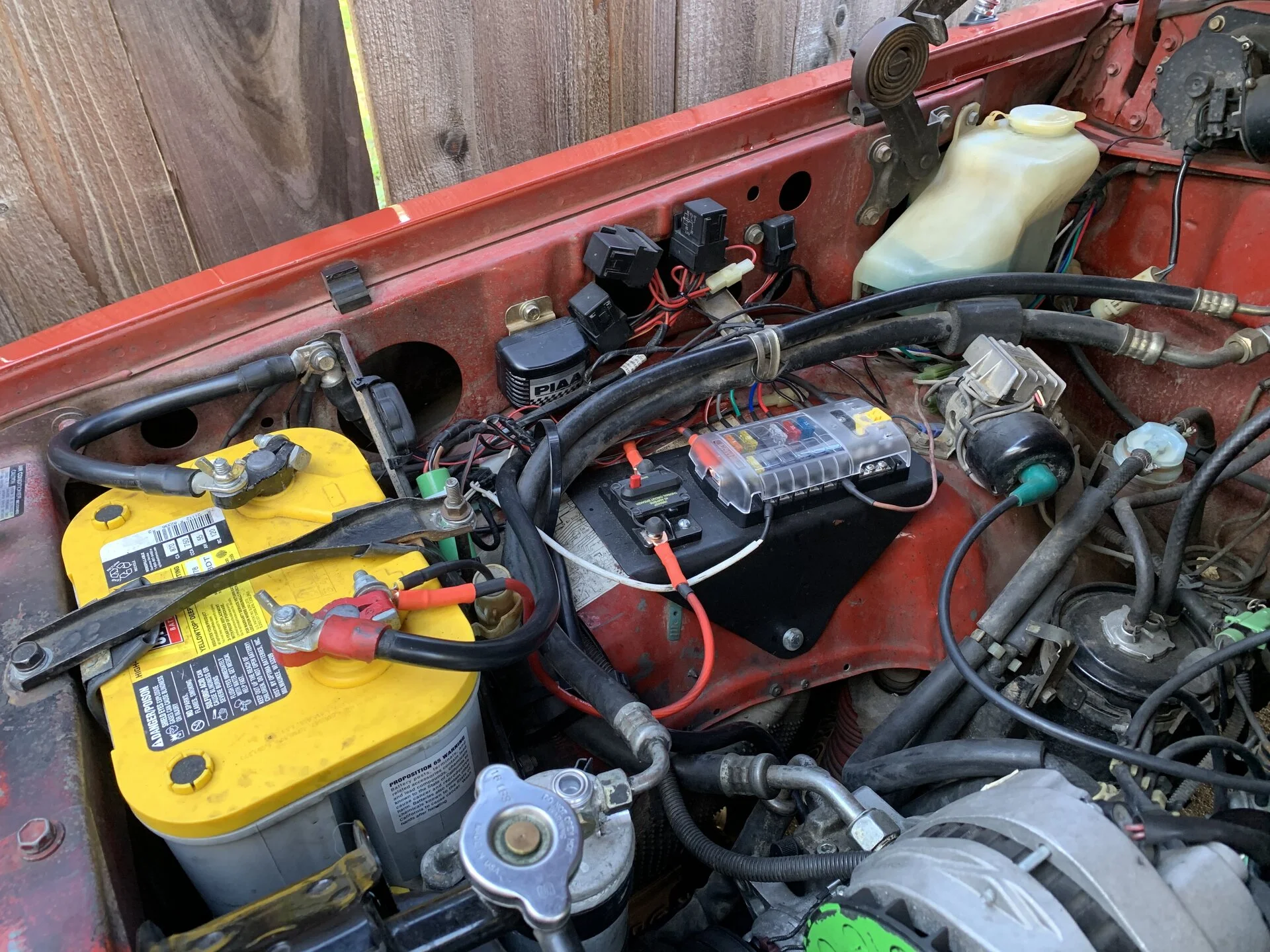

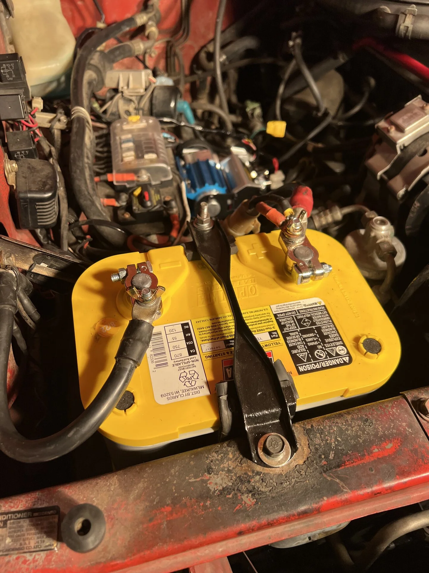

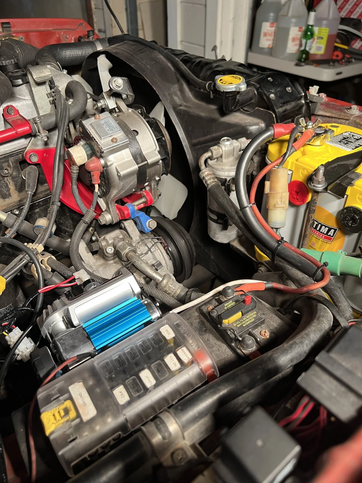

Working with @CardinalFJ60 to address compressor mounting for his ARB Twin. Just dropping a line in here in case anybody on this old thread still doesn't have a solution.
The goal is a bracket that uses factory threaded holes in the engine bay, keeps the compressor out of harm's way, and incidentally has some space to hold other things.
I'd love to see photos of what compressors folks are running now.

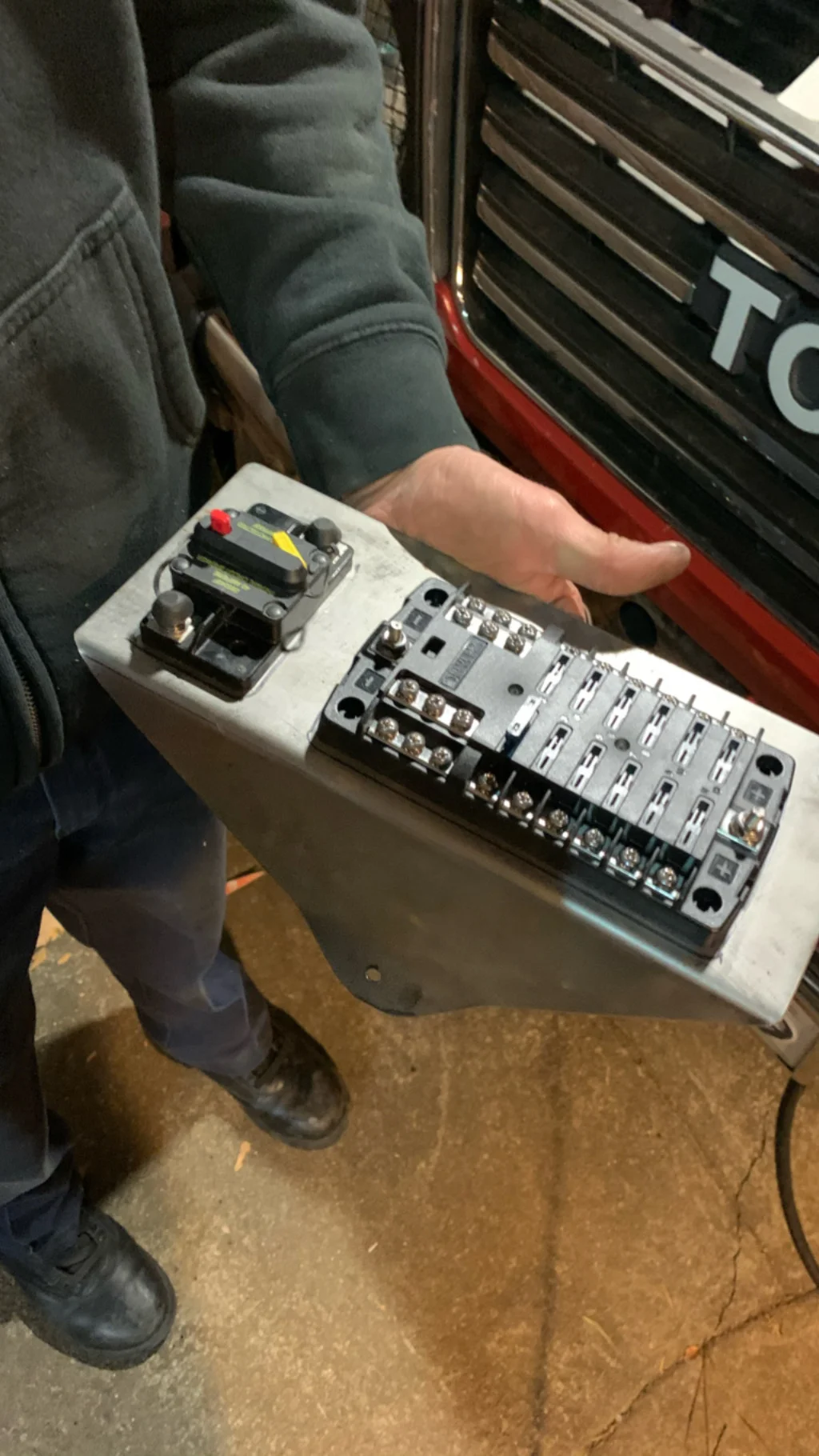

On a piece of bent sheet metal.
I didn’t tap any new holes. I used existing factory holes.
That's what I'm aiming for as well. Dead simple installation is the goal.
