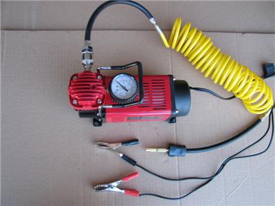

I currently have almost 39" tires on my 80 series.
Would a small compressor like the ones offered at Costco just spontaenously combust at the sight of my tires?
Seriously though...would one of those work for airing up on the trail, or would they not last long with my tires?
If the MV50 couldn't handle it, what compressor would you recommend?
just spring for the york kit and youll be a happy camper all around. you might be able to get away with an mv50 but I sure as hell wouldnt with the tire size your running. youd be there a long time and youd have to stop to let it cool off. If i were you id do the york.

YORK being the junk yard series. I bought my bracket when they first came out but i guess slee sells them now. basically you get the "kit" includes the welded bracket, pulley, and belt. go to your local junk yard pick up a york ac compressor i prefer the 210 with high displacment and your good to go. if you get the high displacment (search threads here on york) you can run air tools by simply raising your rpms with out an air tank. no over heating of compressors or drawing alot of power ect. Just look into york compressors on yahoo and youll see what im talking about. One mod and youll have endl less air.

For a 12v compressor, nothing comes close to the Oasis compressors. They use a winch motor to drive a York compressor.
http://www.oasismfg.com/p3.html
Next best is the Extreme Aire Magnum mentioned above. It can't match the output of the Oasis compressors, but it's a third the price.

have used the Costco model to fill my 35" tires up for about a year. To go from 20 PSI to 35 PSI it takes ~ 30-35 min. The thing also gets really hot! I think the 39" would probably kill it unless you honor it's duty cycle which means you would probably be waiting a long time. I just threw down for the 15 gal CO2 tank ($350 shipped) and its sooo much better. It took <4min to do the same fill. Just be sure you have a welding shop that actually fills tanks. Good luck!

My bro has used his for a couple of years on his 35"s, from 15-35 psi takes about 4min per tire, but he also uses two. We don't worry too much about air up races, after a trail run we usually stand around and BS for a half an hour or so anyway. If air up races are your thing get a CO2 tank.:D
