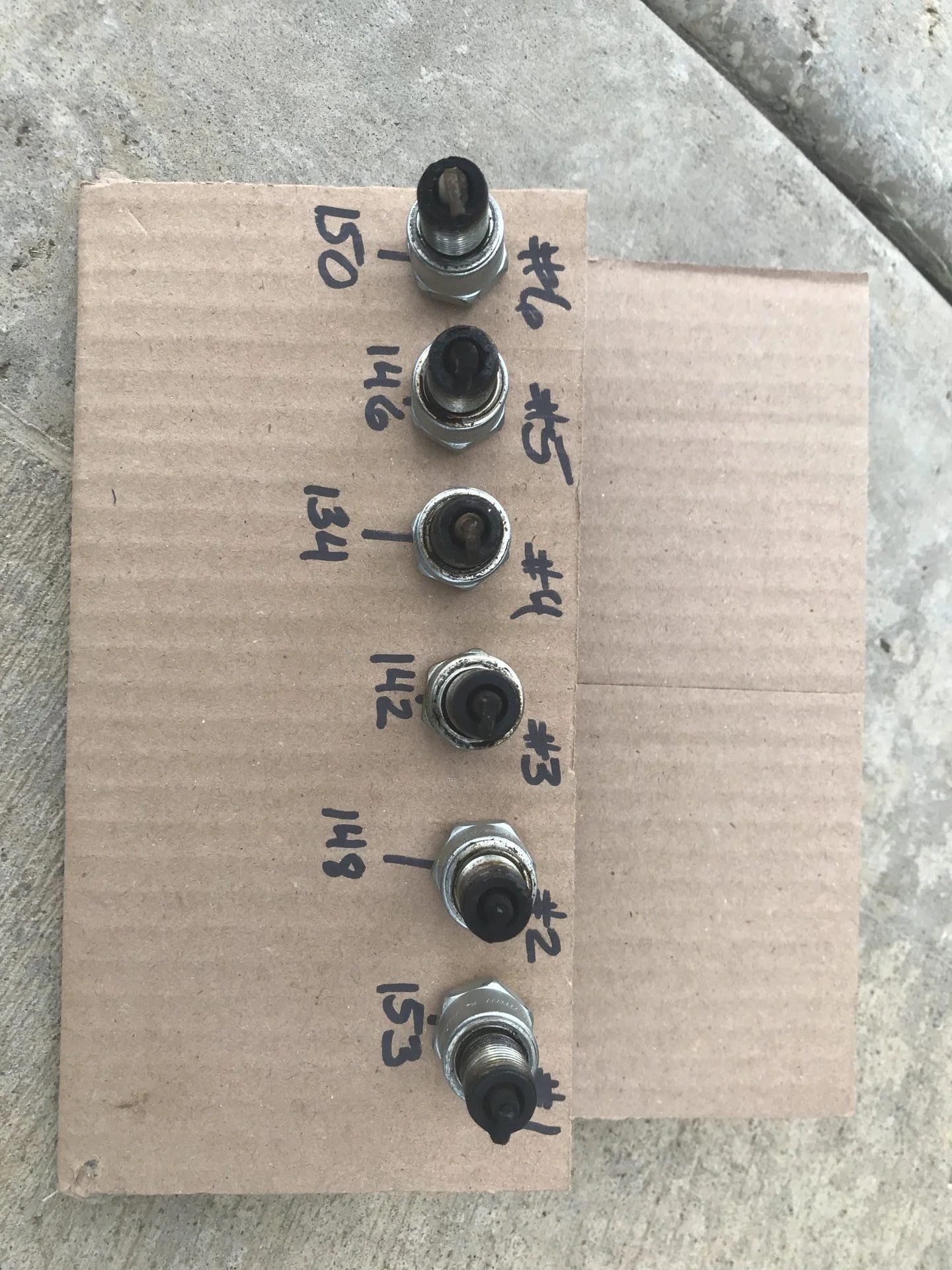

Did a warm compression test today. Here are results. Do they look ok?
Take a look at the plugs, anything look not normal?
Due to oily oil on most of the plugs, should I replace valve stem seals?
The white insulator on #6 looks like an intake leak. The whole set are getting oil, or burning rich. The compression numbers look good (ish).

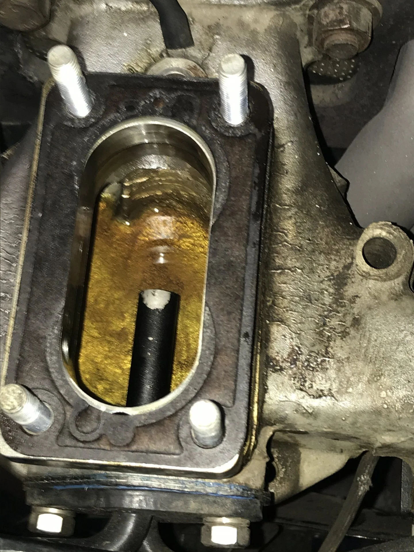

when I took the carb off the intake, I noticed 1/8” of fuel sitting in the bottom. Is that normal, since I’ve been messing with carb,
choke, and linkage?
puddle? only if the throttle linkage was cycled several times.
yeap those plugs look like the typical plug under a weber.
