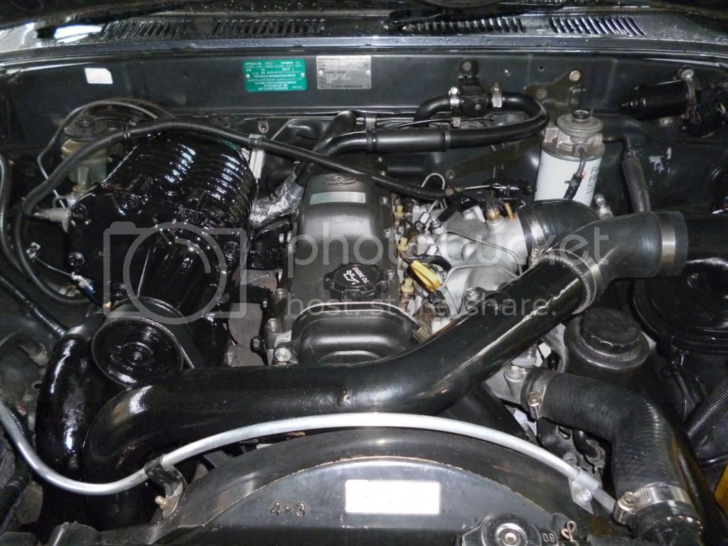

Around a year ago, I blew the standard turbo and had to use a larger one from a 1jz-gte vvti Chaser engine. This was quite laggy as you'd expect, but I continued to run it while I thought of what my next option would be. Curiosity got the better of me, I chose to run an Eaton M90 supercharger, compounded with the turbo. Overall it performed a lot better. It made 22psi at 1700rpm (turbo on its own wouldn't even get that high at 4000rpm). Had a massive torque curve right off idle too. Unfortunately, you could feel the extra drag on the motor from spinning up the supercharger. it made stuff all power compared to a standard one. After a while I had issues with mounts breaking and had to get rid of it.

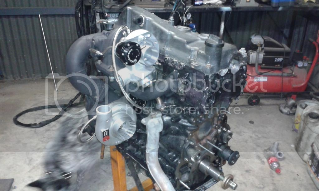

Not content with giving up, and knowing its potential. I wanted to do the same again, with 2 turbos. I had a td06 here from an old project, and bought another turbo to go with it and started building the setup on a 1KD-FTV engine I have been rebuilding. Anywho, enough talk. I'll put some pictures up.
Supercharger setup

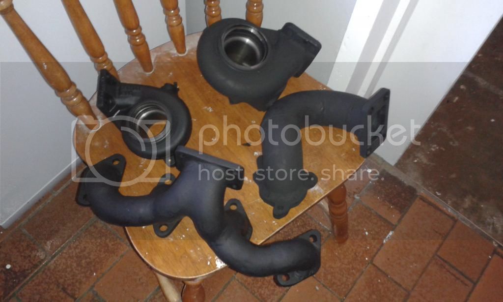

Exhaust parts made up and painted

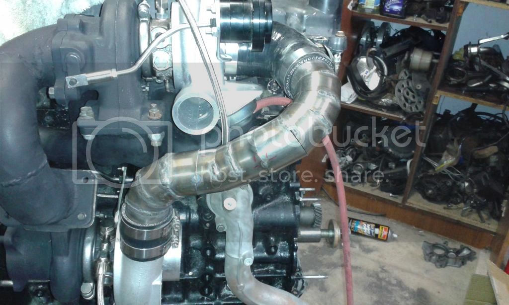

Intake pipework building (just bought a TIG, still getting the hang of it :P)

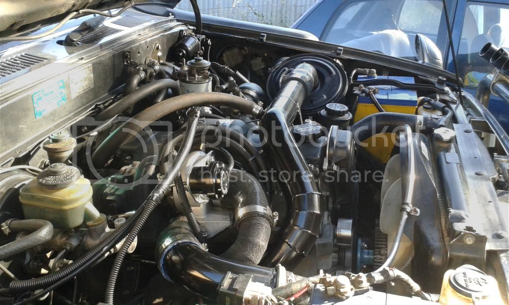

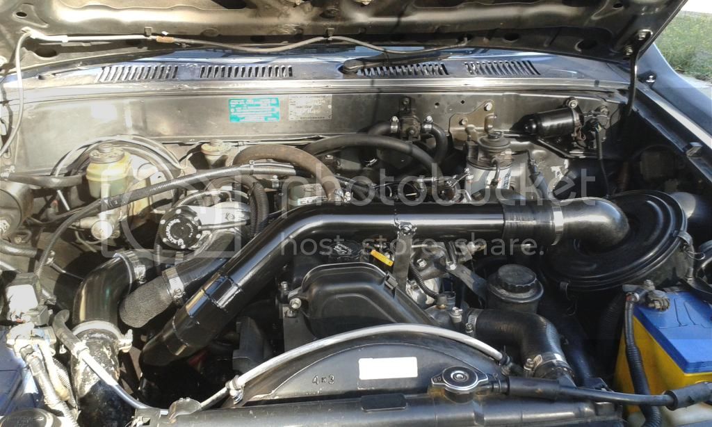

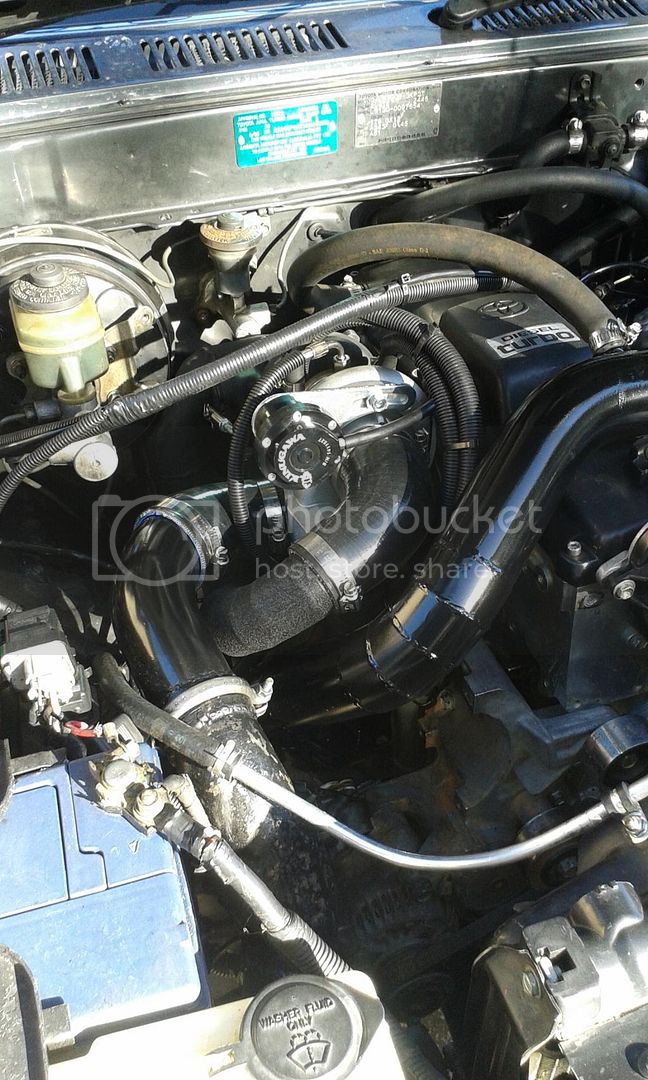

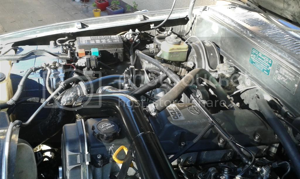

Spent the last 3 days getting it bolted up. I have it running and driven it a few times. I really need to get a second boost gauge, and make better pipework. Have issues with intercooler pipes when it gets to about 28psi. In the proccess of setting up the fuel system too. It seems to be a fine line in getting a decent ammount of fuel in without getting too carried away. When I get a chance I will get more pictures. It really performs very well now. The torque curve pretty much happens the same time as the original turbo, but a hell of a lot stronger.

Gerg- I have very little clearance on the brake booster and clutch master. Everything else has a fair bit of room. I will get some pictures today. The small turbo is a td04h-16t. The drain line is a braided line, and takes a fairly long curve around the td06
The 16t is a pretty generous compressor for your displacement and should give you good flow at high rpms. It's probably much bigger than you need, but it all depends on what your large turbo is boosting. Nice job nesting it in the engine bay. I don't know if you have already, but you might want to wrap all the exposed metal piping and housings, as I've melted wires a couple feet away from my set up due to all the heat shed from the increased surface area. Your Underhood temps can get extremely high, and you live in a hot area already.

Yeah. You will get a greater bennifit from swapping out the large. The nice thing is the small is easy to get lots of different parts to change its performance. Nice work. If you get a chance, shoot us some pics in the engine bay. I've never seen one in your truck before.
