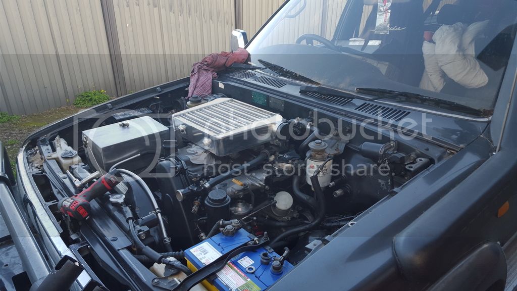

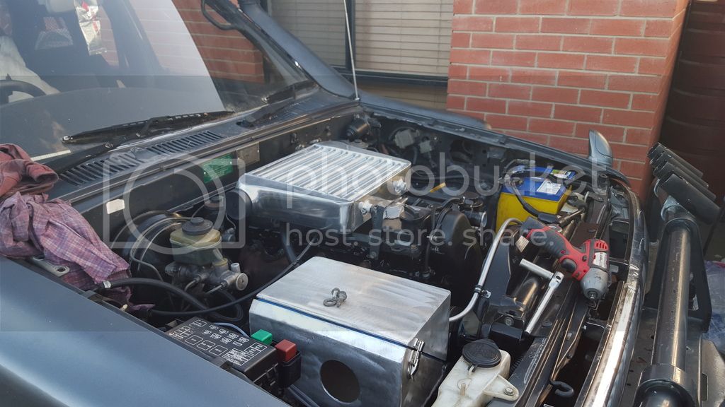

Okay, time for another update. Been pretty busy but managed to get some time to make some progress. got another 3 injectors, machined them and they are fitted. A mate of mine is going to help me machine up some spacers to use to clamp them in, and will use the standard forks so it should work well.
Other than that, Got the top mount nearly done, just need to do the cold side of the piping, cooling system is back together too. So once we do the injector stuff it should be ready to (hopefully) run.
Why yes. Yes I do. It's very close, just waiting on getting some adapters machined to fit to the injectors.
In the mean time, i decided to get it running as motivation, so i rigged up a concoction of backyard looking washers and washer hose, managed to get it running.
Had a few problems getting it going, but it turned out I'd put the cam disc in 180 degrees out in the injector pump. After fixing that it fired up straight away, sounds very smooth and quiet too. Couldn't run it for long as it didn't have a valve cover on and i wasn't keen on glazing bores either
