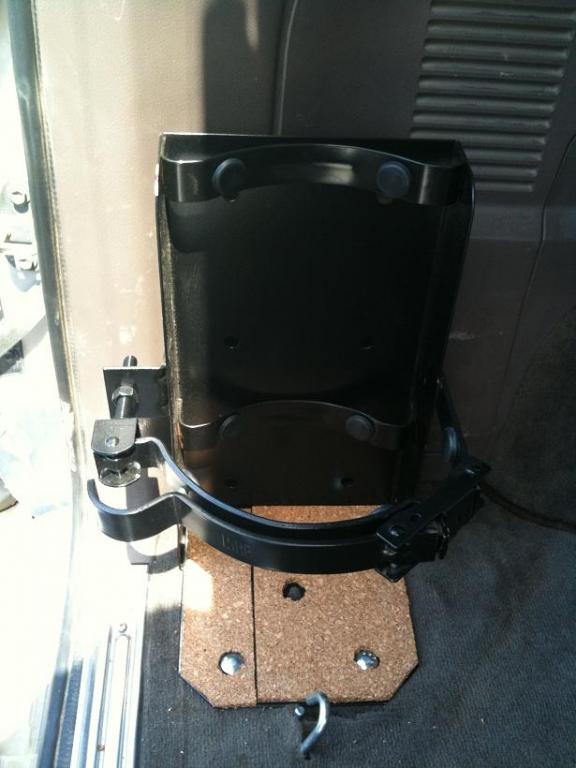

How is your CO2 bottle secured? A high speed whoop could send that into your roof and of course a roll could send it everywhere.
Here is how I secured mine. LINK

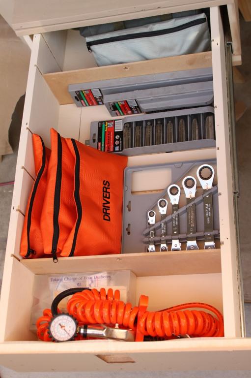

Drawer dividers could also be helpful to keep things from flopping around.
I thought about doing drawer dividers, but I first wanted to locate some pouches similar to what you're using. Poking around on Amazon, I found this set of color-coded Klein cordura bags:

As for the Co2 canister, it isn't secured at the moment. I merely put it in place to test fitment. Where did you get your mount? That's what I need to order up next.
Yup exactly a great $1 store find that is still holding up great! And had a guy who did embroidery in a flea market stitch them up for $8 I think?
As for the co2 bottle mount it came with my bottle from Ultimate air but I don't think the company is around anymore.
