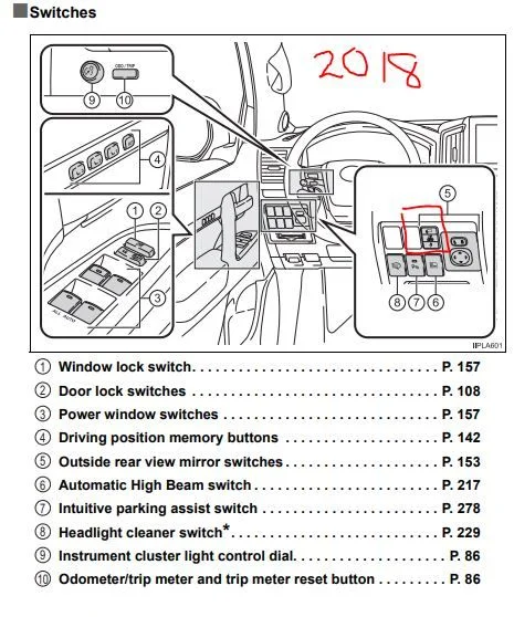

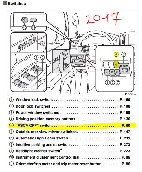

Located left of the steering wheel.

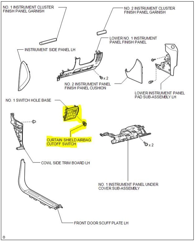

EDIT:
So it appears that on 2018+ the switch has been removed. I confirmed both in FSM and the Manual. Odd.
So I am not going crazy then? So is there even a switch then on the 2018? Just was confused, because it says there is on per the Window sticker.

EDIT:
Just as an update
Got an answer back from Toyota. They are saying its a typo on the Windows sticker, and that the 2018s no longer have the RSCA cut off switch. They claim it was due to some regulation by the government that they can no longer be cut off switches for airbags. Something about it came into effect around Sep 2017.
