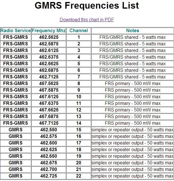

Cb radio is limited to 5w output max and is on a crappy frequency. Gmrs is on a crappy frequency but of you buy the license you can output 70w max ( or maybe 50?) . I've heard a lot of good things from other groups regard gmrs. Some groups are requiring them for trail runs.

For GMRS 50W is the limit on the upper channels, 5W on others, 0.5W on others yet... Like FRS, GMRS is at UHF frequencies it is very 'line of sight'; so not terrain friendly.
For a local CERT drill here recently (since they like FRS for their unlicensed members) I tested FRS from my house in Escondido near the Palomar hospital (or Stone Brewery if that's a better reference) to a guy about 2 miles away as the crow flies. For the test I was tried 5W, 10W and 50W into a roof mounted high gain base station antenna and the other guy had a similar antenna and radio. Neither of us could hear the other at all. We switched back to ham radio VHF 146.55 MHz (simplex, no repeaters) and could easily talk with one another. UHF just doesn't work well in hilly / mountainous terrain... It probably works great for desert trips without much in the way of terrain. As always YMMV...
And beware of FRS or GMRS users using radios with 'sub-channels' or 'extra channels' as they lead to immense confusion...
The 'extra' channels such as employed by Midland, or 'sub-channels' (ie channel 3A) are based on the addition of a sub-audible tone squelch (aka 'PL' or 'CTCSS' tone) that blocks the receiver from hearing others on the same channel unless they are transmitting the right tone. This becomes a problem when users of different brands of GMRS or FRS radios try to work together and someone either intentionally or inadvertently has a sub-channel tone active on their radio and the others do not.
To me the main selling points for GMRS are:
1) It is 'channelized' meaning you don't need to think about agreeing to or setting a specific 'frequency' to talk on, just pick a 'channel' and go;
2) You can simply purchase a license from the FCC for $70, so no need to study for a ham technician class license test which now costs $35, both licenses are good for 10 years. Even then I'd reckon very few GMRS users really have a license and the likelihood of ever being caught is about as close to nil as one can get... and honestly the same could be said for a ham license really...
3) On GMRS (unlike ham radio) you are not required to identify yourself with your FCC assigned callsign when talking (not that anyone much bothers with it anyway when off road...); only when near population is anyone likely to hear you and question what your callsign is...
