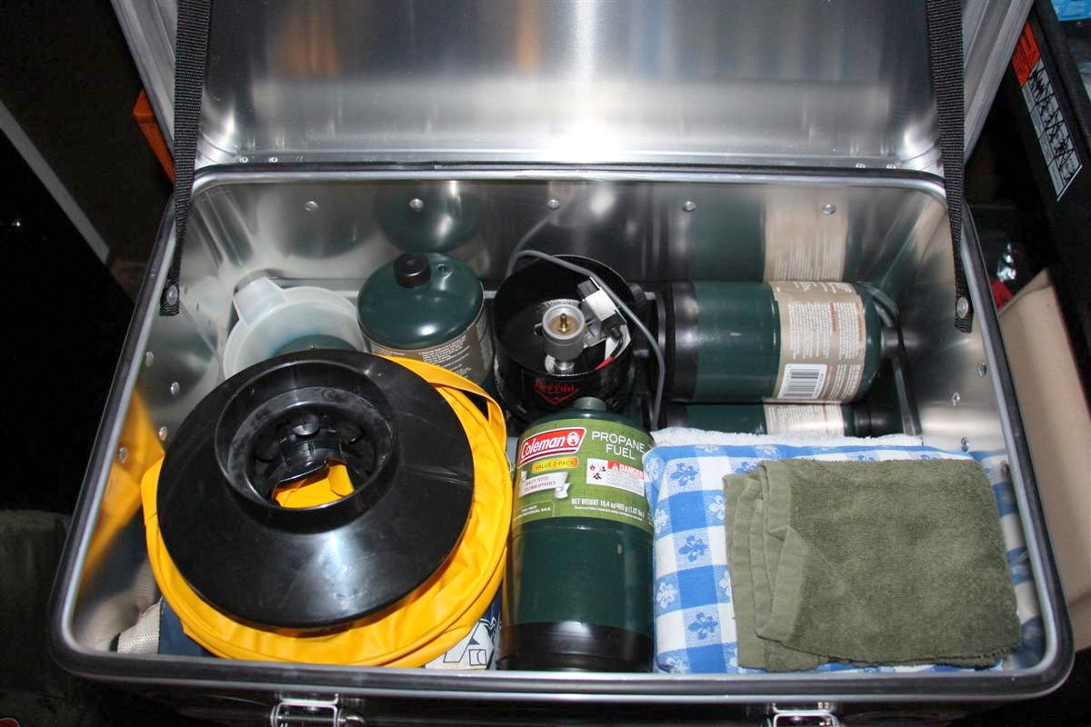

When I put it away from my last outing in the summer it was OK, but after transferring my gear from my ECS case to my new Alubox 73 liter, I noticed one of the mantles has a hole in it.

FYI I wouldn't store your propane with anything you don't want to replace. We had a bottle leak in our picnic bin, the ororizer ruined everything including the bin. It is impossible to get the stench out.
Thanks, if they did ever leak, it is mainly just towels in there.
Been carrying the bottles like that with towels, a lantern, and a few other misc. things for 30 years without one leaking on me.

We carried them the same way for years too. I'm in the habit of checking the main valve before I put a bottle away now.

Oh, if you mean leaving a tank hooked up to the lantern, then no.
I always unscrew the small tank from the lantern when it gets put away.

They can still leak, but it's only happened to me once. And it's one I probably refilled one too many times...

No, the tanks can leak, even new ones. Sometimes the valve doesn't re-seat when you remove the stove or whatever. They are a variation on the Schrader valve so if anything gets on the rubber sealing surface or the stem gets cocked they will not seal completely. I carried them in sealed rubbermaid containers for years with no problem, but there was that one time and we had to trash everything. It's worth a few seconds to check the bottle before you stow it.
I will have to keep an eye on the tanks then.

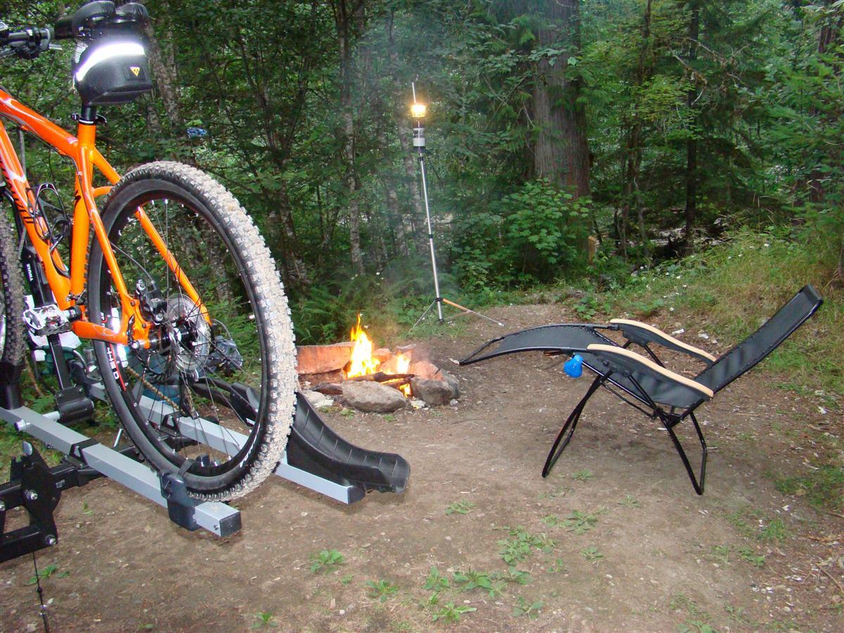

Well this is embarrassing...
I went through my mantles today and found out I had four of the #21 clip on ones.
So I took off the old mantles, then when I went to put these on, I started scratching my head.
This is the same lantern I have.
Sears & Roebuck Hillary Legend Propane Lantern Model 201.72787 - Century Primus | eBay
The gas tubes come out of the bottom, and not the top like most lanterns.
I did find another pack of mantles with one mantles left, and it is a Coleman #51 bellows.
But I did get the lantern to work with the #21s, but not sure if I trust it, but I ran it for a good five minutes after first lighting them with a lighter to burn to ash.
And this old Sears lantern I have is actually built by Primus I think.

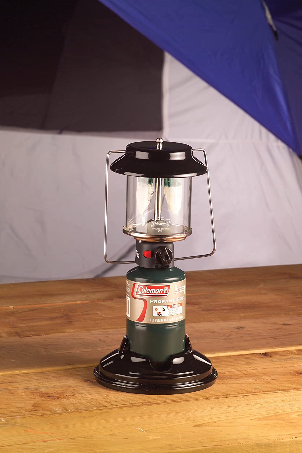

I did order a brand new lantern though just to have a second one.
Got this one from Amazon.
Coleman Two Mantle InstaStart QuickPack Lantern
It uses the standard #21 mantles.
I had forgotten that the old lantern used these funny #51 bellows type mantles.
Never hurts to have a spare lantern on hand.
From reading the reviews though, you first turn on the gas, then push the ignition button.
Some say it can take several tries, and you all know what happens when gas builds up, KABOOM!
One thing I like about my old one is the igniter clicks when you open the valve for the gas.
It opens it full blast, then you back off to dim it is you want.
Too bad the Colemans are not built with this old school ignition.
