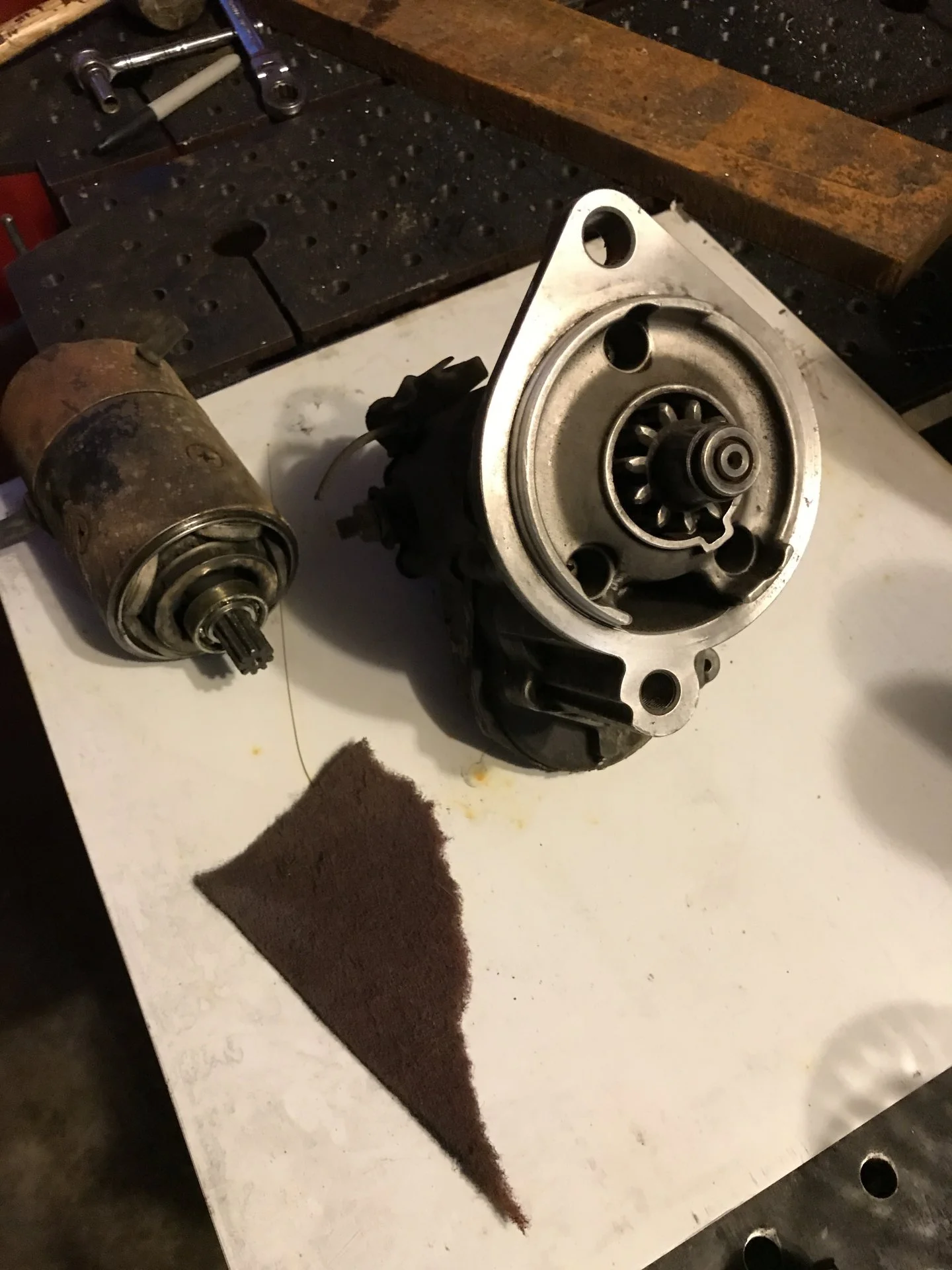

-10 and I do 3 glow cycles on my BJ60. They are only 3 second glow cycles. Starts up fine with no accelerator. Although I have brand new Interstate batteries. My cranking speed is insanely slow. I might have to address my grounds???
The big thing i found is to scrub the corrosion from the mating surfaces between the bellhousing, nose cone and the nose cone to steel starter motor housing as it grounds threw the body of the starter to the aluminum nose cone and on to the bellhousing. When it’s corroded between the aluminum and steel it causes the starter to run slow or not turn at all. A aluminum oxide purple scrubby works well.
