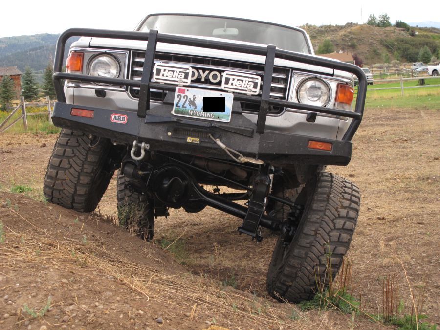

My 60 flexed awesome, even being SuA. Sooooo smooth down the HWY. 75mph in 4wd and it was a two finger deal on the steering wheel. I can say that it damn near handled better than my new 100-series. And almost as good as my 80 once I had dialed in the 80's suspension & steering. Great thing about leaves, they are predictable and easy to dial in but of course they do make a truck ride like a truck.
